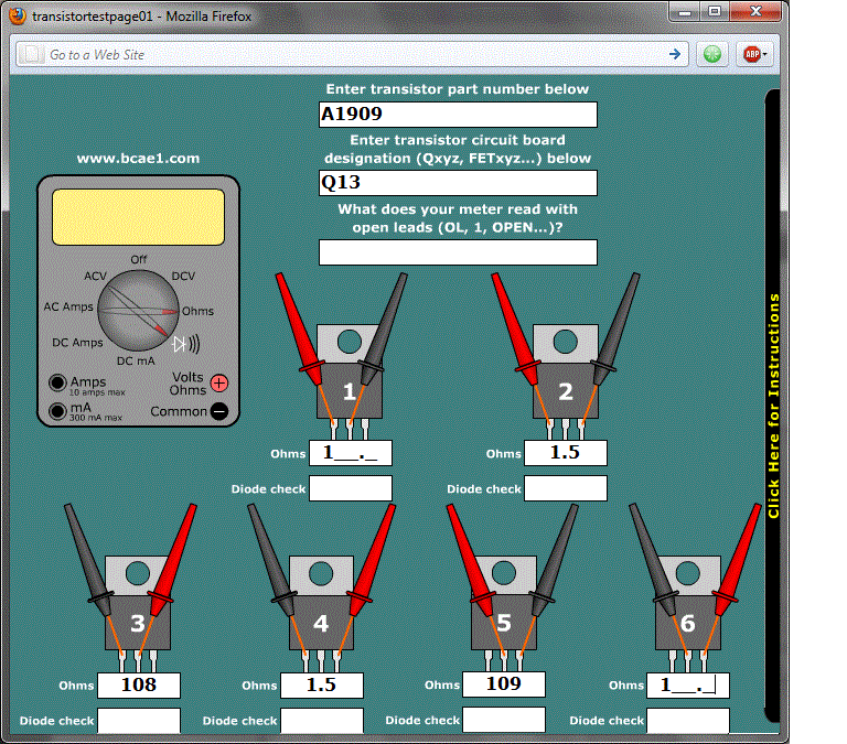

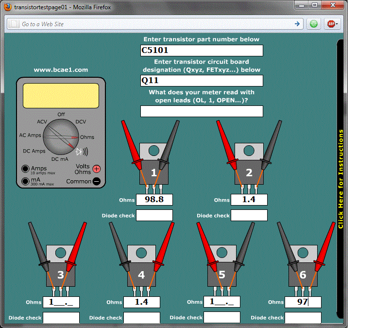

My readings "should not read anything near 0 ohms between the legs of any individual transistor"?
Do this for all output transistors?

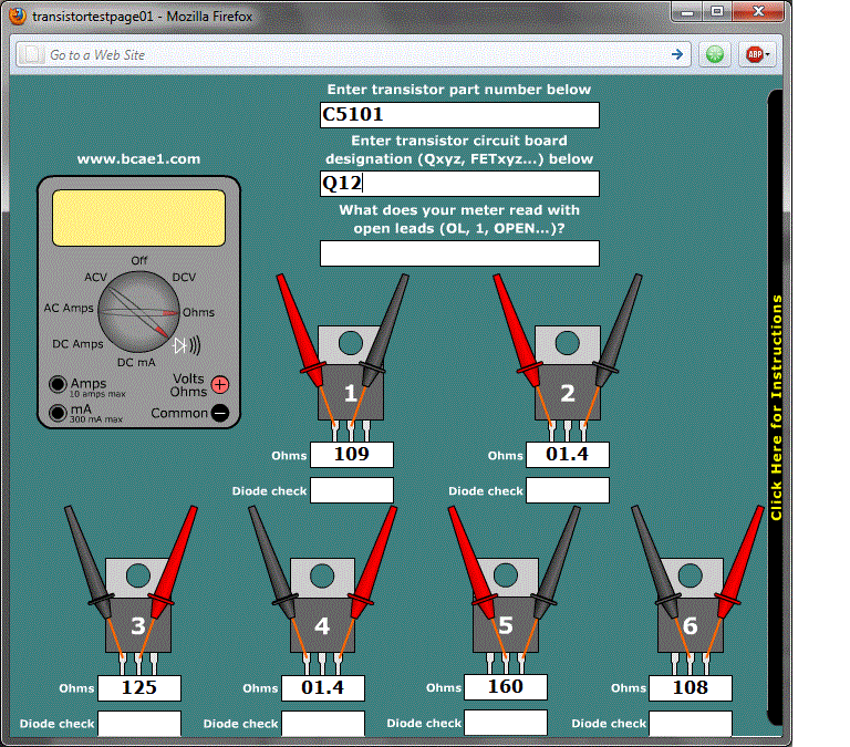

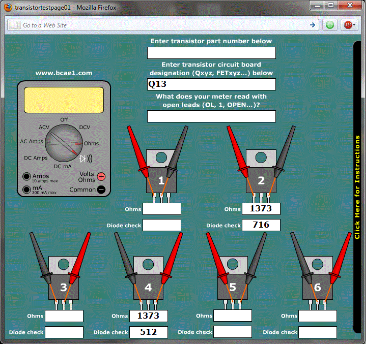

Well here is what found doing the ohms tests on all 4 of the output transistors. I had the meter set to 200k on the ohm setting.
The readings that I put 1__._ they are the same as no connection; probes not touching anything or themselves!
None appear shorted but that's a bit of a guess since you didn't include the units. I'm assuming that all are k ohms. If you would have filled in the other blanks with the meter set to diode check, it would be more definitive.
I have no idea how to do diode. And yes the setting was always on 200k...

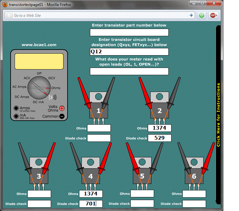

For the tests that produced the 1.4 and 1.5 readings, go back and repeat those tests with the meter set to 2000 ohms and with the meter set to diode check.
Those seem OK. The problem is likely elsewhere. reinstall it and confirm that you have proper voltage at the power terminals of the amp.
