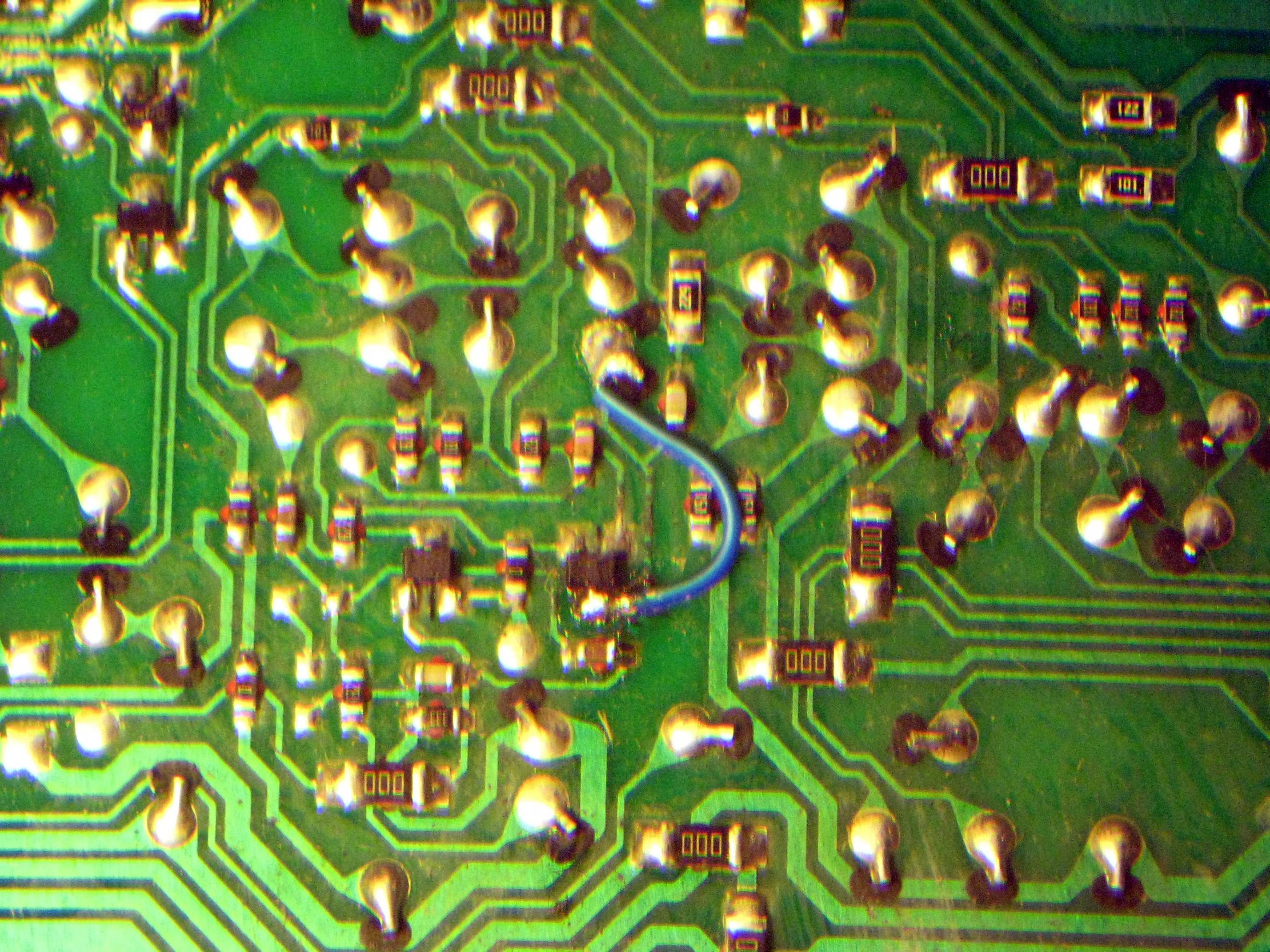

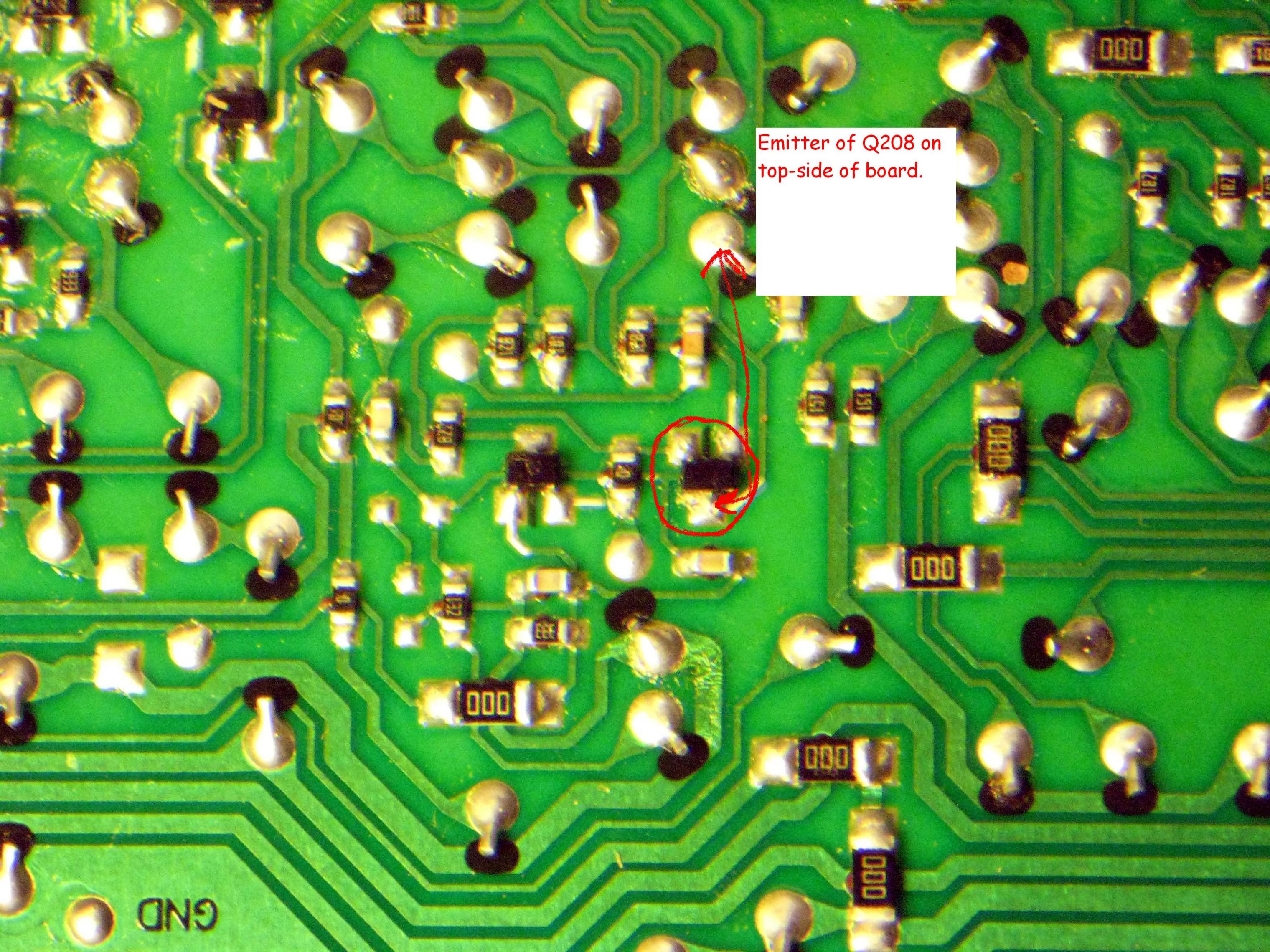

The transistor junctions checked out ok so I went to the solderside and followed where the emitter trace went to. The components on the solderside of the board do not have locations marked like the top-side components but I found a open trace coming from Q208 to a SMD transistor. The actual open or break in the trace was right off the pad of the SMD transistor. See photos, one is of the smd transistor and one is after a jumper was added to repair the open trace.
