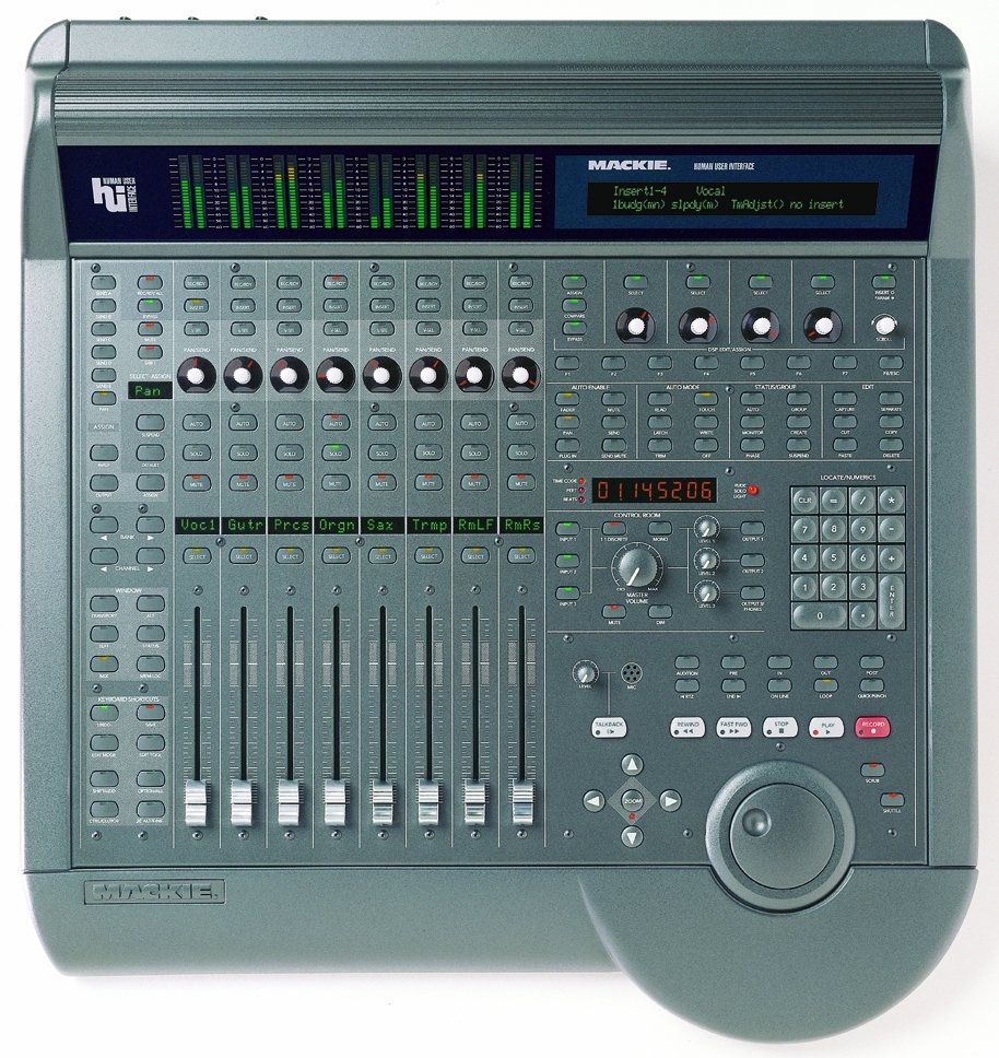

By the way I noticed something annoying : I intend to use that amp to drive speakers to provide me an alternative monitor for my home studio. My main monitors are Dynaudio BM6A active studio monitors. When I switch the amp on, I hear a "pop" in the Dynaudios. The pop is loud and has lots of treble in it, just like a perfectly square impulse. I guess it's the sudden current peak the amp draws when it switches on that causes the mains to sag fastly.
The monitors are both fed by the monitoring section of my Mackie HUI remote. The phenomenon is much more dramatic when the Mackie is on : when only the Dynaudios are on the "pop" is much quieter. When I plug headphones to the Mackie to hear it contribution to the "pop", it is also present but quiet.
Are there any ways to get rid of that problem ? It also occurs when I switch light on/off, but there it's much quieter than with the amp. Is it possible to add some filtering to the mains, with big 350V filter caps or big inductors like in guitar tube amps ?
I run the Mackie HUI through a 230 to 115VAC trafo, I don't know wether that can have an influence (it's an american 110V model). The trafo is a Hammond 175B-NA auto transformer.
To give you an idea of the gear involved :
http://cachepe.zzounds.com/media/quality,85/HUITop9-17-1b07e8b60f3c56e05498eb432c359156.jpg
http://www.prodj.com.ua/images/img2_id/20100624124317.jpg
Hammond Mfg. - "AUTO" Plug In - Step Down - Line Transformers - (175 Series) (input plug changed to EU)

You may want to check that the relay circuit is working. There should be a delay on powerup of a few seconds. If the relay immediately engages, there's a problem.
You could also be hearing the spark across the power switch contacts - the schematic suggests there is no "snubber" capacitor across the power switch S1. Solder a 47nF-100nF 275V X2 rated (the X2 rating is important!) across S1 and it should help. If you are looking for a cheap source for one of those, pull apart a dead PC power supply 🙂
As jaycee says really...
check that the relay takes a few seconds to pull in when mains is switched on.
Light switches (anything switching) can cause interference in a couple of ways. It can be a burst of RF energy that is picked up and "demodulated" by the input stages of the amp, or it can generate a pulse of interference in any nearby wiring.
Maybe try the amp in isolation with only speakers and nothing else connected to begin with.
I think my post wasn't really clear. When I switch the Kenwood amp on with speakers, the switching is totally silent, that is to say the relay is playing its role correctly.
The amp is in the same room as my Dynaudio BM6A studio monitors. When I switch the Kenwood on while the Dynaudio are already on, I hear that loud "pop" in the Dynaudio. So nothing wrong with the amp itself, but there might be something wrong in the mains cabling of my flat, that "transforms" the sudden current draw of the amp switching on to a "pop" in my Dynaudio !
Could also be that the mains input ibn the Dynauio isn't filtered/isolated correctly...
