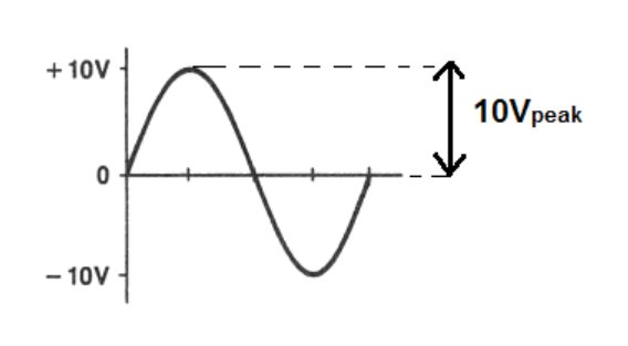

Your math is a bit off---18 volts peak relative to 0dbv (1 volt RMS) is indeed 25.1 db, but relative to 0dbu (1.23 volts RMS, 1 mwatt into 600 ohms), it is 23.3 db.On the whole I share your point, it’s always better to have a higher signal in line-level circuits to be much higher above the noise floor, whereas we in no way can allow clipping. In case of an opamp buffer its output signal voltage is limited only with the total supply voltage (+ and -). In my case it is 18V what means 25.1 dBV or 27.3 dBu and that’s the headroom relative to 1V RMS = 0 dBV. Even considering microshort peak spikes in musical signal it is more than enough. We should remember that dBV is a common use for consumer gear (unbalanced), whereas dBu is used for studio gear (normally balanced). The level difference between dBV level and dBu level is 2.2 dB. As a common standard the maximum undistorted line level of audio gear might be +18 dBu in Europe and +24 dBu in USA. +/- 17 rails give us 34V sweep or 30.6 dBV or 32.85dBu. Correct me if I'm wrong but it’s not clear to me why you determined that 80 dB S/N ratio just needs +/- 17V and why it gives 24 db of headroom (?). My guess is you’ve got 24 dB value taking into consideration only one 17V rail i.e. the half of a total supply. That’s not correct I presume.
But, in any case, you are confusing peak-to-peak voltage with peak voltage. Audio has to swing both ways, so to speak. You must also allow for the dropout voltage of the amplifier. +/- 9 volt rails will allow for a peak voltage swing of ~ 7.5 volts in most op amps (No specification for this provided by Burson). This will give +17.5 db of peak headroom over a 1 volt signal. Even a rail-to-rail opamp (OPA1612 bipolar or OPA1642 FET) will only swing to within about a half volt of the supply voltage, giving an additional 1 db of headroom. In my case (with LM4562 op amps), they will swing to within 1 volt of the rail (maximum 17 volts); hence 16 volts peak= +24 db of headroom.
The signal-to-noise ratio is only relative to supply rails if you consider it a must to have 24 db of headroom above the nominal value (which I do). My LM4562-equipped phono preamp puts out 1 volt RMS from the nominal 3.5 mv at 1.35K source impedance of my Shure V-15 cartridge (~49db of gain). This leaves me with noise at ~ -77 dbv. Not quite 80, but close.

Of course we are listening to peak-to-peak waveforms. It's just assumed that the negative portion of the waveform is supplied by the negative portion of the supply. A 16 volt peak signal in audio requires a +/- 17 volt supply---16 volts for the peak and 1 volt for the dropout---both on the positive and negative sides. Your +/-9 volt supply will swing to +/- 9 volts minus the dropout voltage. Assuming 1 volt of dropout, this leaves 8 volts, or +18db of headroom over 1 volt RMS. Or, + AND - 18 db, if that's the way you want to see it. That's insufficient. 6 db insufficient.
dotneck335, I should apologize to you. It was a kind of “brain eclipse”. Nobody is proof against that. You are right concerning output level relative to +/- supply voltage. In the light of this it still remains a mystery why Japanese engineers decided to lower supply from +/-14V to +/-9V in this circuitry. On the other hand the line input sensitivity for this amplifier (per service manual) is 150mV, ie -16.48dB.
No problem; I've had a few brain farts of my own! I still think you ought to make the most of those Bursons and turn your 317/337 supply up to at least +/-17 volts.
