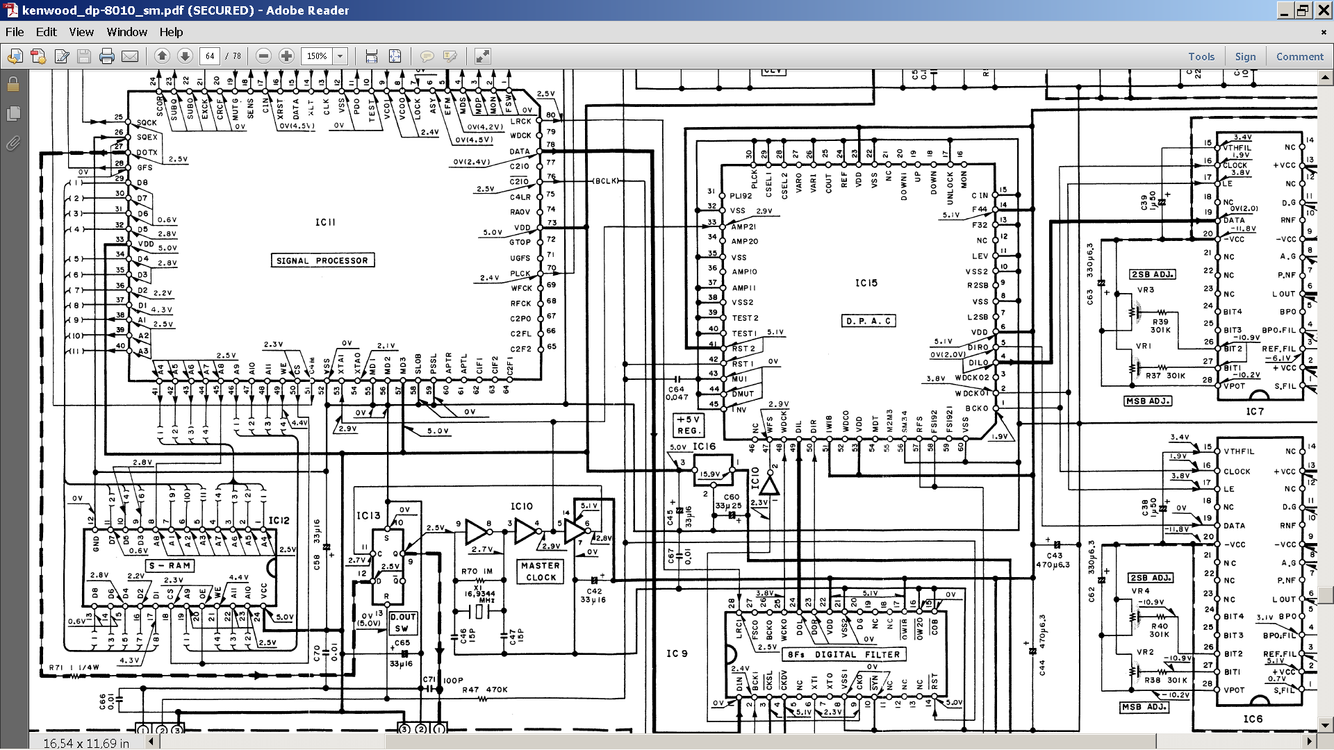

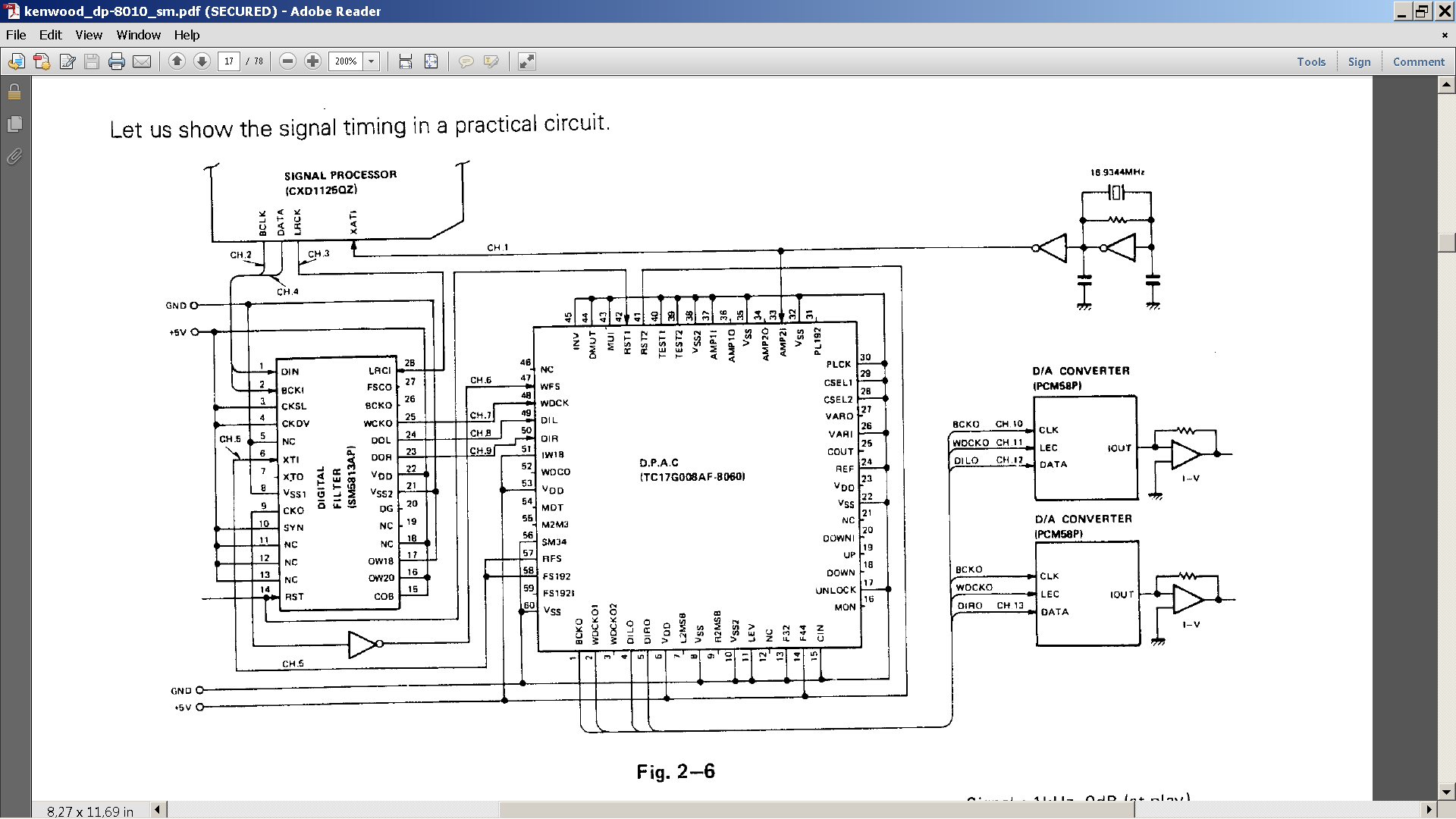

Hi
I am warming up this thread because I bought another 8010 which is working.
As I wrote this player is extremely well designed and built, only the parts are not highend.
I have changed the caps in cricial places for Oscon SEPC, reworked audio path, omited a few opamps (yes🙂) added OPA2604, some Fine Gold caps in audio section and...
the sound is amazing.
I think that nothing more could be improve for now (I think about BIG improvements) but reworking it to non os mode.
and this is my question:
does anybody know how to do this?
Thank you in advance for any suggestions.
