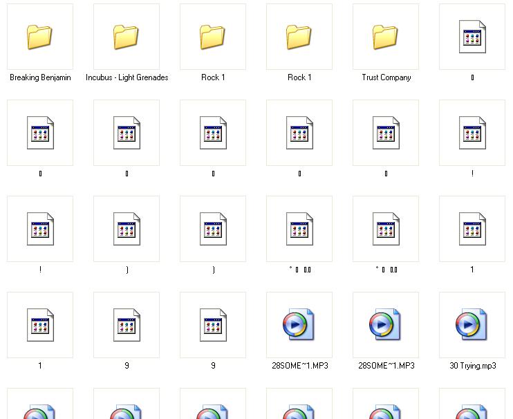

My folders have songs in them...Just kind of weird...It'll play them individually. Like I have 67 music files on there and they are numbered 01-67 and it will play each and every one of them. If I add a folder in, it'll play that folder. I tried adding 2 more folders today and it won't read it. It's like it's not on there or something. A friend of mine here at work showed me what the meaning is of the playing order they showed in the manual. I'm guessing that's why it wouldn't play it. I added a attachment of the playing order it says to use. From what he said it means that you have to make like a main folder saying "Rock 1" or something and then you can add all your seperate folders of artist/album names/ and so on in there. Does this look like it's what it's talking about?
Ok..Just really quick...Just tried to do it the way it is shown and I ended up with the same problem I had before. I'm getting a bunch of files with different letters and symbols and it tries to duplicate folders and stuff like that. Is my flash drive corrupted? It won't delete those symbols or files...Says "Cannot delete file: Cannot read from the source file or disk" Any ideas why it's doing this? Here is a attachment...
I can't tell by looking what type of files the middle ones are. If I want to delete everything I just insert the drive without the kenwood program on and right click and delete the ones I don't need after the window pops up and asks what I want to do. I also click "view files" I think.
