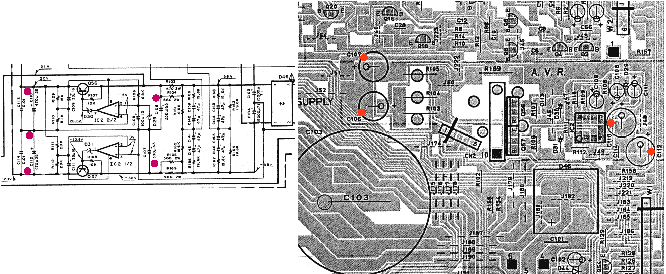

I acquired one of these monster 90's amps recently for restoration. Top of the Kenwood line in 1990/91. Dual transformers, massive 15,000uF Elna capacitors, all good stuff. This one was caked in dust and while it sort of functioned it sounded like a worn out amp. I've restored it by cleaning it thoroughly and re-capping it throughout (many of them were failing badly), but i'm now having trouble resuscitating it!
Tracing the audio signal through the circuit(s) (with my equally ancient Kenwood oscilloscope!) it gets as far as the front panel PCB, enters a pair of op amps connected with the loudness circuit but doesn't emerge. Bypassing this circuit with 'source direct' gets it to the little volume control daughter board, but again, it goes into the associated volume control op amps but doesn't come out. All the circuits/op amps seem to be correctly powered, the main power amp DC offset and bias are all ok, and it's possible to get some very nice sound out of it (albeit very quiet) by bypassing the volume control with the audio signal that's made it this far - so the power amp seems ok.
Weirdly, when you really crank up the input signal the sound 'breaks through' (even with the volume right down), albeit very rough?!

Thanks for the thoughts so far. I measured the voltage on the op amps across pins 4 and 8 (is that correct?) and got 28.2v...which seems a little high (according to the schematic it should be 20v)... Incidentally the op amps are NJM4565D's and NJM5532's.

That's actually a little low.
OP, please measure both pin 4 and pin 8 voltage relative to chassis ground, separately. Also verify continuity between chassis ground and ground on the volume control PCB (pick from pin 3 = GND on CN7, pin 5 + 6 on the input connector, R121-124 etc.).
Did any board-to-board connections have to be undone during the recapping? The screwup may be hiding there.

Thanks for the input which has been very helpful. Thought i'd post that the problem is cured (in case anyone else in future might be searching for fixes).
Turns out there's a moderately complex power supply on the main board which supplies the front panel PCB and the volume control PCB. This was behaving very strangely with +37 volts on one rail and 0.9 on the other(?!). I checked all the capacitors in this circuit and replaced C111 (33uf)...but only because I dropped it on the floor and couldn't find it. Also did a small repair on the PCB (the pad on C107 was broken), and it worked. Voltages swung back to +20v and -20v and all is well.
