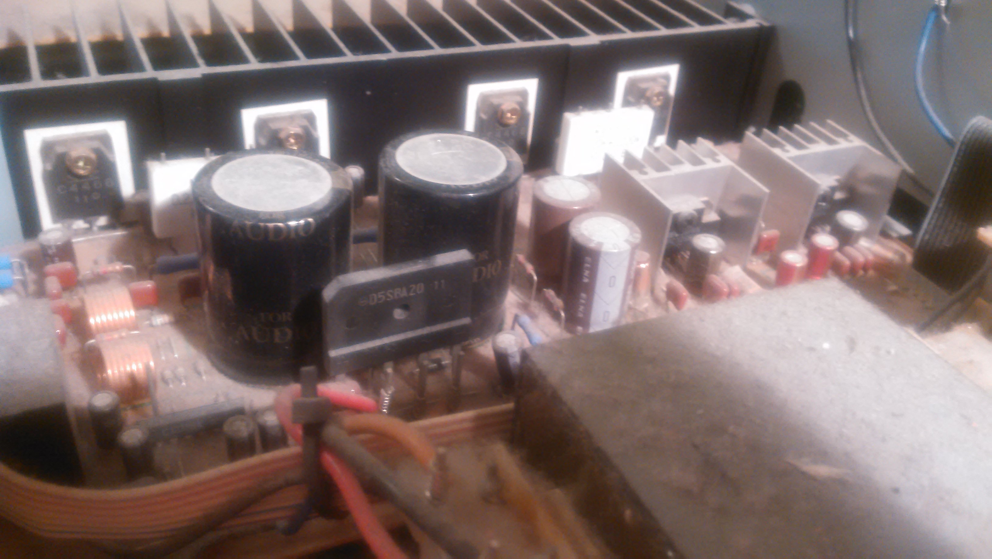

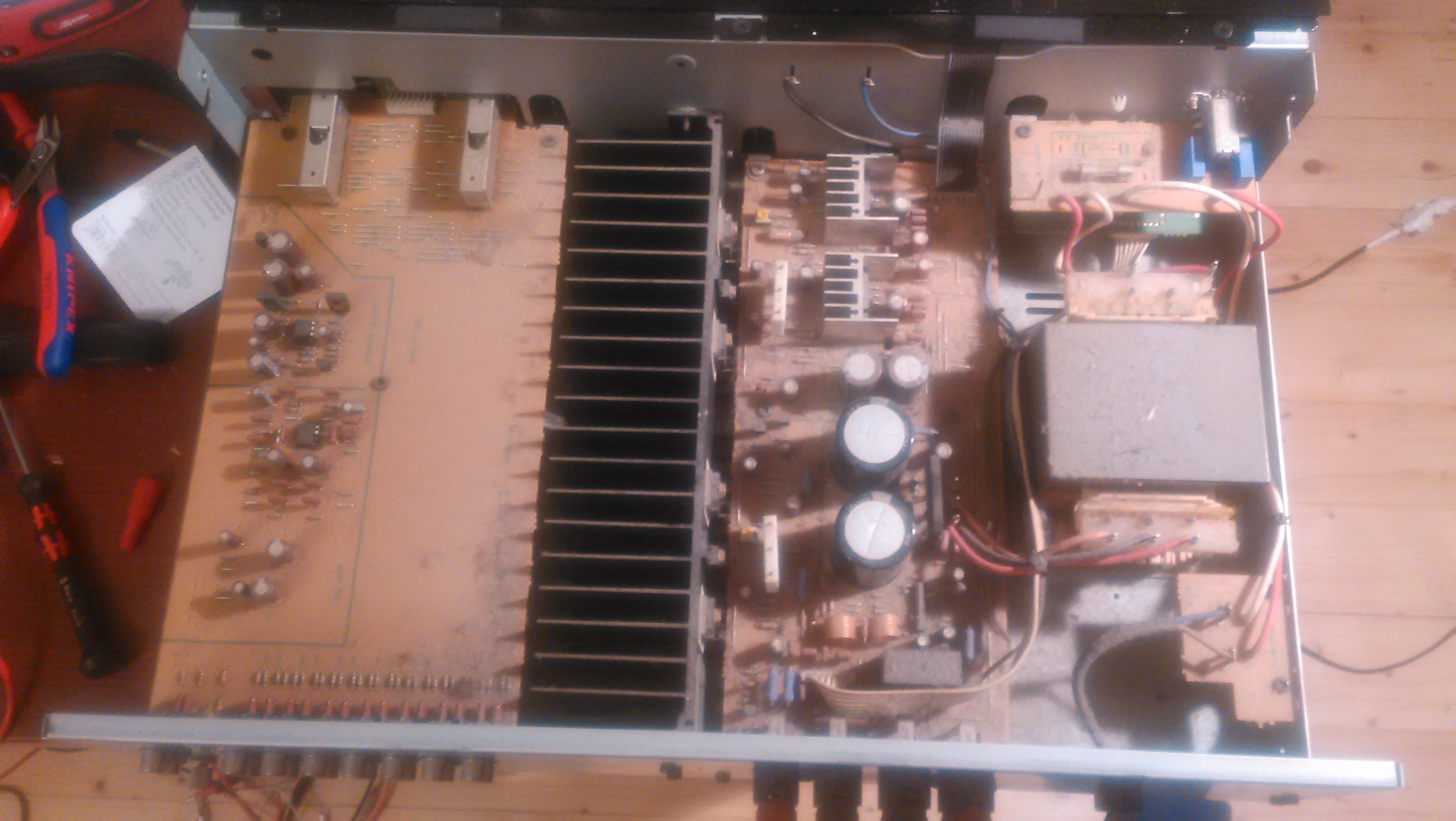

I'm currently having a problem with my Kennwood KA-3020 Amplifier. The sound is very silent even if I turn it up and it's also distortet unless I don't turn it very silent. The problem occurs on left and right channel but one channel is even more silent than the other.
Since the amplifier is working I don't really have a clue where to start. I guess I would need an oscilloscope, right?
But maybe somebody already has some advice for me?

Okay, I just measured the idle voltage as on page 3 of the manual. I measured 20 mV and then adjusted it to 16mV (value should be 10 mV). The trimmer pots didn't let me choose a lower value. I guess this is pretty much what you told me to do as well, right?
I also tried tapping on the relays while music was playing but I couldn't hear any effect. But what's very strange is that the output through the headphone sounds as it should. When listening through headphones only the sound is normal, but when I press the button for speakers A (or B) the sound is distorted again also on the headphones. And I'm also not sure if it's supposed to play sound via headphones AND speakers at once. Other devices often mute speakers when headphones are connected. In the schematic I found relay K3 that obviously switches the headphones but I don't know when or how this is supposed to switch. Could my problem be related to this relay?

Hello again, I still didn't find the fault but I took some measurements. This is what the Signal looks like:
I observed that IC2 (right channel, upc1298V) was way hotter than IC1 (left channel). After that I ordered a new one and just replaced it. Now the Gain is higher but the right channel is still distorted. The IC is also still getting quite hot while the left channel stays cool.
After that I measured all the Pins on both ICs (Speakers connected and on, volume at middle, but no sound connected):

Pins 7, 8 and 12 differ, the other ones are pretty much the same.
I also noticed something else: Last time I soldered a bridge over the pins of the speaker relay to make sure it's not the relay. This bridge is still there. Now when I switch the Amp off while music is playing I can still hear the music for about 2 seconds on the left channel while the right channel is instantly gone. Could this be a faulty cap?

Okay, I try to explain again (sorry for my bad english!). When I started the volume level of the amp was too low (compared to the volume level that was adjustet) and one channel had even lower volume than the other. If I remember this right both channels hat this problem although the effect on one channel was stronger than on the other. When I turned the volume above ~40% the sound started to become very distorted.
Now after I replaced the upc1298V (right channel), the volume on the right channel is higher again but Im still having the distortion problem and I can still feel that the IC (the new one) is getting very hot while the left one stays cool.
