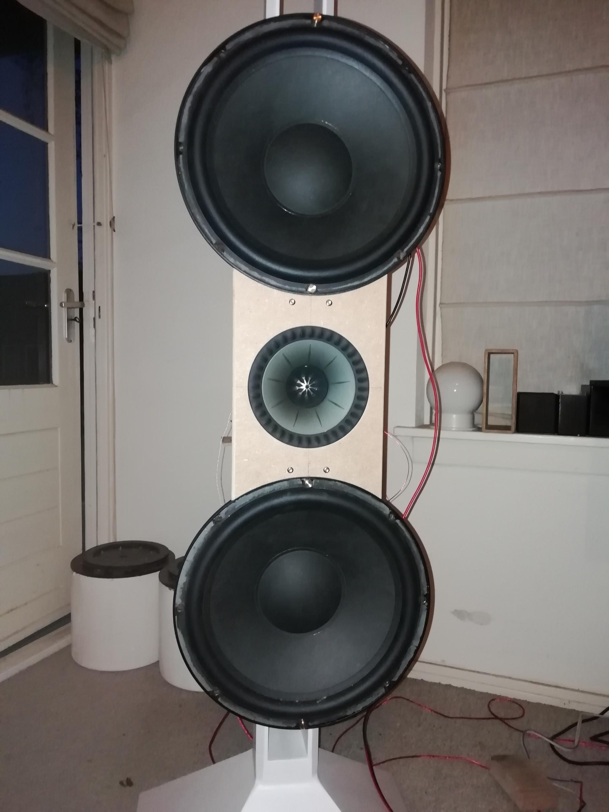

Open Baffle UniQ
Just wired and playing since an hour.
Open baffle UniQ (Q350 unit).
Woofers are Beyma 12BR70.
Not sounding well balanced yet: too much mid (tweeter can possibly do without attenuation).
Woofers not yet equalized to compensate for open baffle loss.
For the time being crossover is active between woofers and UniQ (DBX 234S).
This must play from 70 hz upwards; sub bass will be a sealed Scanspeak 30W4558 for each channel.
