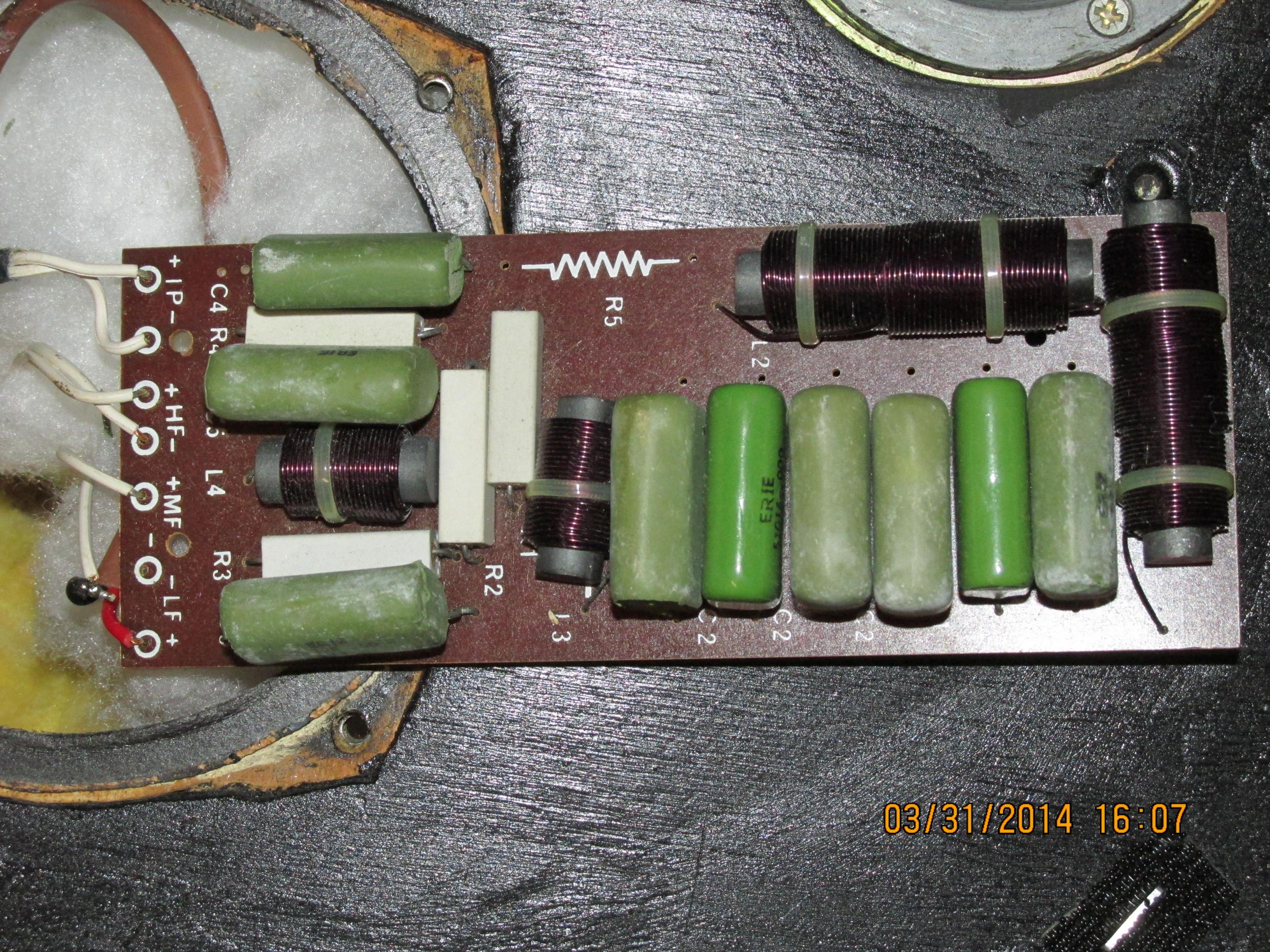

More than 30 years ago I built a Daline transmission line speaker using the following drivers , KEF B110 woofer , KEF T15 mid and a COLES 4001g tweeter. A relative of mine was using it for the last 15 years or so and I have since gotten them back. I find the sound to be dark and not resolute and was thinking of trying some new capacitors in this 3-way crossover. I am not sure if any of these are electrolytics at all and was wondering if any one here can give me some information. The caps all seem to be from the same manufacturer (Erie ?).

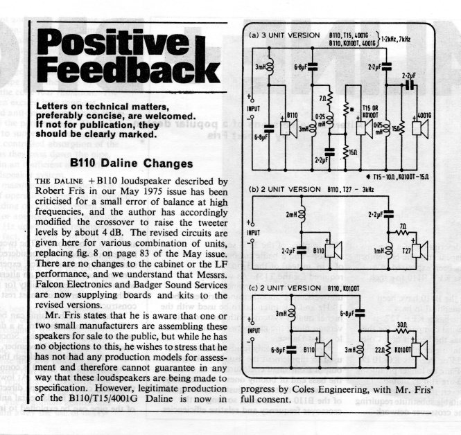

Early versions were criticised for lacking treble and I have attached a scan from a Badger Sound Services catalogue from the 80s describing a modification. It might help you.

I would like to thank everyone for responding to my thread. I am learning a lot about these speakers. This kit was given to me by a family member who acquired it back in the mid 70's. Now here is the thing. The crossover he provided is very different from the one in the original build document. As you can see there are 9 capacitors (polyester type, all values are 2.2uf ),on this crossover and I am not sure if this is correct at all. The only reference to a "model" number is on the back PCB4 . Could this have been an upgrade? I may also mention that my family member had more than one kit at the time , one using a b139 , b110 and t27 , so could there have been a mix up? In any case I would like to thank Richard10 for showing me the modification and I believe I will construct the one in his reply.

<snip> I may also mention that my family member had more than one kit at the time , one using a b139 , b110 and t27 , so could there have been a mix up? <snip>
That crossover allows for three units, including a Low Frequency driver so I suspect that it was indeed designed for a B139, B110 & T27 - I have a feeling that it might have come from Wilmslow Audio.
