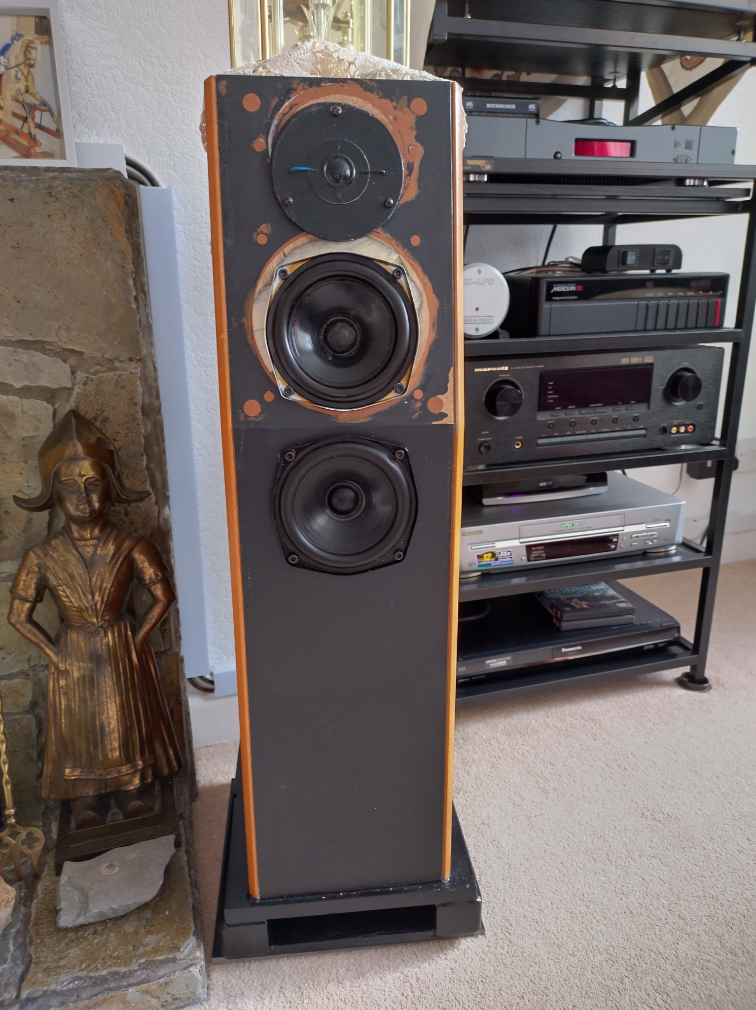

Many years ago I constructed a version of the P Atkinson Mini-Line Tranasmission Line speakers, using a T27 and B110 with a WilmsIow Audio crossover, which I regret getting rid of. I am now experimenting with making mini transmission line using a T27 and a B110 in a sealed compartment, with a second B110 in a separate compartment feeding a 1/4 wave length transmission line. For this I am using a Falcon 33Mc crossover, which I purchased for Concertos, which was unused in the end.

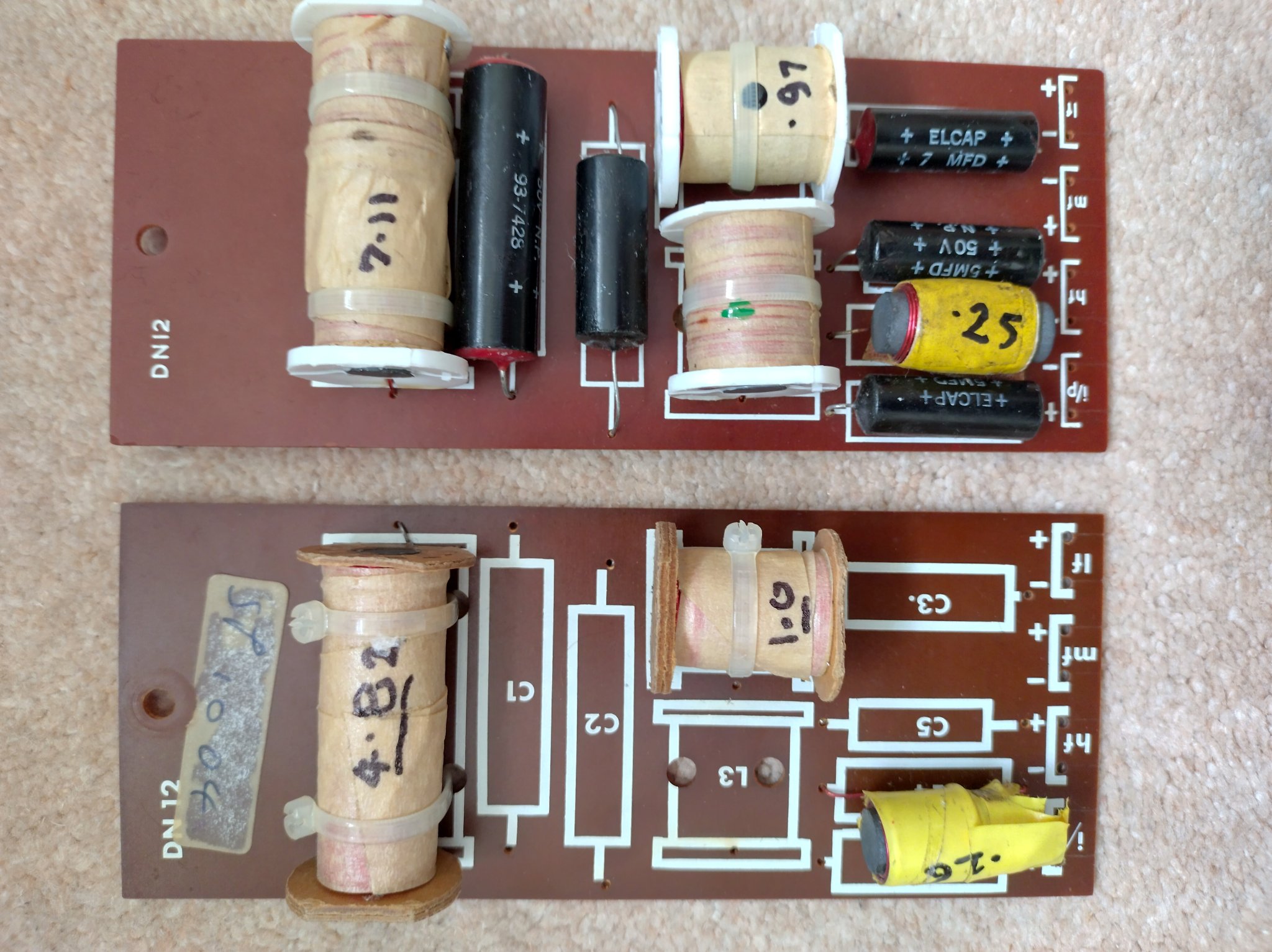

The spekers so far sound great in the mid and base regions, but are uncomfortably shrill at the very top end, and I am therefore looking at what changes could be to the crossovers. I also have several DN12 crossovers, and there are two versions with different phase configurations for the B110 !!
I had previosly contacted Falcon to query the phase arrangement on the 33MC and they replied that the B110 should definately be out of phse. However, before I start adjusting crossovers, I wondered what DiyAudio members thought was the correct phasing on the DN12 crossover.

Please see attached the two different versions of the concerto Sp1004 DN12, with the B110 in phase in one and out of phase in the other, and a picture of my version of the Mini Transmission Line under testing before altering the x-over and completing the aesthetics.
Sorry, this time with attachments, plus a sketch of my speaker design.

The DN12 XO will not be good mid to bottom, a B110 is not a B139.
The aB version of the XO for the T27 also helps out.

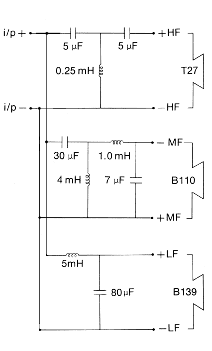

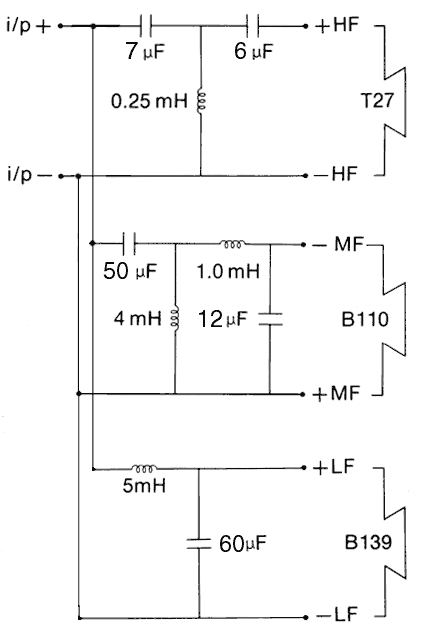

from the factory data i have there are 2 different DN12 XOs, an SP1002, and an SP1004. Both flip the B110 phase.

Thank you also for the two DN12 schematics. It still leaves the mystery as to why Kef produced the in-phase version ? When I have made my alterations and additions to the

Many thanks for the offer, but no need for now. I will proceed with an iterative approach and deal with the 'ringing' of the upper frequencies first, starting by adding a 0.6uF cap plus 8.2ohm resistor in // behind the T27 to the 33Mc. Then if that does not work I will follow the design used in the BBC LS3/5a for further tailoring the T27, using a Wilmslow Audio 2-way crossover produced for the T27/B110 drive units that I'm using in the HF/Mid section, which can be easily adapted. I will apply the extra elements in stages until I am satisfied (or devastated !), and then turn my attention to the B110/B110TL stage using the DN12/Falcon XO approach to start with (which sounds very good to me at present). I know that it will take some sucking-and-seeing to get it all right, but that's where the fun is for me. Although the cabinet alterations are 99% complete I'm only in the early stages of getting the XO sorted.
Later on I might start a new thread dealing with the B110/B110TL section and wait for the ricochet !!!

lovely project, looks nice even in the "project" shape.

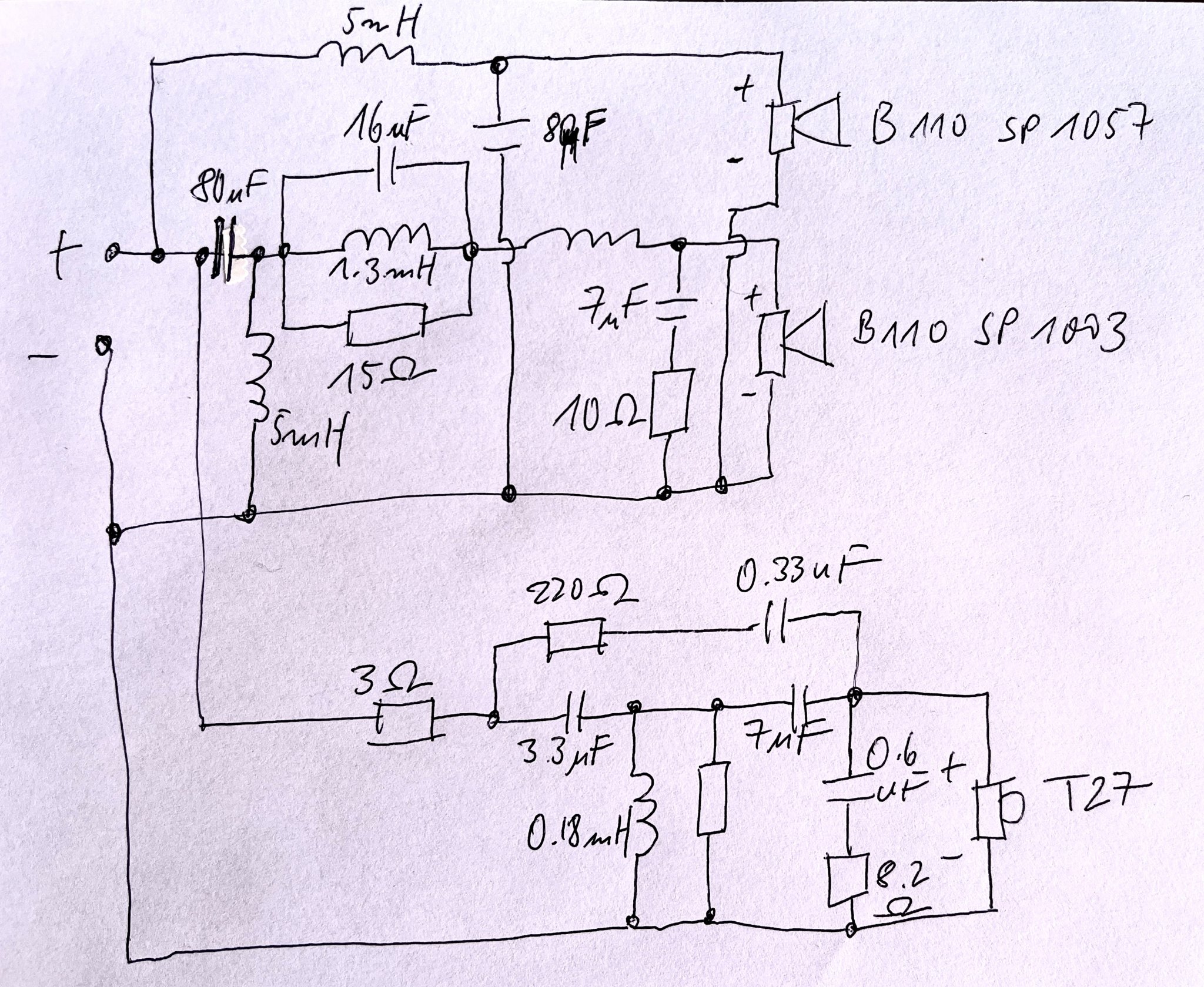

In my rebuild of the KEF Concerto crossover with an aB circuit it turned out that the midrange (B110 SP1003) was a big problem. It sounded just horrible with the standard DN12 SP1004 crossover. The bad sound might mistakenly be taken as coming from the tweeter, but is from the midrange. I did a lot to tame down the B110. I found that also the Cantata (with the SP1057) suffers from that and I have not yet found the solution (see my thread here about Cantata tweeters sounding dull).
The Falcon 33Mc has not the right aB section, it is a simplified one. I'd suggest to use the full one as per my schematics in this post: https://www.diyaudio.com/community/...th-full-ab-circuit.370666/page-2#post-7495361
Maybe also the changes I did to the B110 SP1003 circuit might help.

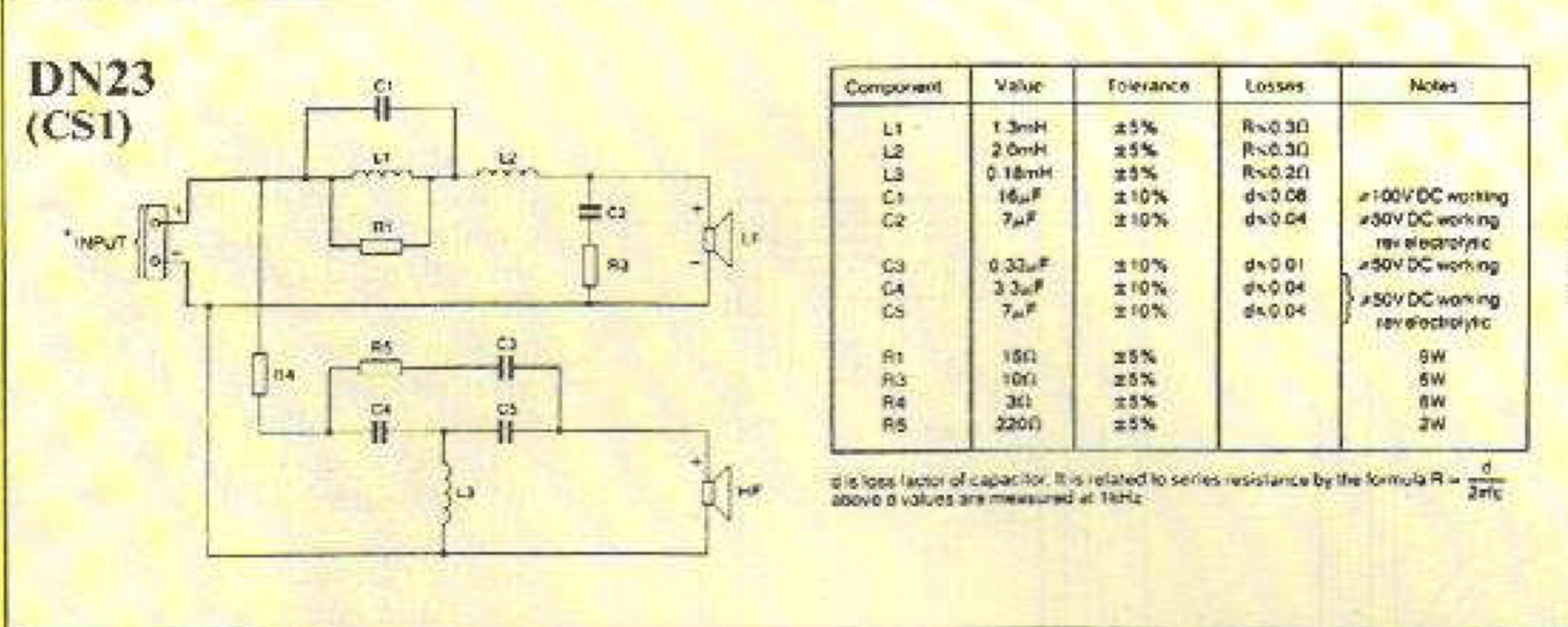

Also the "bass" B110 The SP1057 might need some notch/equalisation; what about using the bass section of the DN23 (CS1) crossover (probably more or less the same as in the Ref 101) but with a higher value for L2, so higher rolloff (sorry for bad pic quality)? But if if the bass unit is crossed over low (really low, like 250 Hz max) and steep, this might not be a problem.

The project has gone very well. I used an adapted version of the CS1 crossover for the High/Mid band section. I decided that the T27 sectiion needed some attention and so adopted two parts of the BBC LS3/5a design that deal with the T27 being a little shrill and ringing, as follows:
1. I used a 0.6uF capacitor in series with a 8.2 Ohm resistor, parallel with the T27 to adjust the frequency response at the upper end, and
2. I used a 82 Ohm resistor in parallel with the 0.18mH coil (L3), to reduce 'ringing'.
The purpous of using a second B110 to drive the Low frequencies was to free up the strain on the Mid band B110. As the Mid to Low band section links two identical drivers, this simplified that section of the crossover. For this part of the crossover I therefore used the same coil and cap values used in the DN12 for cutting the low frequencies from the mid section (400Hz) , and reversed them for the Mid/High cut to the second B110.
The speakers have now lost the shrillness and ringing I had from the Fallcon crossover, without loseing the beautiful detail and character that the T27 has, and now has a very nice bass extension, without booming.
Reactions: eschenborn
