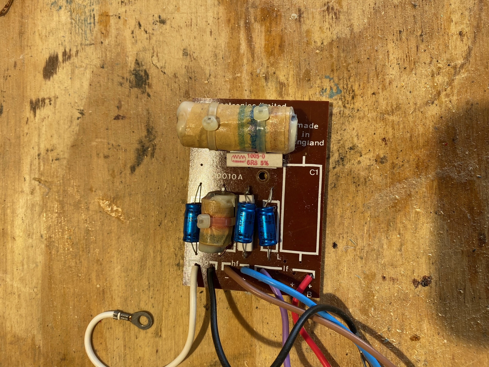

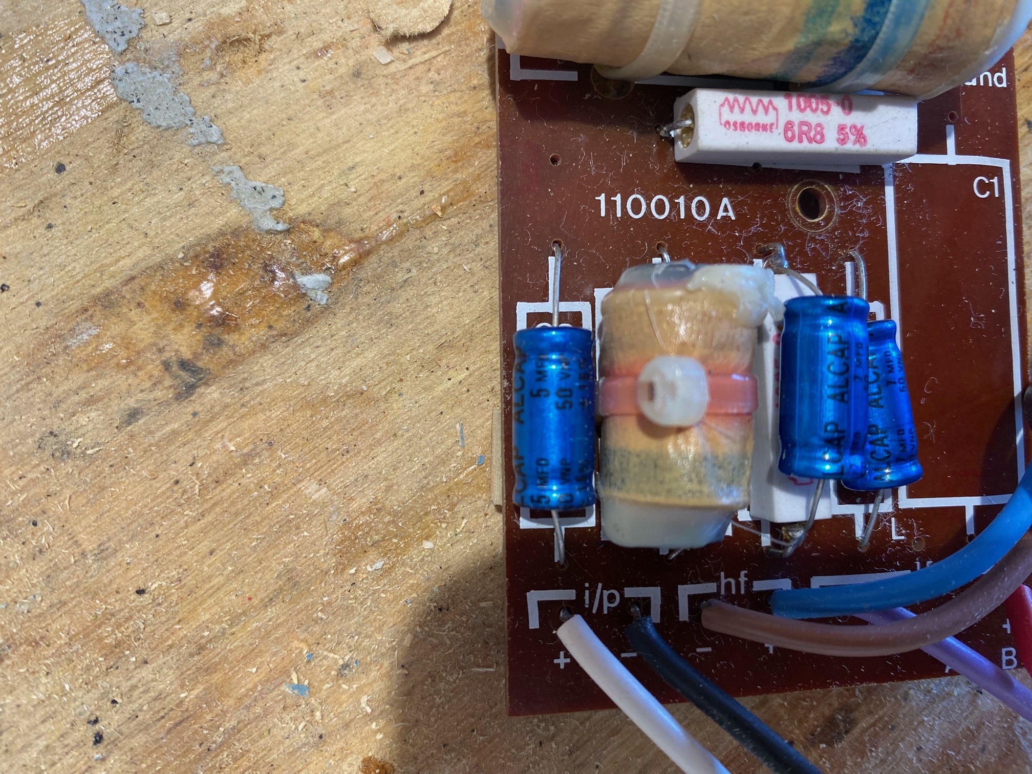

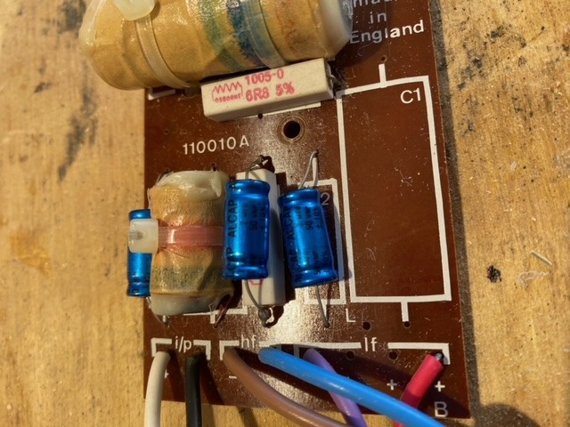

KEF Chorale III recap - need advice on cap values
I am recapping my KEF Chorale iii's...but the capacitor values are not any that I can find exact matches to (7uF and 5uF). What should I do here? Thank you!

Often crossover capacitors are 5% or 10%. But electrolytics vary a lot, especially with time.
Some mfrs select for precise values in more expensive speakers.
Film caps can be more precise and stable, but may sound somewhat different.
Also check the resistors. Heating over time can make them drift, or even open circuit.
