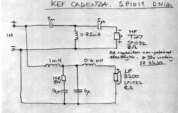

Would it be an option to rebuild them as monitors using the B200 woofer and another tweeter ? Has it been done before ?

I've been using some SEAS H1280-06 22TFF tweeters in place of Kef T27 in my chorale knock offs (paired with some B200 SP1063) and they have integrated quite well. They ideally need to have around 3-4dB knocked off them to integrate perfectly. (in my case this requires a 2R resistor in series and a 12R resistor in parallel to knock 3.5dB off without affecting the impedance)

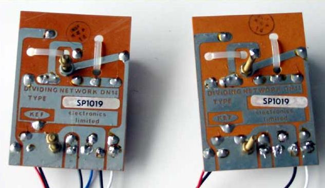

At least some KEF crossovers have had topbooster for the T27 to compensate for a falling top octave. Replacing the T27 with a flat tweeter in such a crossover, will result in a "tizzy" high range. If you got the DN14 SP1019 it is a third order filter with no tweeking of the tweeter (Item Description: KEF Electronics DN14 SP1019 Crossover)

The Morel CAT298 is a perfectly good replacement, as is the SEAS 27 TFFC with an attenuator.

Note they are wired out of phase at the tweeter, blue being hot. The capacitors will have aged are are best replaced with new non-polar electrolytic, or polypropylene if they fit.
Capacitors
Hey, Kei, it's the same treble filter as your KEF Chorale's, though the level may be affected by the exact detail of the bass filter. As we said before, the second 5uF (or 4.7uF...) can be lost and the tweeter wired the other way. 🙂
