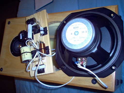

I'd look at drivers like that and immediately say Elac bass units. Monitor Audio used them in the R252 and R352 and R300-MD also, but paper types.
C40 (1985-88)
The C40 was generous in both volume and drive unit. Bass was plentiful and extended, and the design was balanced to operate clear of room boundaries on open stands. The two new 200mm bass/midrange units used polypropylene cones. Operating as a 2½-way system, the lower driver was used only at the lowest frequencies, augmenting and extending bass output, substantially improving power handling capacity, and assisting bass damping. The system would go exceedingly loud, would handle plenty of power, and, with a generous bass delivery, was particularly suited to the cost- conscious rock listener.
This is all a bit weird. You wouldn't use 4 ohm nominal bass (3 ohms DC measurement) in a 2.5 normally. It would take impedance too low. 😕
You MIGHT wire the basses in series and use a conventional sort of coil and capacitor on them. That's called a D'Appolito or MTM. but it works MMT too.
I think you need to work out the wiring diagram. Shouldn't be too hard to fit some new drivers and rejig the crossover. In fact I'm rather good at that sort of thing, though I say so myself. 😱

Those drivers look very similar, I haven't pulled the tweeter to see if it has the impedance stamped on it anywhere. I also haven't pulled any of the poly fill to find the crossover. I was just as confused when I saw the 3ohm stamped on the driver, the speakers are listed at 8ohms though I'm sure it's probably lower.

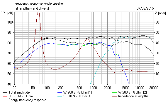

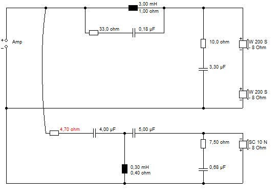

I really need to know the DC resistance of the bass drivers by measurement with a multimeter, and the crossover schematic. Which is like a wiring diagram.
I have already simulated a considerably good BW3 MTM or MMT speaker here in your cabinet. Using replacement 8 ohm bass drive units in 15 litres each. It's actually a near 3 or 3.5 kHz crossover.

I pulled the driver again this morning
Got a picture of the crossover looks pretty basic, for reference the Red and purple wires go to the bottom driver, yellow and green are for the other 8" driver, leaving blue and brown for the tweeter.

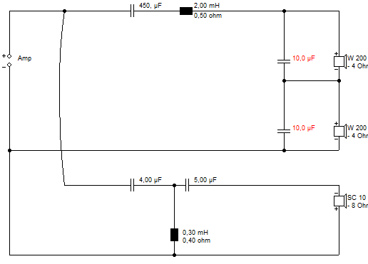

We still don't have a schematic here, but I came up with something that works with 4 ohm Visaton W200S paper drivers below. Because they're in series, impedance is respectably high. Of course you must measure the cutout too, to be sure.

Since 3 ohm polycones are a bit rare, this seems a plan to me.

The drivers are not used in the Monitor Audio R252, I have a pair and they are paper cones. Otherwise very similar looking. Good luck finding replacement drivers, may be tricky. I would have a go with some pushbike inner tube glue. Possibly a tear due to accidental damage as rubber surrounds usually last well.
