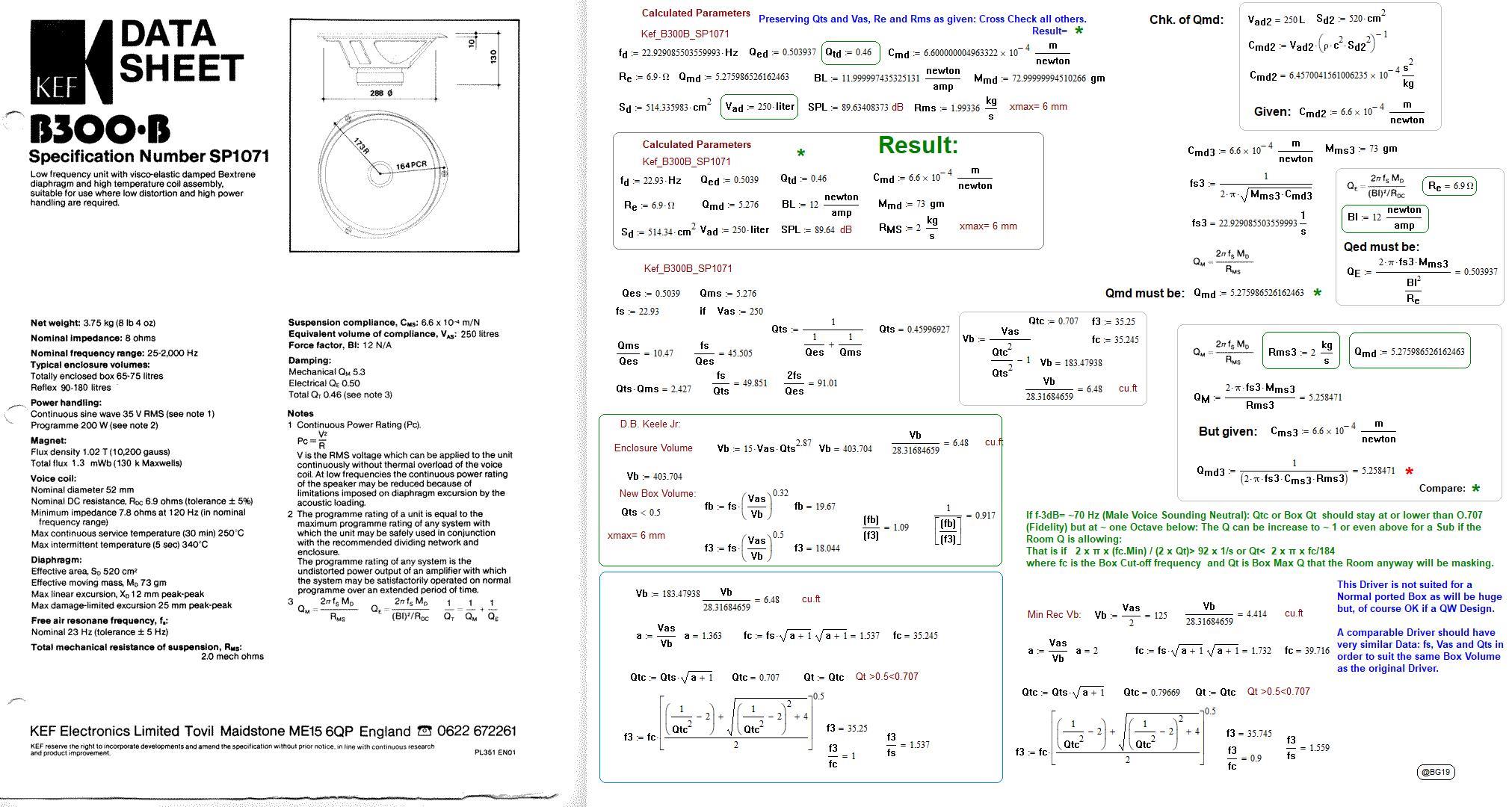

I'm looking to replace my KEF B300 Woofers ( Kef 105.2 Bass unit )
I have become accustomed to and have really enjoyed these but the one was a rescue and the enclosure. Is very rough what would be an ideal drive unit and enclosure to be an improvement while retaining some of ithe 105.2 Character?

Any Quality Driver will do: Look for similar fs,Vas and Qts but larger xmax.

Not budget but probably increasing the overall Performance:
Sugg: Replacing KefB300B with aespeakers_IB12
aespeakers_IB12AU-8(Re=5.5 Ohm)
In a 70 liter Sealed Box(= Volume of Kef 105.2):
Qtc= 6% less than for Kef 300B_SP1071(Re=6.9 Ohm)
but will return a -0.3 dB less SPL(JND)
f-3dB is about 3.3 Hz lower
xmax is 3 Times xmax Kef 300B_SP1071
Lower Kef 105.2 HPF Le by 25%(25.5) and increase the Parallel C by 25%(25.5) too based by the Re Ratio= 6.9/5.5 = 1.2545
