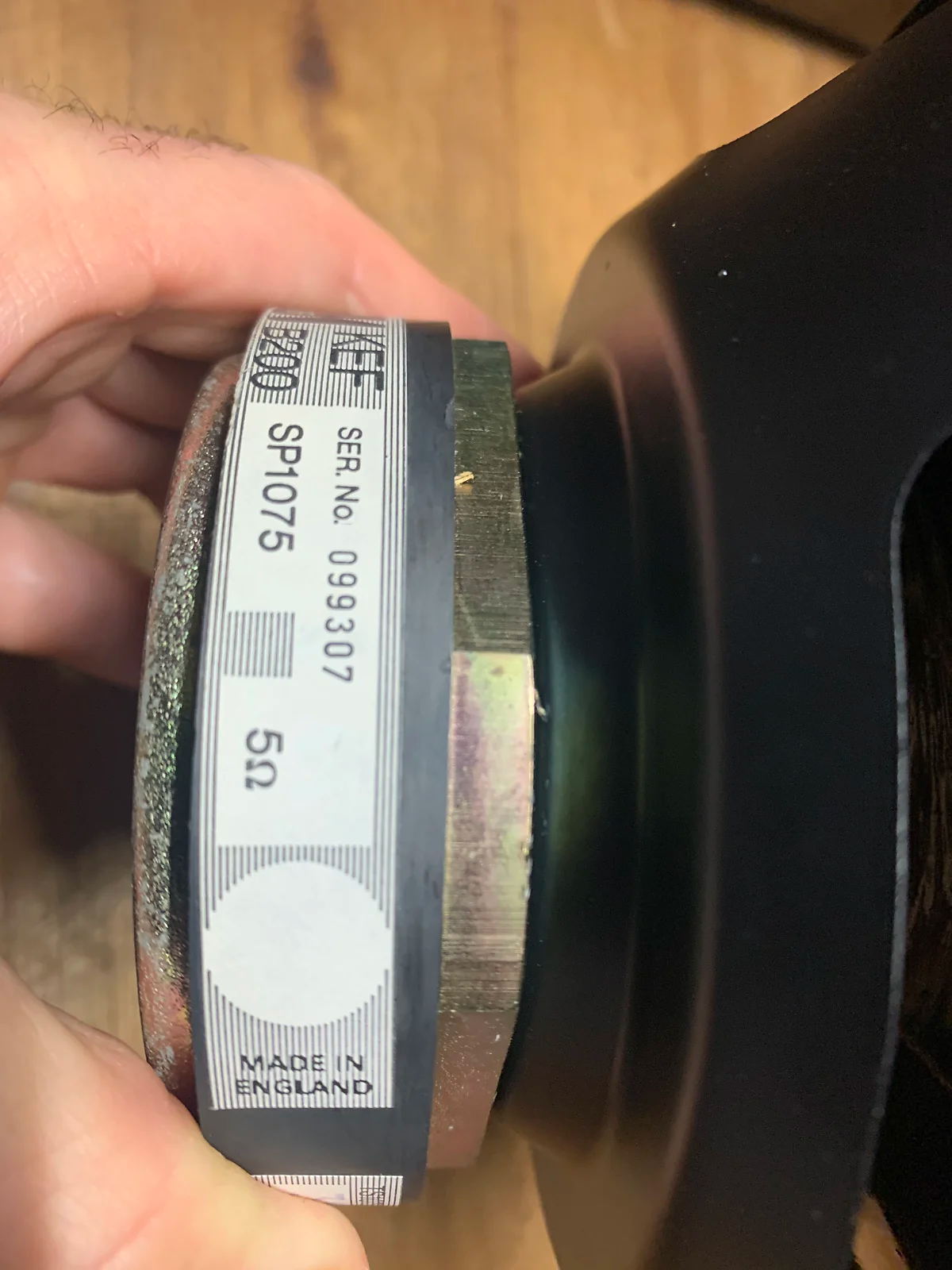

The three point mounting woofer is likely a B200G SP1075. Please remove a woofer to see if there is a label that confirms this.

Consequently, it may be too late to rescue your woofers - and replacement used B200 SP1075 drivers may well show identical symptoms.
Your only hope may be in sourcing a compatible modern equivalent. However, that may prove problematical as those KEF units are pretty unique.
