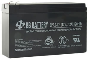

just wondering if a sealed lead acid battery can be set on it’s side?
I am building up my amp case and am planning it in CAD. The battery is a sealed lead acid
commonly found in home alarms. By placing it on its side, the case can be significantly lower in height.

Quotemichelevit said:just wondering if a sealed lead acid battery can be set on it’s side?
Since the electrolyte is held by a glassmat
separator and plates, the battery
can use in any direction and position
without leakage.
Here is the link to a spec sheet.
http://lib.store.yahoo.net/lib/zbattery/bp7-12.pdf
