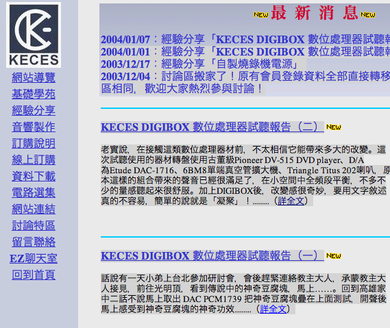

I have just looked at your site with Chinese Language support and all I got was neither English or Chinese. What is going on?
Well, Koping is not well versed with English... so I'm here to respond questions in English... Call me Maniac or David... whichever you prefer... 😛
With Chinese support, you need to install the proper support in your system before you can see it. Otherwise all you will see is a bunch of garbled ASCII code... You need Traditional Chinese support to be exact. Simpilified Chinese uses different encoding, and thus cannot be used to view the page.
[With Chinese support, you need to install the proper support in your system before you can see it. Otherwise all you will see is a bunch of garbled ASCII code... You need Traditional Chinese support to be exact. Simpilified Chinese uses different encoding, and thus cannot be used to view the page. [/B][/QUOTE]
I have traditional Chinese support; in fact I am Chinese and there are no problems with other TW sites.
What to do next?

Don't know what computer you have. Tried it on two PCs, latest Explorer, 98SE with Trad Chinese, XP with built in support, both show machine code.
Some Taiwanese sites are funny. My computers work on most of them.
Windows 2000
Internet explorer 6
