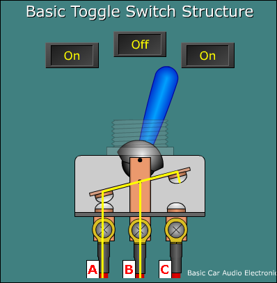

The switch below is half of what you need. This is a SPDT, you need a DPDT which will have two rows of 3 terminals. One group of three goes to one channel and the other group of three, to the other channel.
In this image, the B terminal goes back into the deck. The A terminal goes to one channel of the external source. The C terminal is the output of the DIN from one channel of the deck's internal sources.
When in the current position, the external audio would play through. When the toggle was flipped, the deck would play through as if you had the jumper plug in place.
