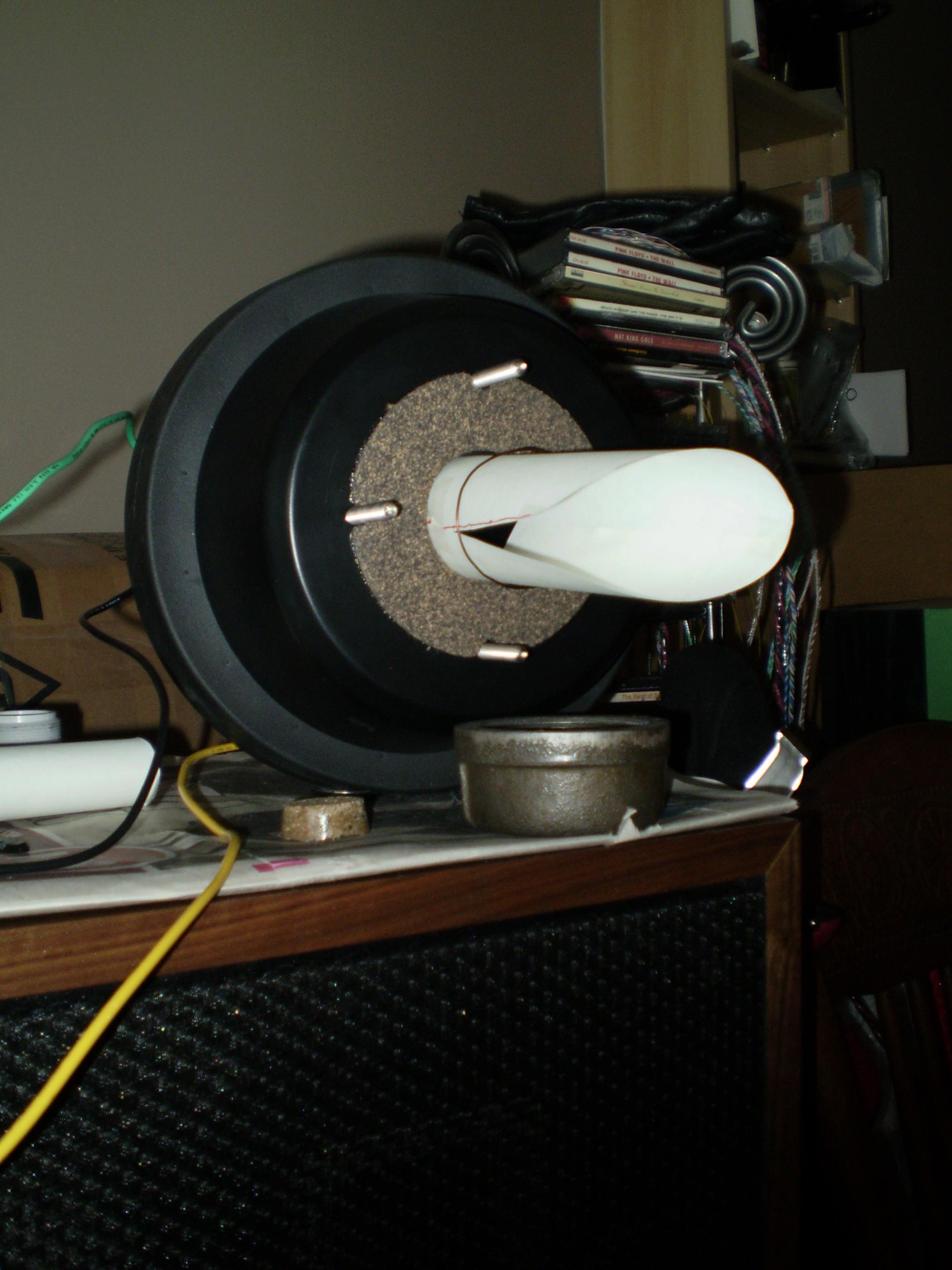

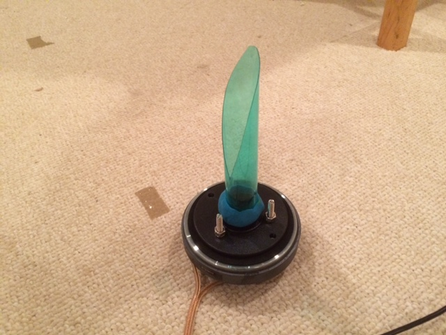

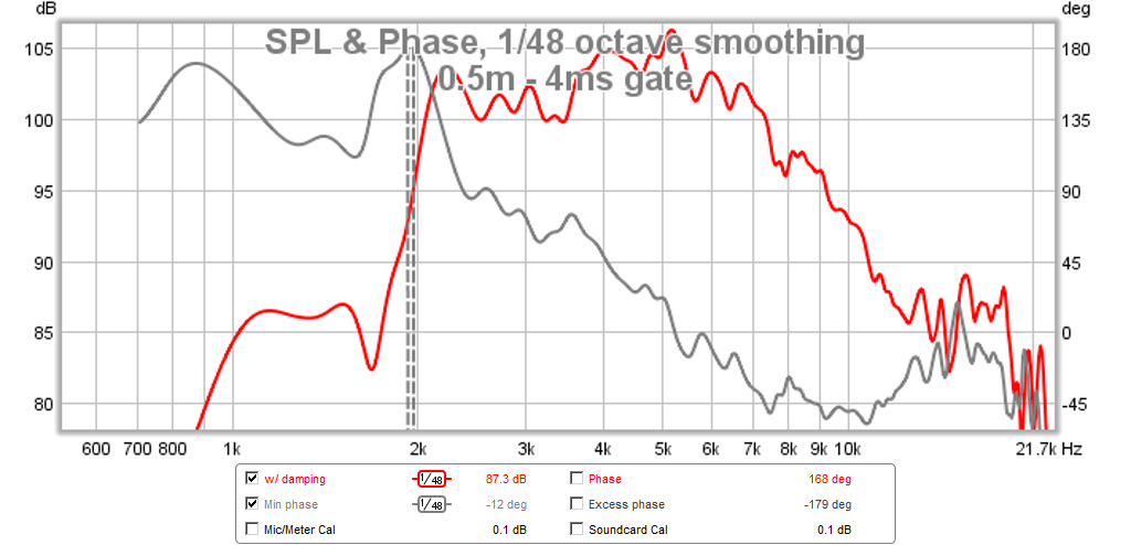

So I decided to test this K-tube concept out - it is simple enough: I took a 1in dia plastic tube from an old toy, took scissors and cut the slotted aperture, or should I say Kut the K-aperture? 🙂 Anyhow, the tube was about 5.5in long with a 5in long aperture. Then secured the tube using modeling clay to a 1 in dia throat PRV D280Ti compression driver. I made the measurement 0.5m away at 30 deg angle from axis of tube but aligned with K-slot. The resulting measurement surprised me with how flat it was and listening to it XO at 2.5kHz with an 8in Beta 8CX (no CD) in an XKi was downright pleasant. The most impressive thing was how wide and uniform the polar dispersion was. I did not have time for a polar measurement but walking around the room, could hear that it was very uniform over +/-70 deg or 140 deg wide. There is a fall-off int he HF's but I later found out it's because I did not have the K-tube oriented properly. I had it pointing straight up as shown in the photo with mic, the tube should be aimed up about 30 deg from horizontal with aperture facing down and mic level. Freddi. do you have some data that shows how flat it is and how high up it can go?
Photo of the setup:
Here is frequency response and phase:

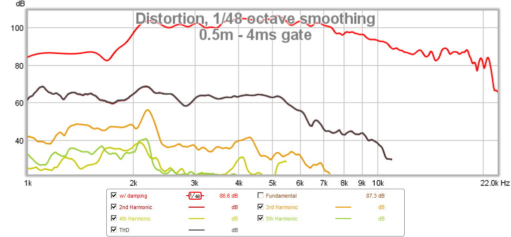

Here is the harmonic distortion:

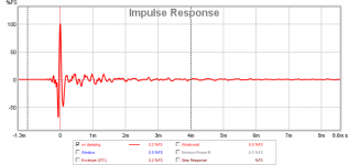

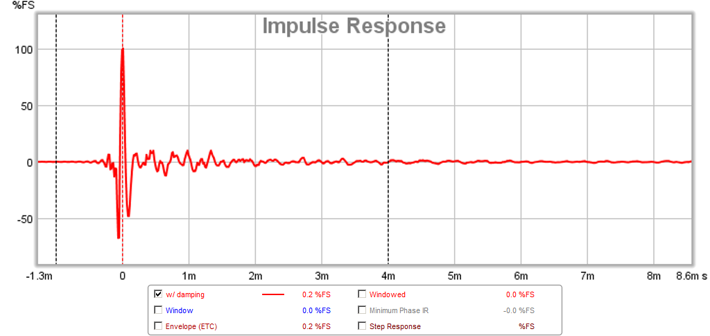

Here is the impulse response:
Summary: a very smooth sounding "horn" that is dirt cheap and brain dead easy to make. I have heard that even a cardboard tube can work. My next step will be to print one on a 3d printer with a CD bolt flange. Highly recommended that you give it a try - it looks funny but it really works. I am in the process of making a 90x40 deg SEOS waveguide and will compare the two at some point.

Nice enough attempt 😉 - but I think you'll find it measures and sounds even better with a slower flare aperture and straighter, more rigid walls. As freddi often said, schedule 40 PVC is pretty good for this. Draft, print and cut a half-ellipse pattern to wrap around the tube, mark the edges with a pen and cut with a dremel type tool. It should make for a more gradual transition to free-air and fewer reflections.

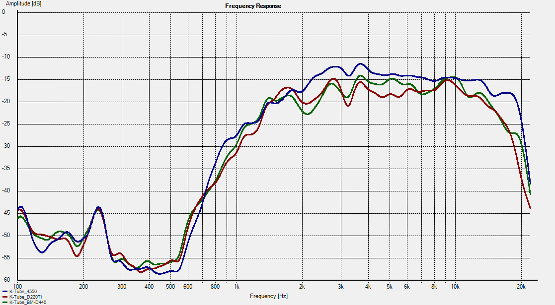

Here are a few measurements I performed on the Transylvania tube.
This one was using a Samson GoMic, which I believe rolled-off a bit above 14-15kHz, but nothing awful. Taken a meter or two away IIRC, it's been a few years. Same tube on three different compression drivers. Tube pointing ~20° up, slot down. There was a ~1.5kHz PLLXO.
attachment.php

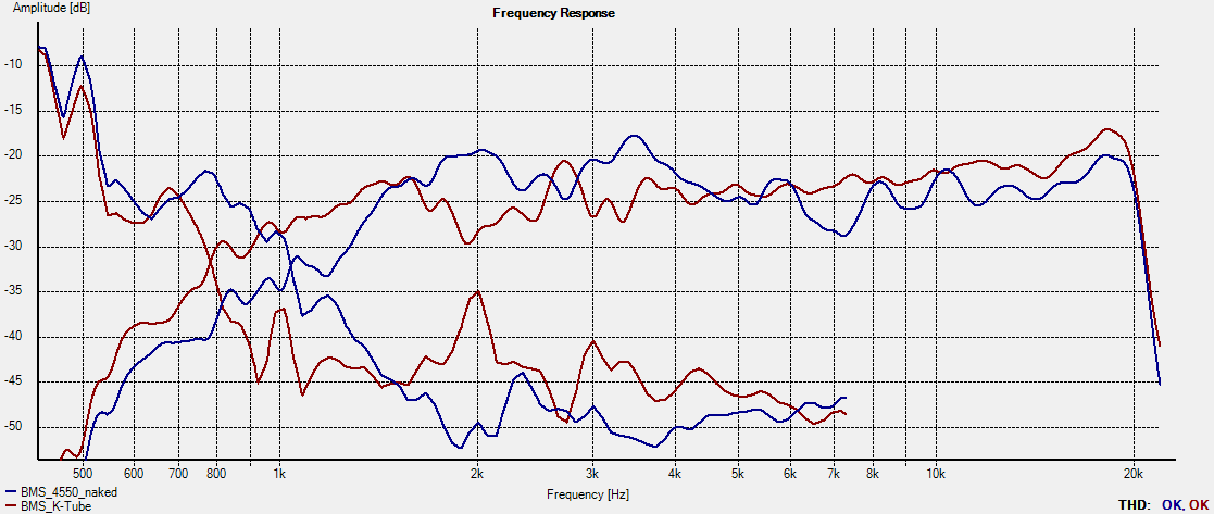

This one was with calibrated UMM-6, but pretty near-field, maybe 10" or so. Same compression driver (BMS4550), naked (blue) vs tube on (red). A little something going on around 2kHz on the distortion plot.
attachment.php
We can see the tube seems to offer some load down to 700Hz as per the reduced distortion.
Little to no contouring needed with the K-Tube usually, will mostly depend on the compression driver. Power response is pretty good subjectively, I never measured much off-axis. It's different from the CD-waveguides I like a lot, as the dispersion is all over the place because of diffraction instead of ~90°.

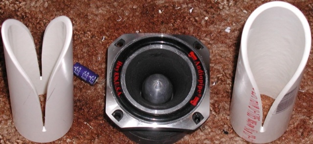

My K-Tubes (on EV DH1A drivers) are made from a single piece of 1/4" graph or notebook paper just one wrap and some tape. I do use a simple wire hoop made from twist tie wire (burn the paper off) to keep m tube round. You can see in the photo above how the plastic K-Tube wants to open up and gets distorted. A little hoop of wire keeps it in a nice tubular shape . I use a double cutaway tube design which looks like a bishops cap. I don't plan to switch back to horns any time soon. K-Tubes are the best I have ever heard never heard a horn that would make me switch. Kount me in a a K-Tube kfan (the k is silent). Best regards Moray James.
attached picture of plastic single and double cutaway tubes . picture of paper single cut away with wire hoop to retain shape. The paper k-tubes sound excellent. Just for scale that is a 2" id. tube on the EV DH1A.
