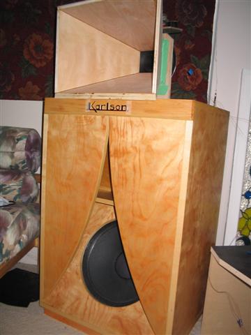

hey freddy....long time no talk since the K forum went down. anyway, i never finished mine over the summer and then i had to go back to school...besides, my university house probably doesn't have the room for a pair of K15s. I'm stuck with my trusty old Wharfedales for now.
I got a little intimidated by crossover design and sensitivity matching with compression drivers so i decided i would triamp. i am going to be covering the mids with an original spec Smith Horn and might try a K-tube for 5-8khz on up. power'll be provided by a fully regulated LM3875 dual mono gainclone for the woofs, and a pair of modded T-amps for mids and highs. how have your experiements been? and health?

a Karlson coupler probably should have hard finish in the front chamber to aid with "reverb". This gives them (on a good day/recording)) a more live and palpable character than direct radiator The effect is adjusted by baffle angle, slot gap at top, coupler width, wings taper.
according to one builder, slot's inductance is one part of the low prequency behavior and that rough model might be in Karlson's 1952 Audio Engineering article.
the original Karlson with good 15" coaxial is not a shabby thing and can play good kick drum and bowed bass which seem to be sticking points for reflex..
I don't have saw, etc to build new test-couplers. A few variants were built and I tested 32x16x21 coupler with 23 degree baffle and 10 degree port board using 15 and 18. RTA is nearly useless besides seeing general LF.
a new test-mule k-coupler should have removable wings and other adjustments available. The upper board may have some forwards cant and an upper reflector might be of benefit .
there will be very little damping in the rear chamber and damping beyond this can kill the sound..
drivers with weak power response like B20 are not suitable.
I don't know how good small coupleres might be made.
besides MJK, Martin Poppe is very alive and well and would converse on Karlson.
K15 was finalized in the summer of 1951 and had 30 degree baffle tilt, dimensions of 33x18x18 (possibly 17 depth for first model), ~40 sq.in. vent and a front deflecting board to partially cancel a 250Hz null. This board never appeared in smaller coupler.

if you have a strong and good 15" coaxial then K15 might be a good start and fun. Then see if it could be "beat" within the same bulk as maxium.

hi doggy -- I never had k15 anywhre near that pretty - you did a great job. do you think Karlaons are worth doing/keeping/ & building vs other types? I get "pretty good" preformance from k15 and k18 - when a big drum hits with say 200W input peak, cone doesn't move much. what kinda conical did you build for top? how far did you gap the front shelf from wings?
When I moved, those top horns went; I had so much stuff, could not take them with me.
I have the x-over and tweeter from a EV suitcase pro speaker, originally 12" bottom; this coupled to the k-15 give good imaging.
The gap at the top ended up at 5/16", it should be 1/2. I don't know if enlarging this area up top would make any audible difference? I had thought at one time the k-15 is a type of front loaded horn with the back wave getting into the mix, it would be fun to really crank them to see what they could do.Will put this back together again in the near future. The K logo were laser cut from mirror polished stainless. 🙂
hey doggy - might be fun to try a 10k about like that testbox pic - say 14x13x27 - 14" would be nice width to pile in with other stuff.
whachu think about a 10K or new 12K and how one might be done? seems to me it wouldn't hurt to have very rough test box with hinged baffle and a roll of duct tape to set baffle angle and upper board by ear (?)

hahaha - wish U were neighbor - thenI'd bribe U to kut some K - might be frustrating process - is plywood pretty good & tasty for Kooking hot dogs and hamburgers?
one more thing doggy - to get the original experience & intent (good/bad/whatever) with K15, a coaxial or wideband is needed, Highs are generally very good poked back in da kavity

thanks - getting back to Karlson - k15 with c15cx is pretty good on a number of things including pedal harpsichord (better than my ob stuff) K's are great for plucked strings.
for modern driver, 15cxha should be similar (?) but have seen comments to HF driver not having a lot of sensivity.
k15 is already designed and ready to roll. watch out for front shelf getting too close to wings or port area being choked too low - also, damping beyond JEK's 3 pads is probably too much and will kill it.
Moray - do you thnk a taller 10K could sound good? - 27x14x13 - 25-30 degrees, ~1.2CF loaded Vbr/~0.6CF Vbf - tuning (Z-minimum) ~55 or so (?) - getting tricky. X15 seemed more problematic than K15 plus x15 using ~5-8% woofer loses almost 1/2 octave due to ~43% overall bulk downsizing, leaving more a "midbass" unit. C-N ran 1844 and liked it for awhile - I had trouble with this in x15 copy - partially due to high Le (4mH for an 8 ohm driver) - maybe mass to some extent. Cone composition on 1844 is good.
