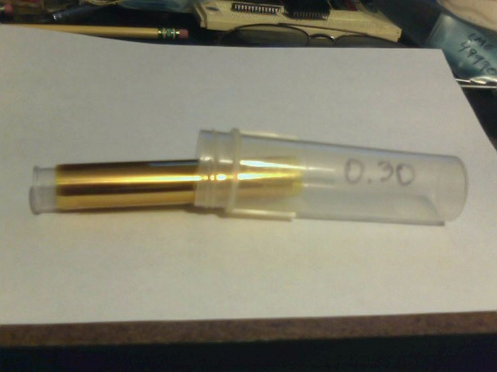

I have some Kapton.
I was supposed to post some pictures for you DeltaStar but I had got side tracked, Sorry. 😉

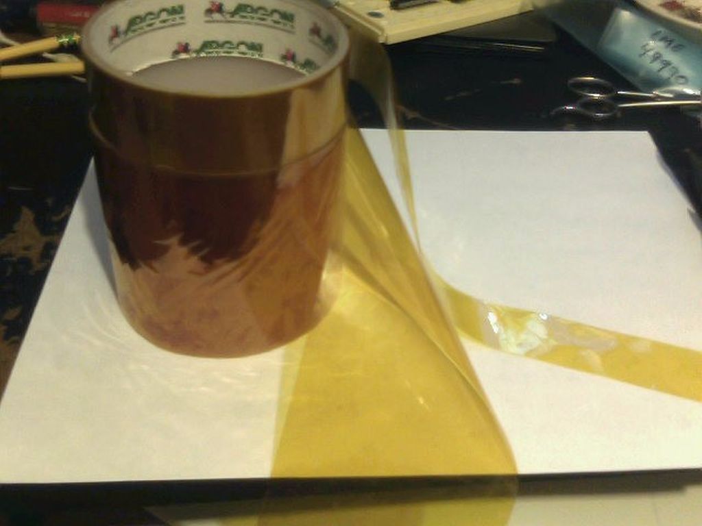

It can be gotten in small gauges as I have some .3 mil (7.5um) right here that is 2.875" wide.
I also have some 1mil that is 1" and 3" wide material.
I thought I had some .5 mil stuff but I do not.
I just verified the thicknesses with my micrometer.

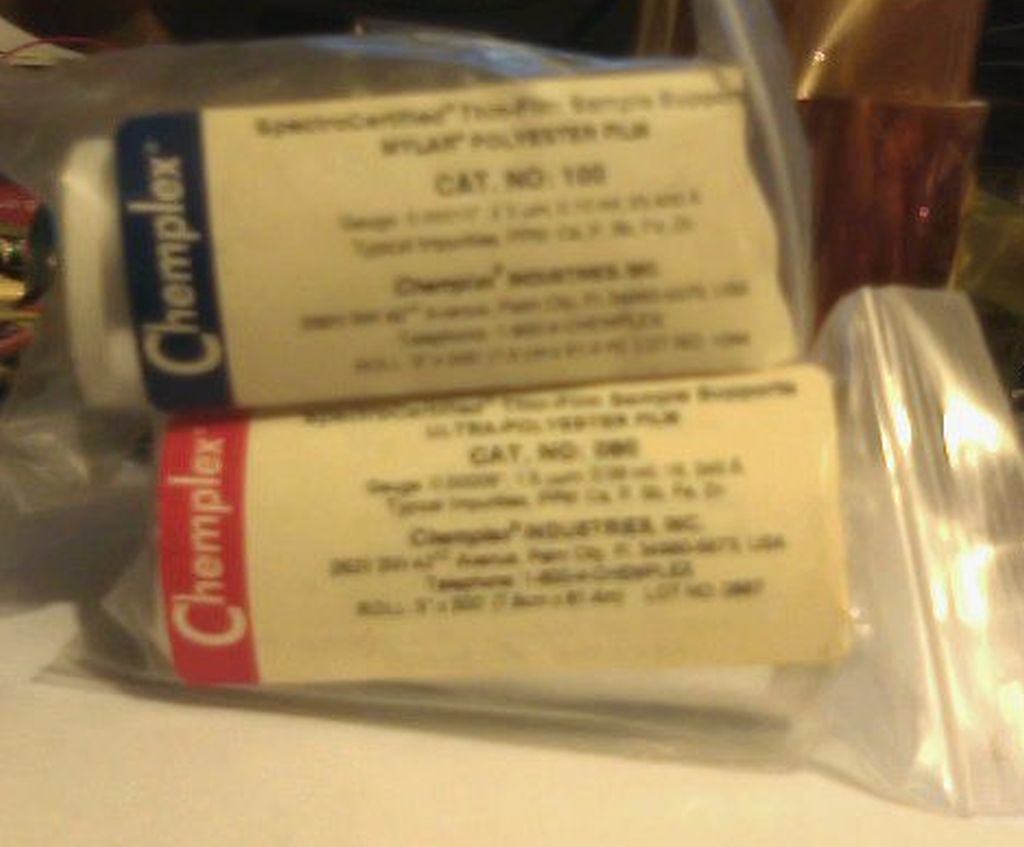

I got these and some othe gauges of Mylar such as a very thin .1 mil (2.5um) and .06 mil (1.5um) Polyester (Mylar) as samples from Chemplex.
I used the .1mil stuff for my MicroESL driver that I made out of credit cards.
But, I haven't tried the thinnest .06 mil stuff yet.
