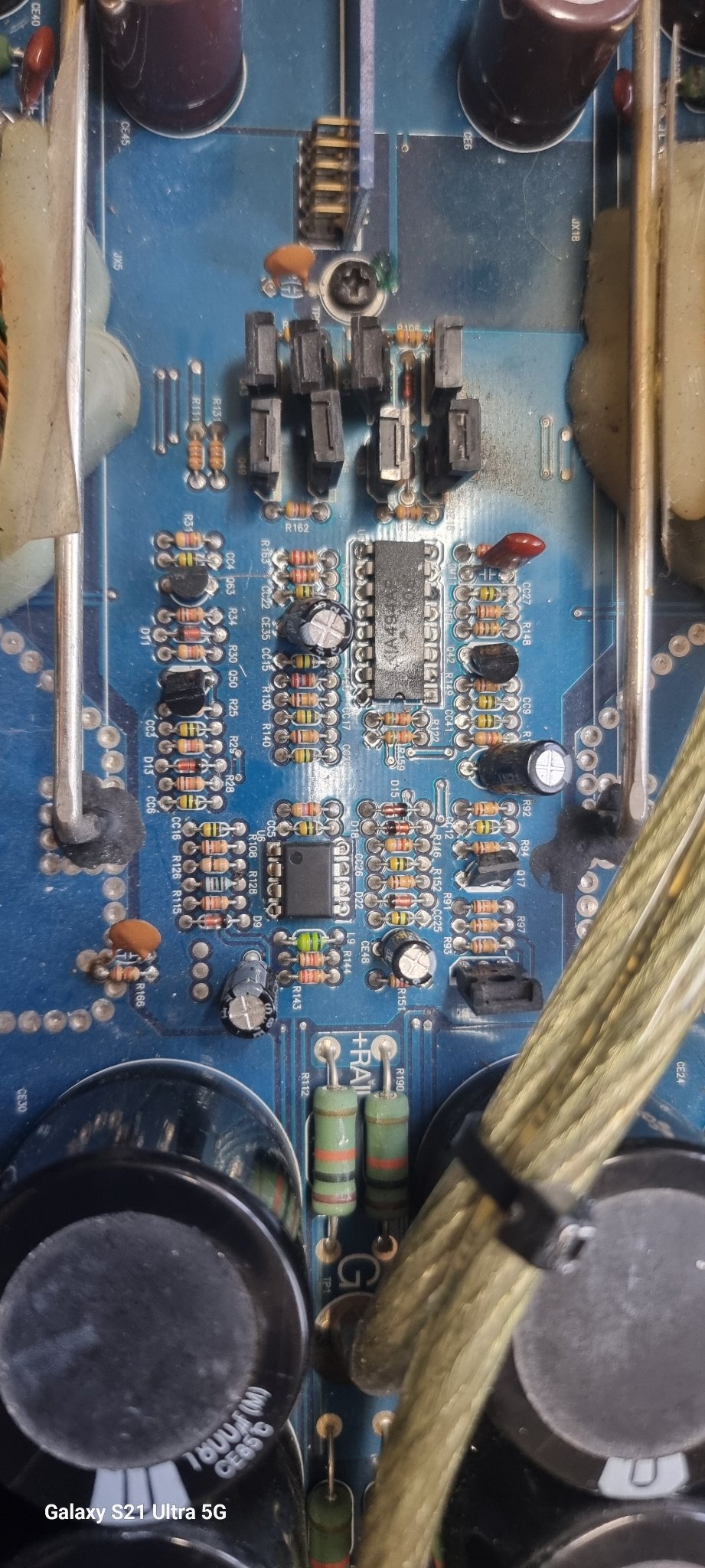

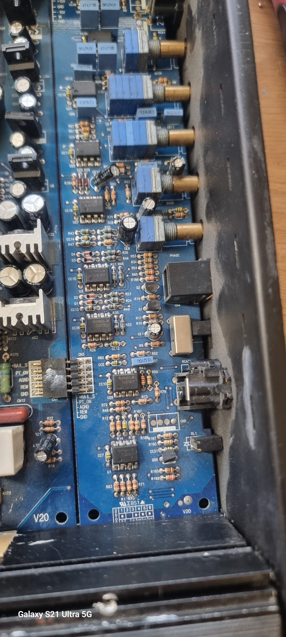

Hello, I have a problem with this amplifier. It's stuck in the protect. Everything's been repaired, and there are no more problems. If I remove the Q50 transistor (A1266), it runs smoothly and nothing heats up. So I suspect there's a fault in the protection circuit. I've already replaced the TL494 and LM293N just in case, and then it ran for about 15 minutes. Suddenly, it started cycling on and off three times, and then it got stuck in the circuit breaker again.
I need help, please.
Board

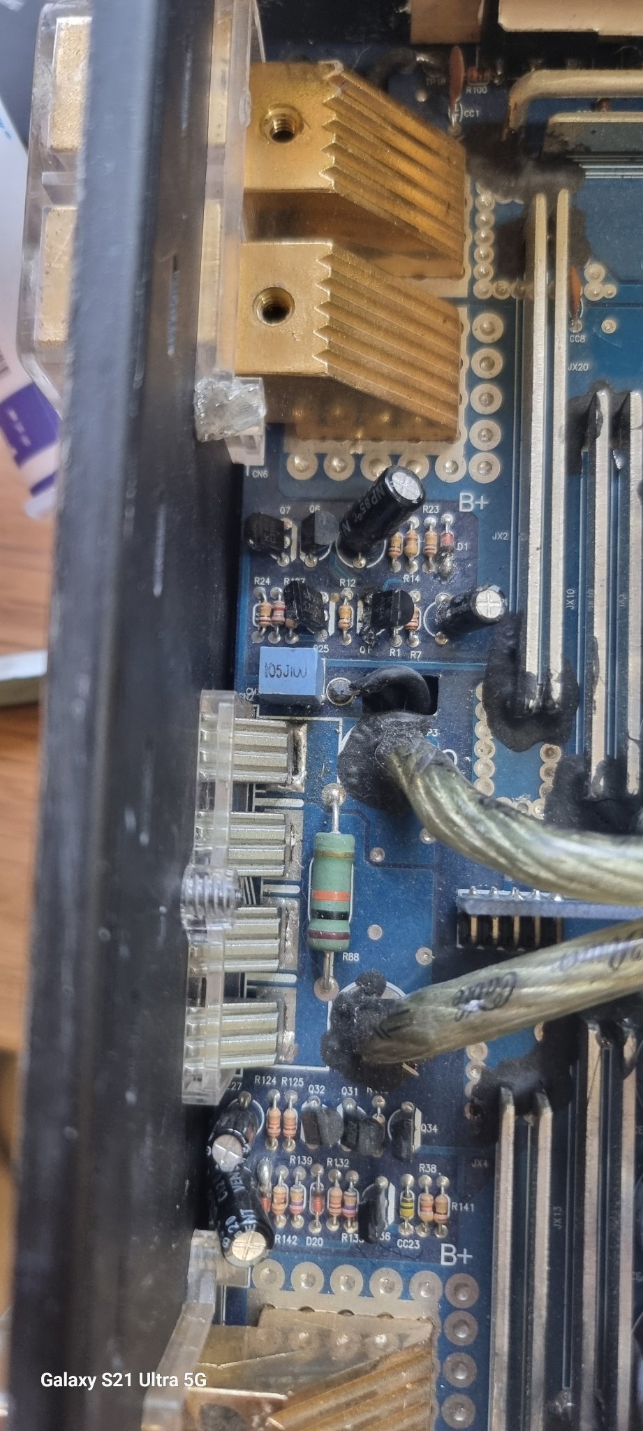

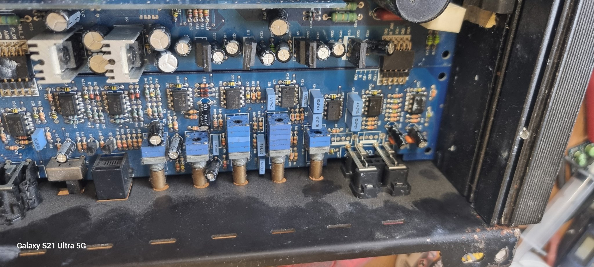

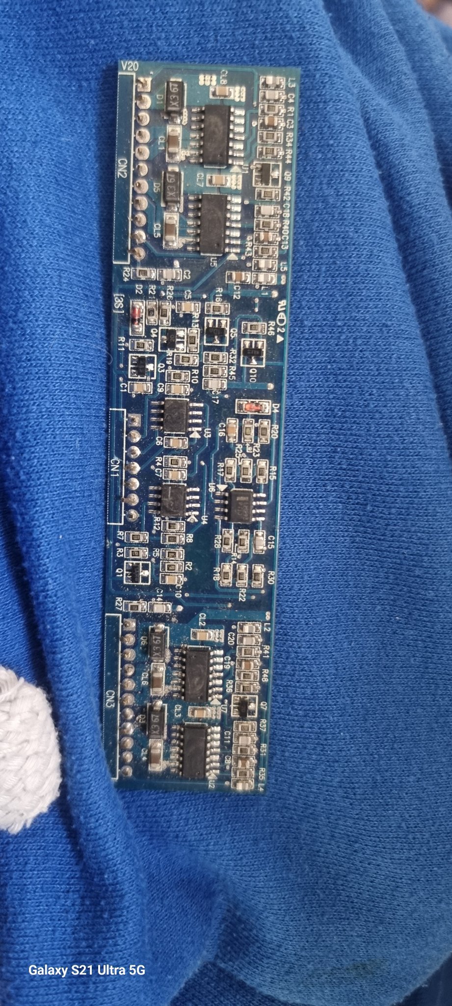

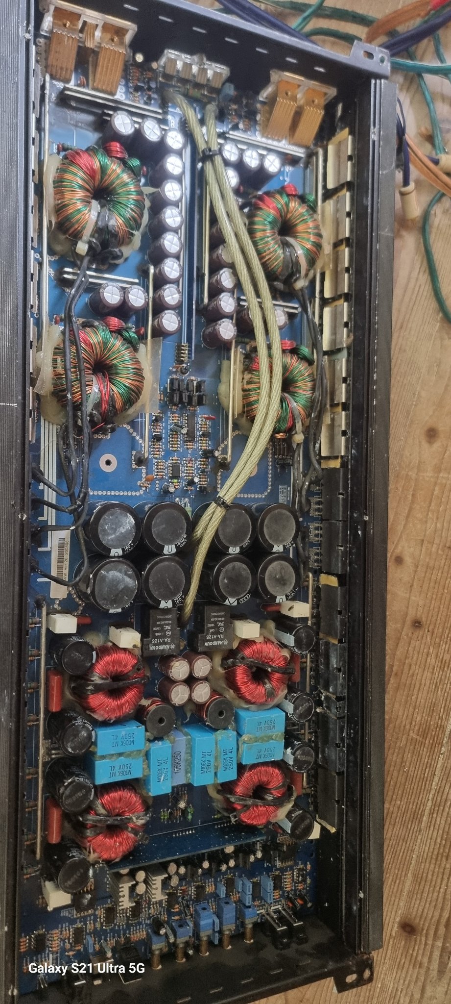

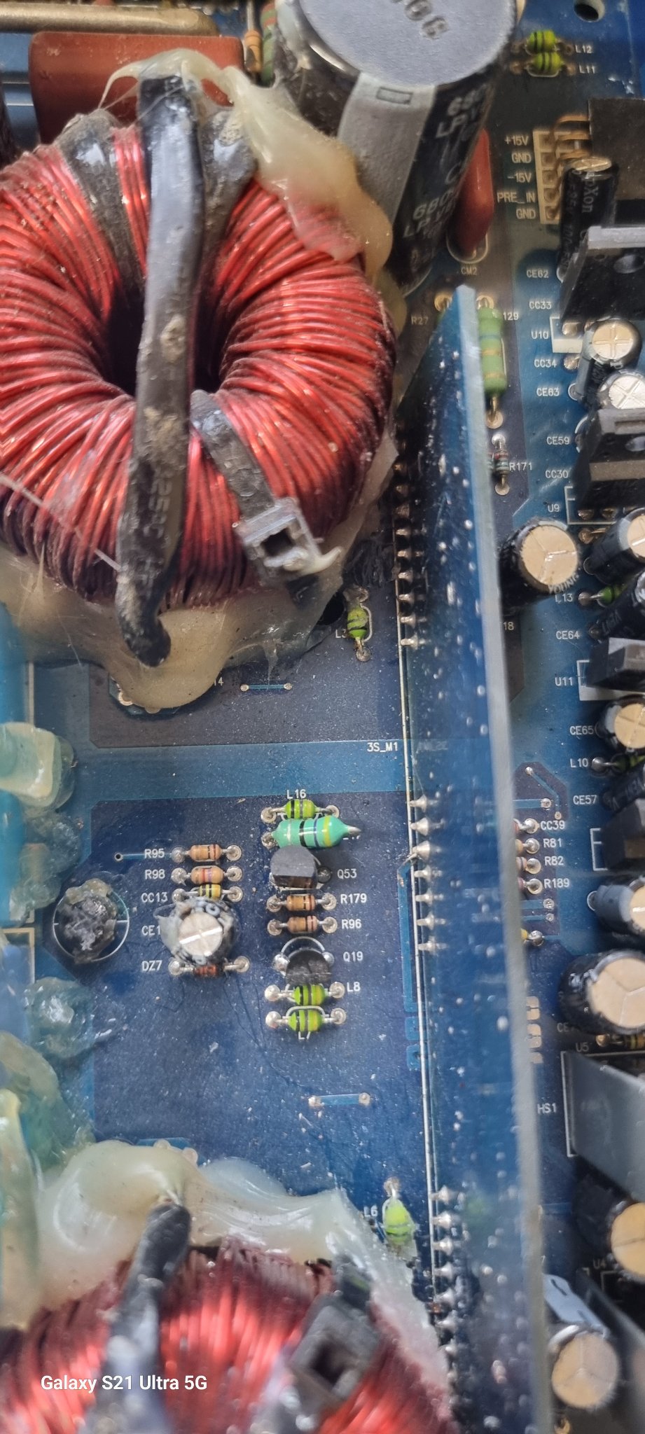

I took some photos

That would be Q1. I already tested this during troubleshooting and replaced it as a precaution. No changes. the diode and the resistor are also OK Is it true that an A1266 is also installed at Q1? This amplifier has already seen several people working on it.
