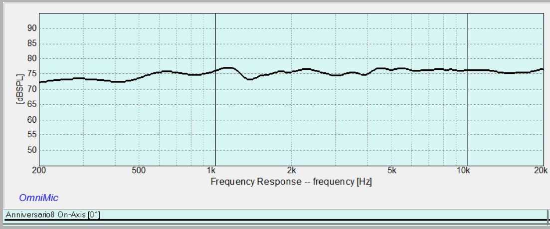

I looked at the published frequency response which I posted below and I think I heard a little bit of ringing in my ears. But joking aside, I can't help but thinking these will be forward with emphasis in sibilance. Maybe they will sound nice on perfect recordings, but on less than perfect recordings I just have a feeling the sound could be fatigue.

I understand what you said. Basically we need to get more bass enforcement or bass gain at the same time reducing the high frequency by listening a bit off axis. But still, the freq. response does favor high frequency especially a around 5khz and above where sibilance is present. Also the 2khz - 3khz seems a bit elevated for my taste.
But I still don't think one should play around with position too much as a way adjust the sound. I think a good pair of speakers shouldn't be too fussy with position.
