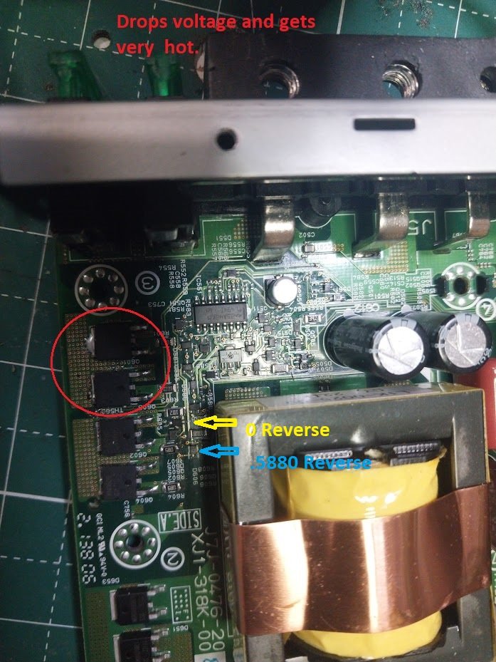

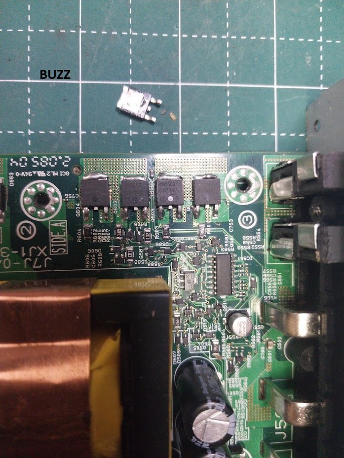

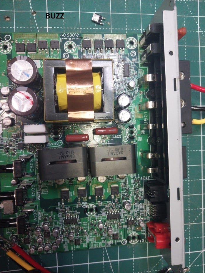

I got 4 free Kenwood KAC-51 that do not work. All four have made 2 fets burnt all in the same location.
After replacing the 2 fets and gate resistors I turn it on but only get a loud humming noise. My Oscillator shows a square wave but jumps up and down.
Im hopping if I can fix this one with your help the other 4 will have the same fix or close to it.
Thank

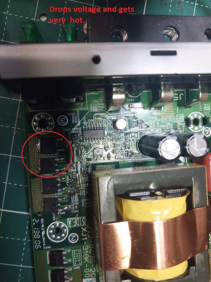

I did replace 4 fets and the gate resistors were fine on the second one but it drops in voltage when remote is energized. (dead short)
Pictures attached

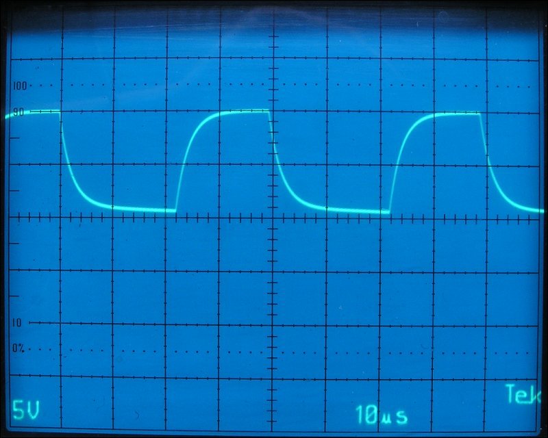

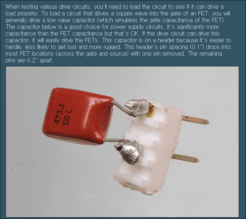

TT9, item 23 if you have the tutorial has much more information. Get the latest version if your doesn't have all of the simulated waveforms. There are 13 images in section 23.
You won't use the header shown with SMD FETs but the test is the same. You connect a capacitor across the gate and source terminals to see if the drive circuit is driving to ground as it should. With no load, the current capacity of the drive could be compromised without it showing on a scope. It would look like a perfect square wave. With the load, a good circuit will look like the waveform below. A defective driver circuit wouldn't be able to pull back down to ground as is shown below.
Since the SMD FETs may be difficult to remove, connect a resistor or jumper wire across their gate and source to keep them from passing current. Remove the gate resistors and load the output of the driver IC (where it connects to the gate resistors, after any drivers) with a capacitor (0.1uF - 0.01uF) and a 47 ohm resistor. One terminal of the capacitor would be connected to ground. Check the waveform on the ungrounded terminal of the capacitor.

1. I was unaware that revisions occur daily; the last update I received was quite some time ago. How would you prefer me to provide my email address and IP address, assuming that is still the method you use?
2. I believe I have identified the issue, or at least part of it. By comparing the diodes, specifically A1, which I think is an IN4001, with a functioning one, I noticed that the yellow diode shows 0 reverse voltage from Gate to Ground. Additionally, when testing the blue arrow for the other two FETs, the diode from Gate to Ground measures .5880. I conducted the reverse testing using a diode tester with the negative lead on the Anode and the positive lead on the Cathode. Please let me know if my explanation is unclear.

I did placed an order for the A1 (4001) as you recommended, and I have successfully fixed it.
Thank you for your help.
