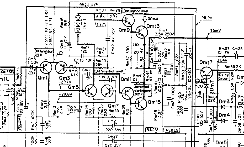

I have made a zip package to post here
Maybe other forum friends will appreciate to see the schematic.
The original came from Croatia and was not very good in focus... despite pdf, the master image transformed into pdf was not very good.... bad master results bad copy.
enjoy..it is barely readable.

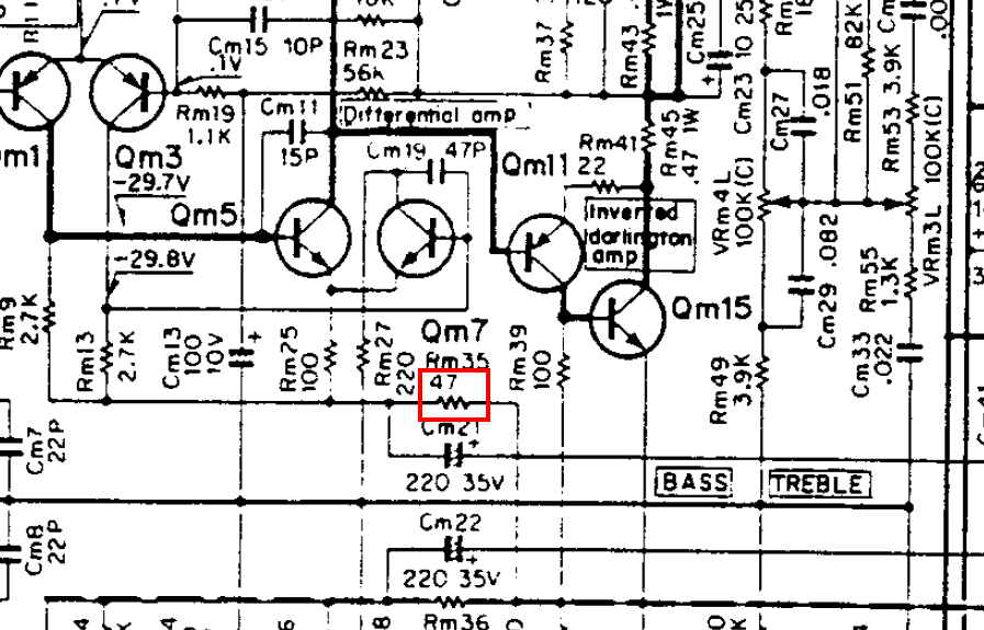

Thank you uncle charly
thanks to uncle charly we also have a schematic from the amplifier
i noticed that the tone control circuit has some kind of feedback from the output of the amp ....i am not familiar with this topology .... seen it also in yamaha amplifier and i dont know much about it
can anybody explain a few things about it ????
Was abandoned, this style of NFB to tone control
It is not used anymore.
I was observing schematic....too much optimistic this value.... it may work if the supply is electronically regulated (stabilized)..this way when voltage drops will modulate the entire amplifier.
Better would be higher value...but cannot be too much increased as it is powering also the VAS.
It seems was not a very good idea.
