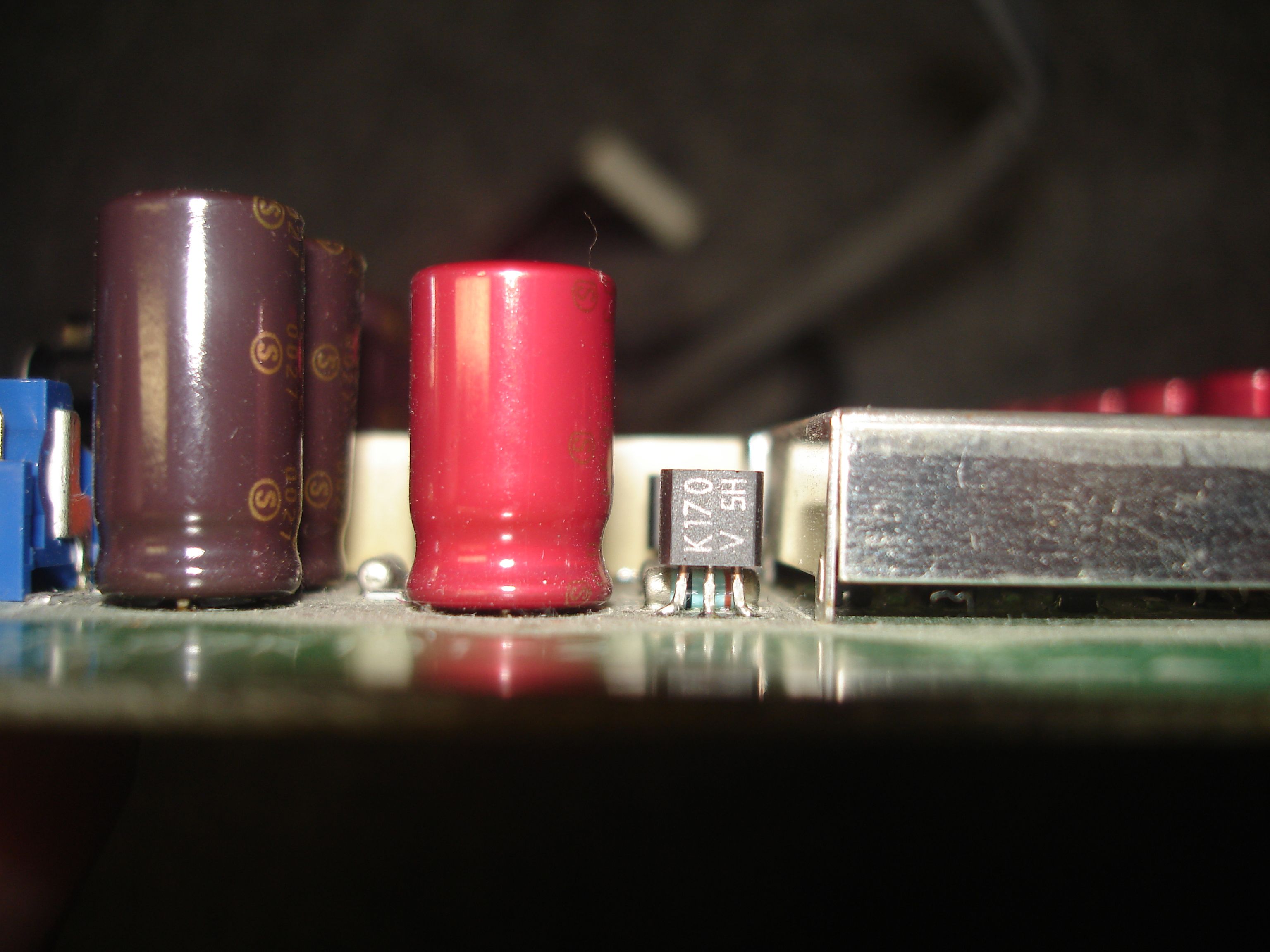

mrdon Member Joined 2005 2011-11-22 3:38 am #1 2011-11-22 3:38 am #1 Can the K170-V be used in the B-1 build? I am assuming it can be just has more mA draw then the BL and GR versions. Attachments K170.jpg 445.2 KB · Views: 321 A AndrewT R.I.P. Joined 2004 2011-11-23 5:04 pm #2 2011-11-23 5:04 pm #2 Yes, but the side effect is that each jFET dissipates more power. They will run hotter. mrdon Member Joined 2005 2011-11-23 5:22 pm #3 2011-11-23 5:22 pm #3 So like super going to fail hot or just hotter? Nelson Pass The one and only Joined 2001 Paid Member 2011-11-25 4:56 am #4 2011-11-25 4:56 am #4 Use BL versions (lower Idss) for constant current source - works great. 😎 Status Not open for further replies. Share: Facebook X (Twitter) LinkedIn Reddit Pinterest Tumblr WhatsApp Email Link
