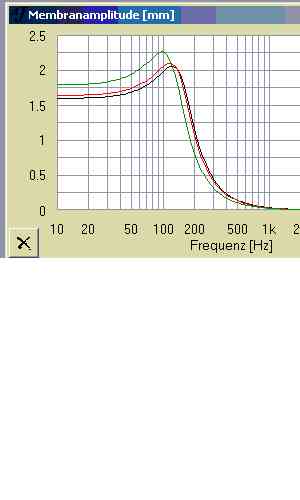

My "old" JX53 was crossed at 250Hz, which was definitely a bit too low. The attached graph shows the membrane activity. (differerent colours represent enclosure sizes 1, 2.6, 4 liters) That problem is the same for the JX6 as it is defined by the size of the membrane. However, the JX6 will be more able to handle frequencies below 300Hz as it has a x-x of 6mm. But for the distortion it will be the same as with the JX53.
Anyway, I understood from your explanations that it is more a matter of testing. Thats what I will do now!
