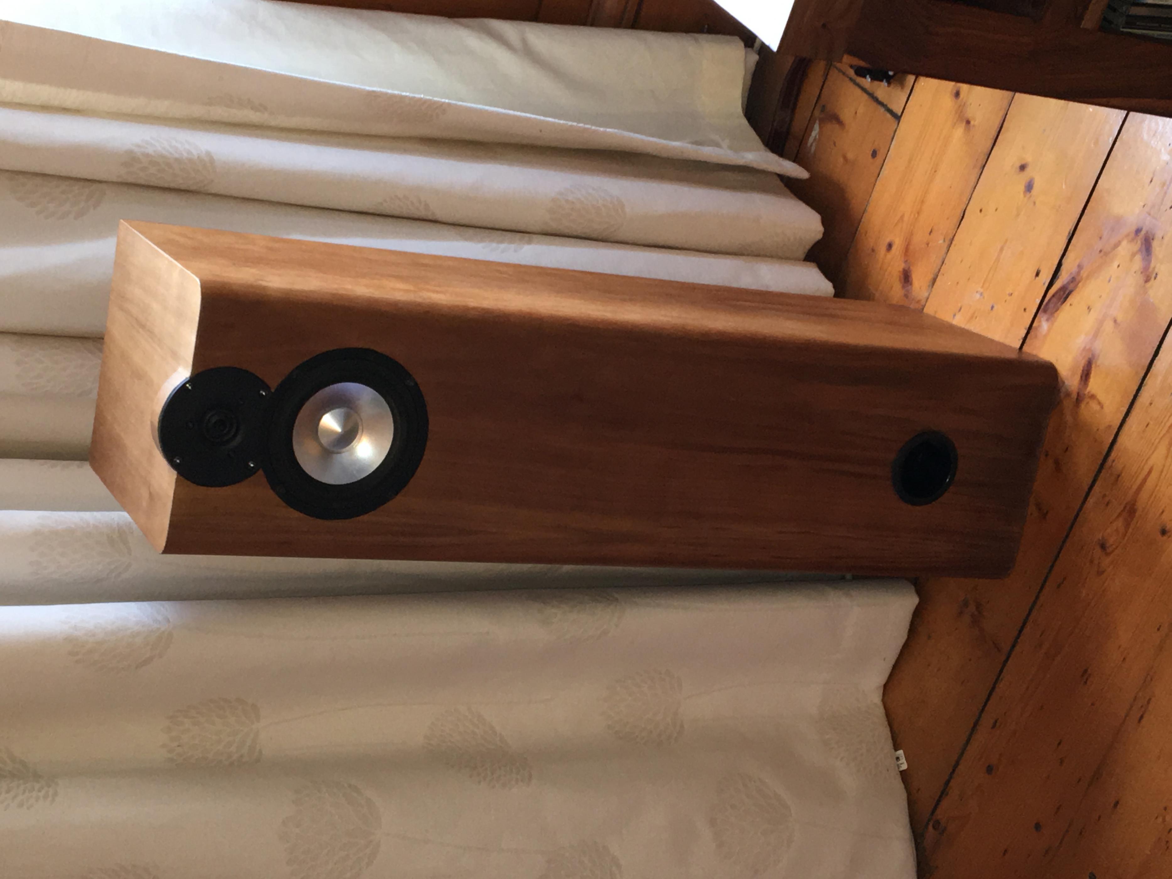

Here’s the speaker

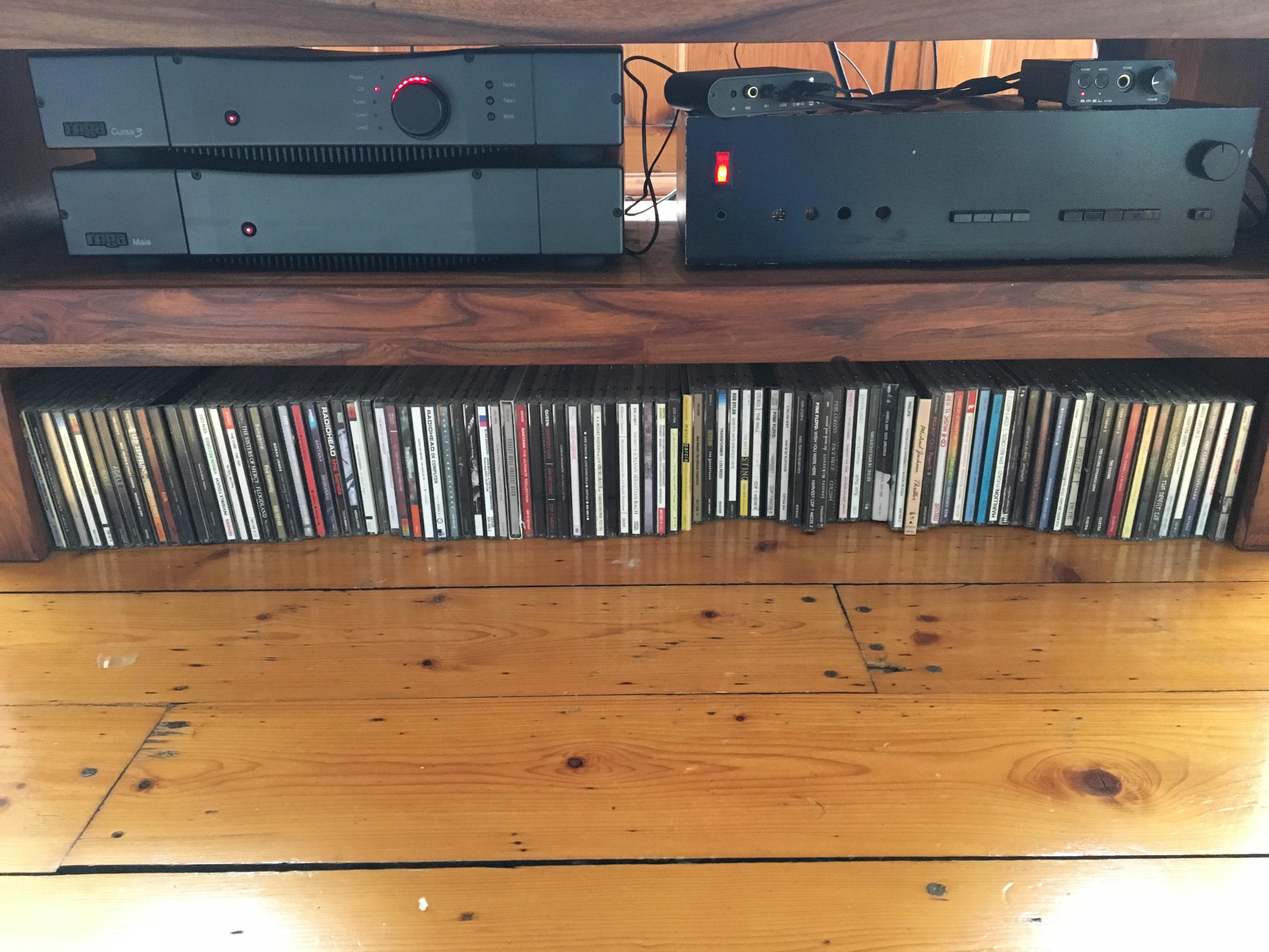

And this is the audio setup, which is the sum total bit of audio kit I have around the house
DACs:
For the tweeter, a SMSL SD-79311
For the woofer, an Anagram D-A
Amps:
For the tweeter, a Rega Cursa 3 and Rega Maia
For the woofer, a homemade classAB mosfet amp
Audio source:
Rega Jupiter (not shown)
Google chrome cast audio

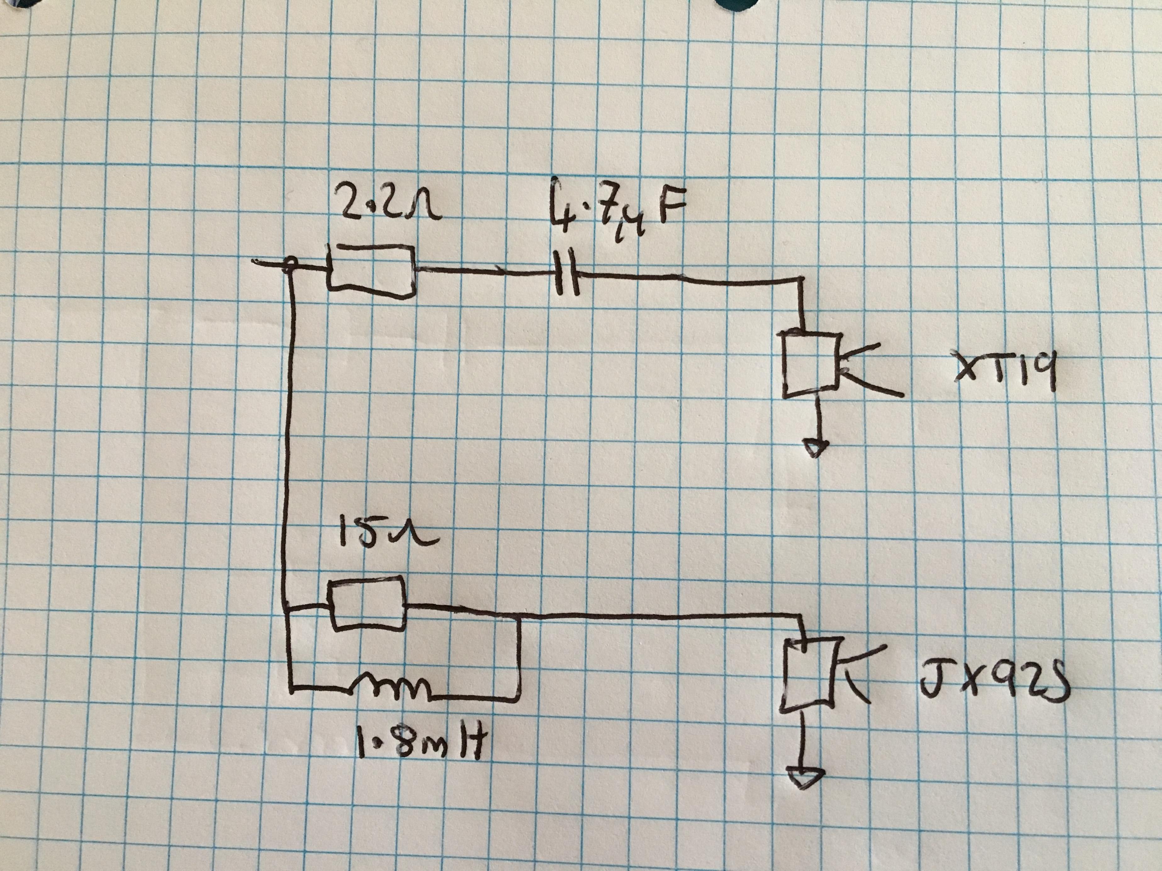

First.... a bit of history.
I’ve tried many many passive crossovers and equalisers with these speakers, including
1. Just the JX, driven straight from the amp
2. Just the JX, with a BSC (inductor // resistor)
3. Third order Xover
4. A “special”
The latter was a first order tweeter xover, and a BSC compensator for the JX.
This was the most successful. I had no measurement gear and adjusted it to sound as close as possible to a Sonos Play:5
The bass section acts as a baffle step compensator, and takes down the treble from the Jx fullrange.
As you can imagine there is a wide overlap between the two units.
I don’t think this is a technically “good” design, but sounds nice in the listening position with the speakers toed in to remove some more of the treble from the Fullrange driver which has a very directional response at high frequencies.
One thing I’ve always noticed is that the design does not sound flat away from the listening position.

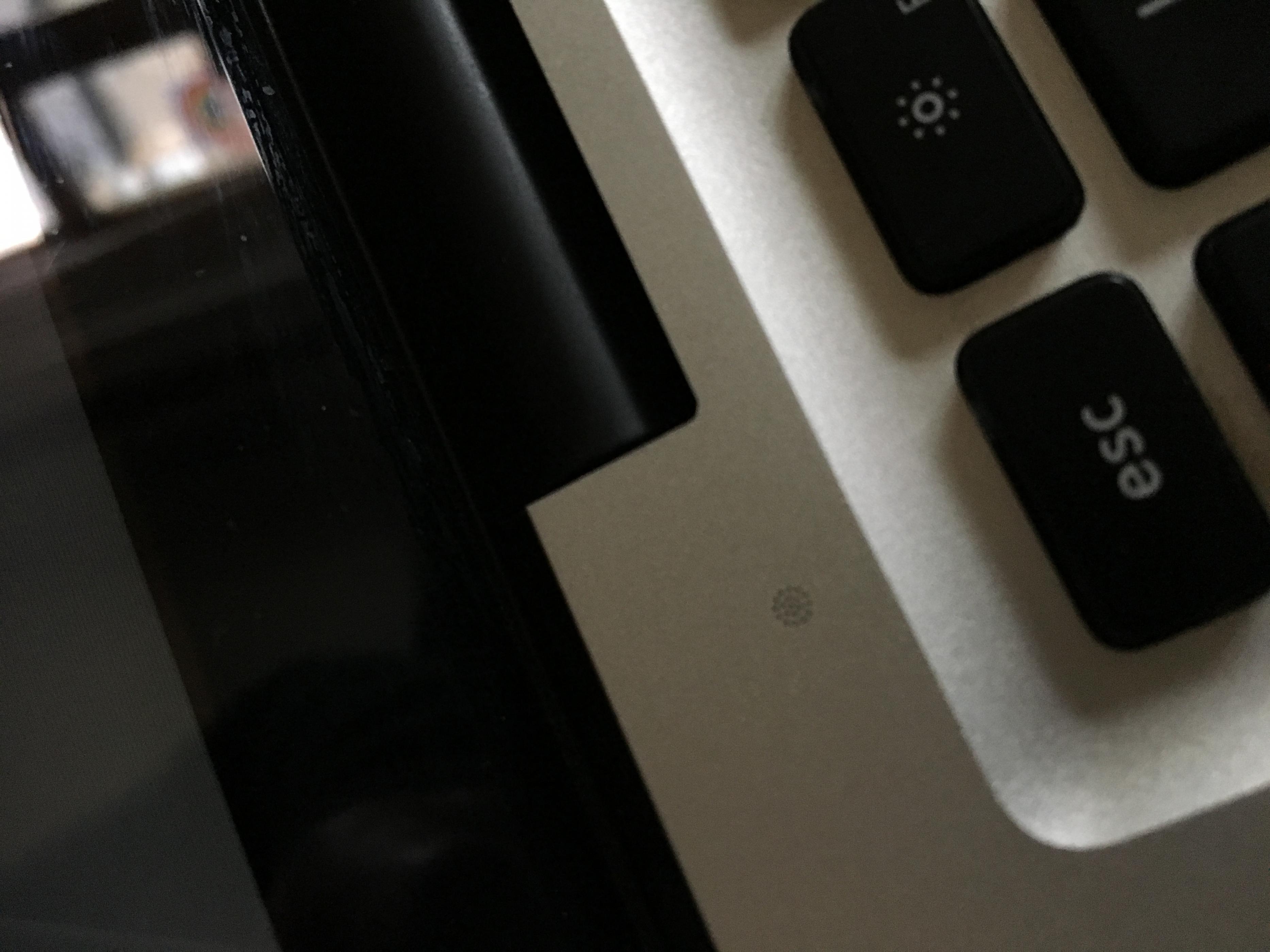

And this little bad boy is going to be my measurement mic.
Before you throw up your hands in horror, I’m using this as a learning experience in loudspeaker measurement before I cough up a hundred quid on a UMIK-1
And I think I can compensate for the response...

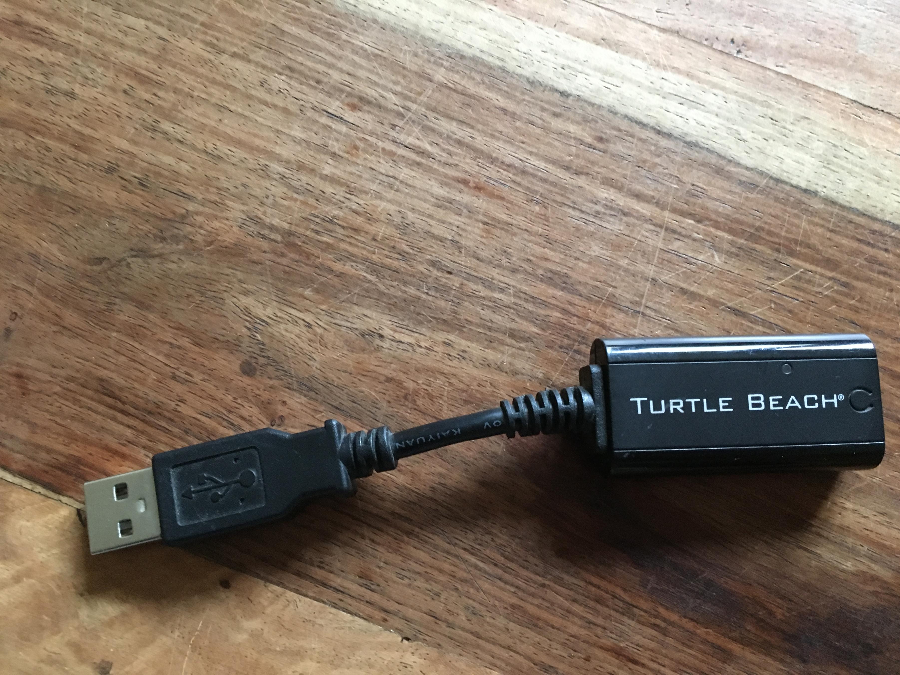

And I’m going to use this as my soundcard, fed straight into the optical input of
the minidsp. This will allow me to compensate for DSP delays, DAC delays (I’m using a different one for the tweeter and woofer and compensate also for anything else in the signal path.

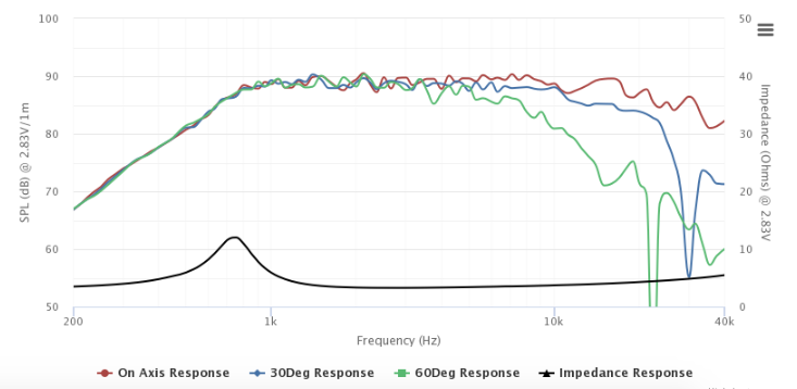

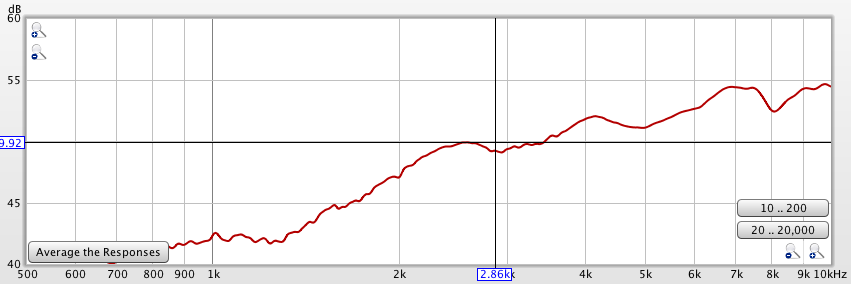

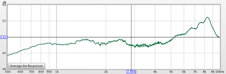

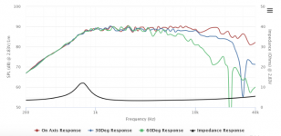

This is the raw tweeter response, measured with a 5ms measurement window
Not a pretty sight, compared to the published response
Some of the slope is due to the measurement window. Here is the response, with 1/12 octave smoothing, no window.

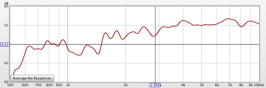

Next the woofer responses, with the 5ms window
and no window, 1/12 octave smoothing
It's hard to separate what we are looking at: the driver responses, room response, microphone response.

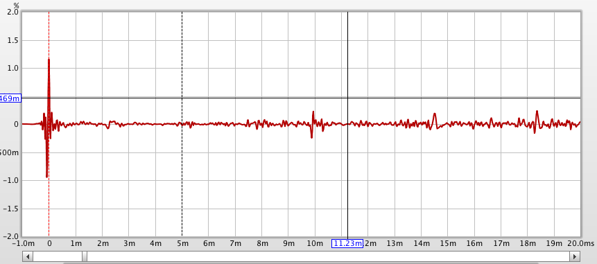

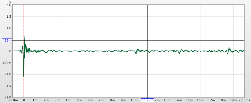

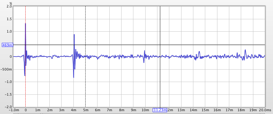

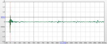

This is the measured impulse response of the tweeter (+cabinet+room+mic...)
and the corresponding woofer
Both show some clear reflections around 10ms and later

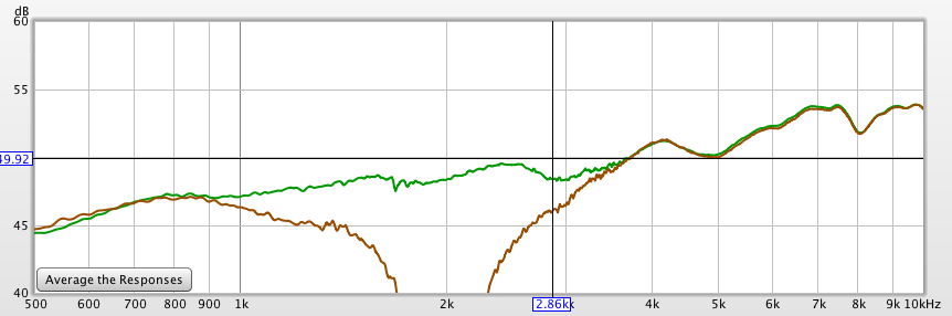

and the combined response (both drivers enabled)
that's interesting...
This is showing a large delay between the two drivers. Each impulse response shows the complete system response, including mini-DSP, DAC, amp.
The first impulse is the tweeter and the second is the woofer. There's over 4ms delay in there, around 174 samples at 44.1kHz sample-rate. Assuming a linear-phase (symmetric) FIR 2FS interpolation filter in the DAC, that's a 700-tap filter!

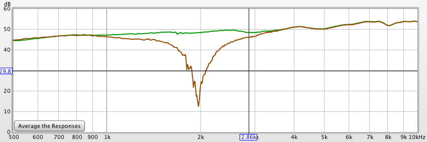

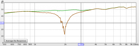

So, first stop on the crossover journey: 2kHz Harsch, inspired by this one
S. Harsch XO
Given the poor microphone response and as yet uncertain room acoustics, I think the best we can do at this stage is focus on the XO region (2kHz). We know both the woofer and tweeter have a relatively flat response in the 2kHz-3kHz region, so if these are matched in amplitude, the response of the microphone will be less important.
The delays and amplitude were tweaked to get a decent null with the polarity of the tweeter inverted

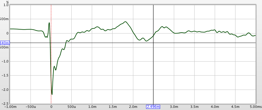

The step response is as follows:
This shows an ok step response (the triangular shape is because the measurement started 500Hz, equivalent to a high-pass filter).
