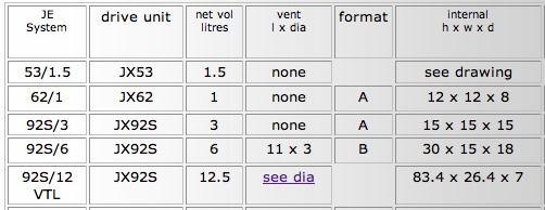

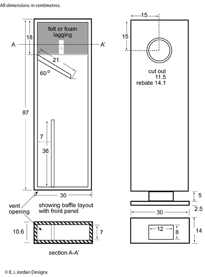

The JX92 VTL enclosure was originally designed so it could be configured as a vented reflex enclosure. See diagram below. Ted also used to have a table of recommended reflex sizes on his site - again I've attached a pic.
The larger of his two reflexes was 12.5 litres - by the time you factor in the volume of the vent and the JX92, this comes to the tall, slim enclosure shown. You could also remodel this to a more traditional shape enclosure if you wanted.
I think the only reason the reflex version of the VTL was taken down was because the TL version was so popular that no one had built it.
The VTL reflex should be tuned to 45Hz. Note that Ted tends to use long, narrow reflex ports, so fitting this into a conventional box shape may be tricky. The VTL is elegant, though.
