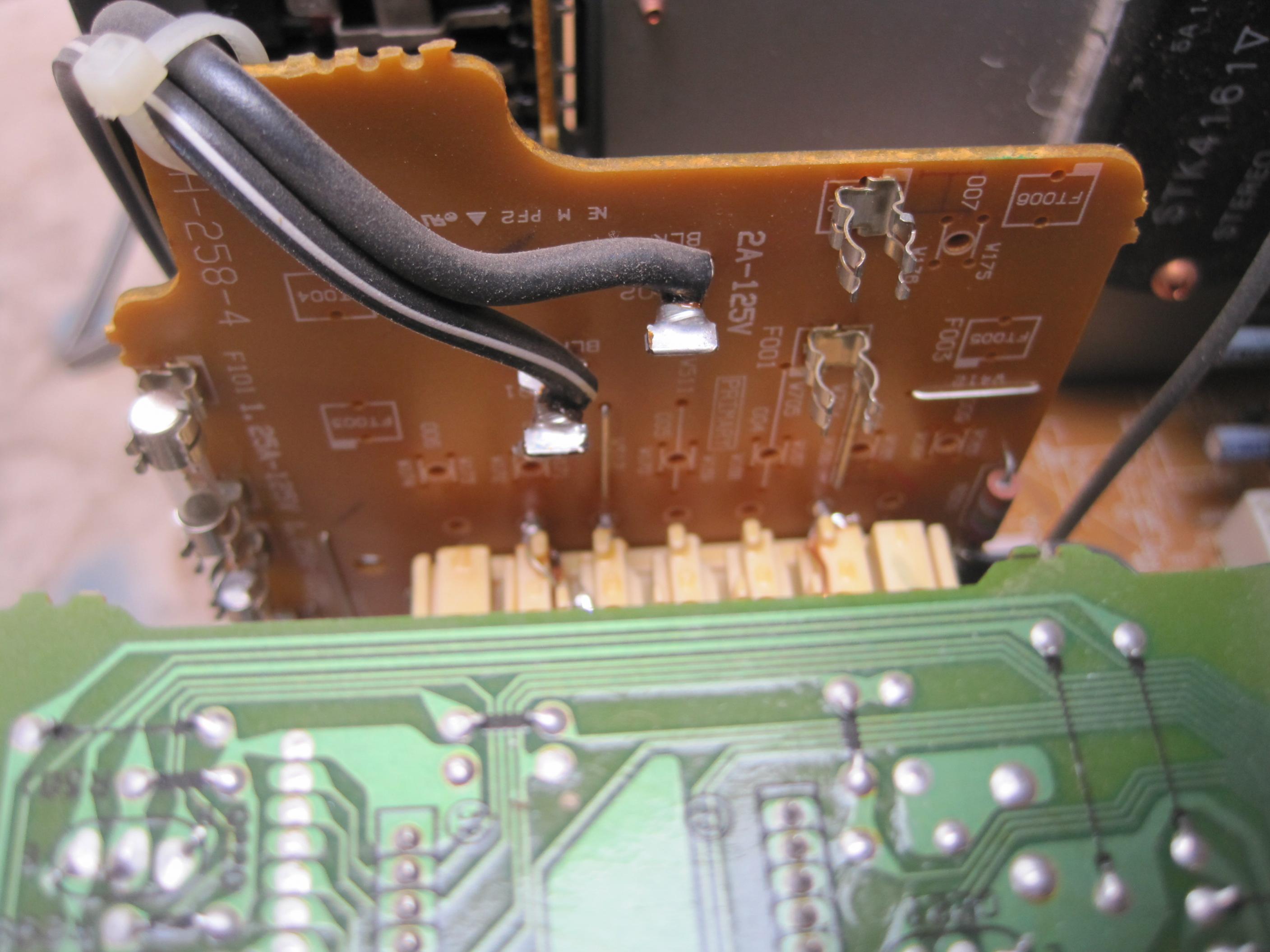

Thanks for the help...I love my house too much to leave the foil in permanently - I just wanted to verify if it was something more than replacing the fuse....I not sure which side of the power supply the fuse in on....it's on the top of the circuit board as a single fuse...there are two additional fuses on the left side as well which are OK...the power supply is pretty easy to remove so I'll start there with the output transistors....any additional suggestions would be appreciated since as I said I haven't done electronics work in 15 years....thanks again, Jim
Hi Jim... you could perhaps post some detailed photos of the internals. It may or may not help... but at least we see what it's like.
If the fuse in the primary side there will be no continuity between live and neutral with it removed.
attached photos of JVC Power supply

Thanks for the pics. It certainly appears to be on the primary side. I assume it goes to the black mains lead.

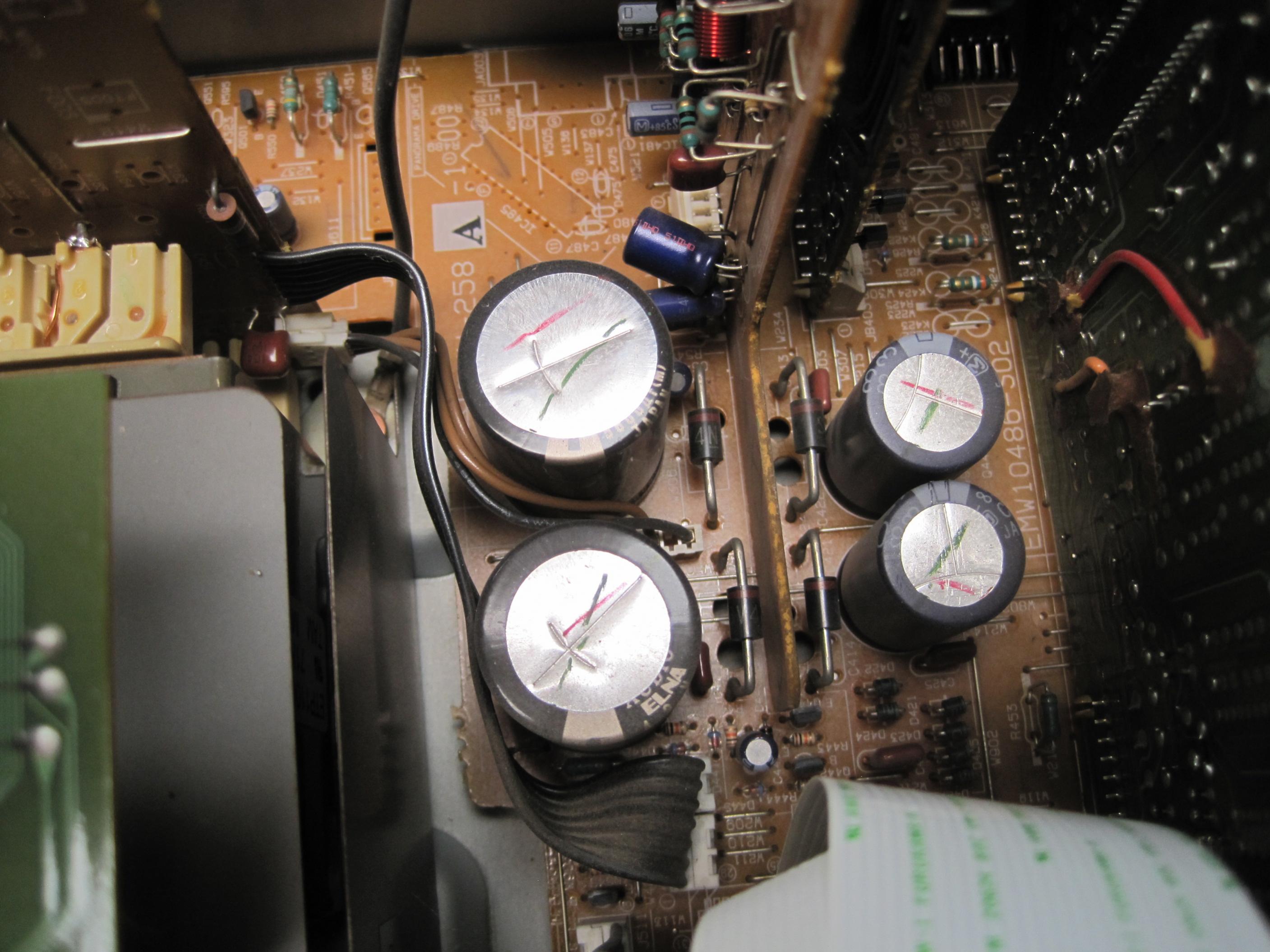

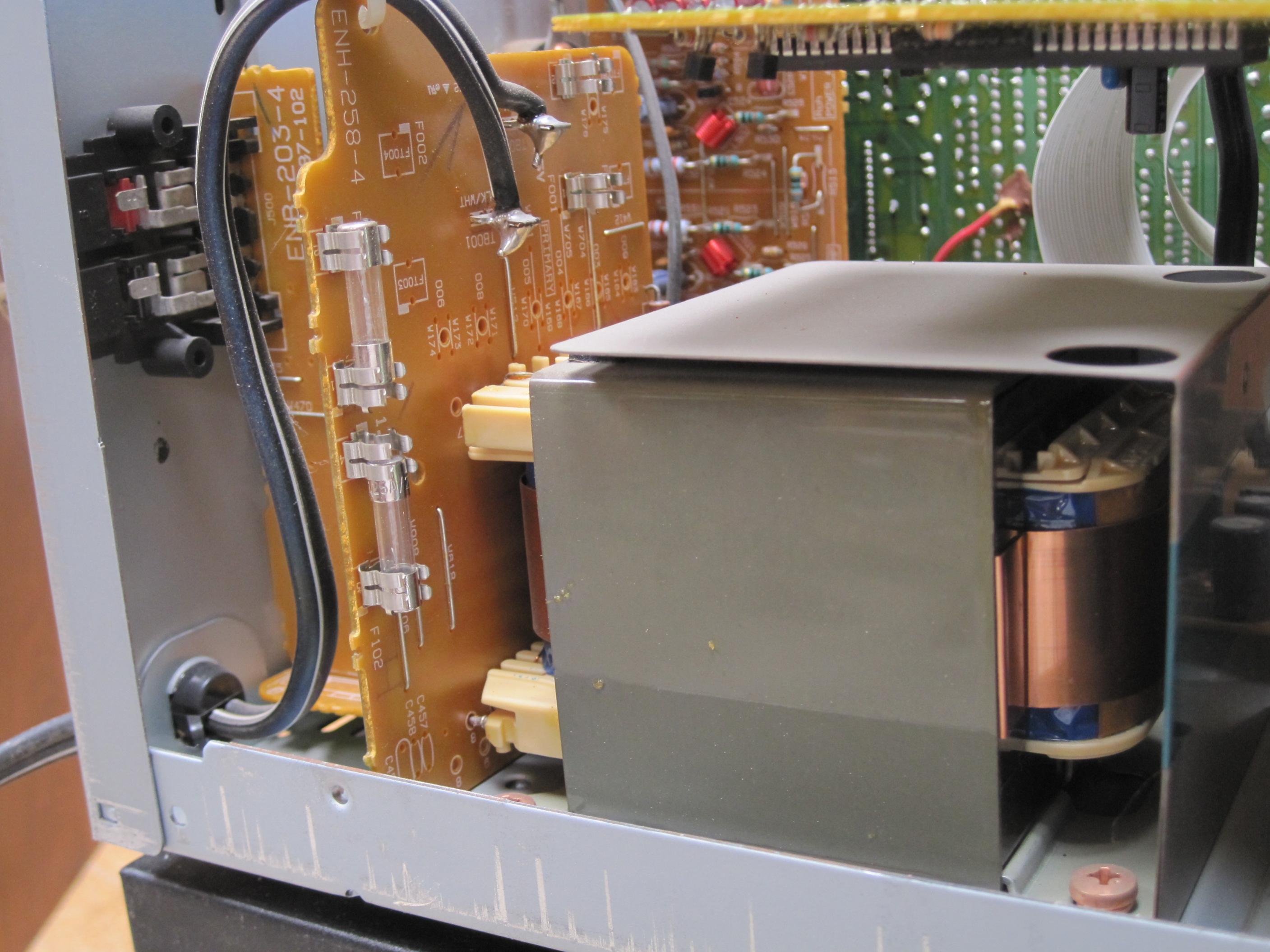

see attached photo, power supply is on the left...

I'm refering to the transformer (tranny).
Your photo above show what would normally be called the "power supply" (PSU). This is all fed from the low voltage secondary side of the transformer and has no direct connection to the mains.
In a unit like this it's common for the transformer to have several secondary windings that are used to provide different voltage rails within the equipment.
If you look at the board with the three fuses on it I think you will find that all the connections on the "top" of the transformer are on the primary or live side. This will connect via the fuse that has blown to the mains lead.
All the connections at the bottom of the transformer are the secondary windings that feed into the unit. I think you will find that the two other fuses connect to some of these windings.
Transformers usually have primary and secondary windings (the pins or leads) at opposing ends. They are never mixed together.
So the power supply in this unit in a way is "divided up". There is the main rails that feed the power amp stages and so on. This will be the windings that feed those four large diodes and two large capacitors. There are also other supplies though... look at all those smaller diodes and te smaller capacitors in the PSU. They will be lower voltage rails that feed the system control/standby circuitry etc and are derived from other windings on the transformer.
