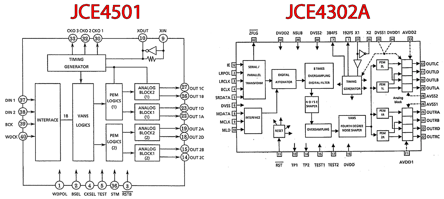

JCE4302a is a DAC with 8 times filtering inside. JCE4301a doesn’t. It must be preceded by one. For example, ym3414 filter chip, JCE4300 is a pure K2 processing chip. Filter chip, without any 4 times 8 times filter. Just pure K2 processing

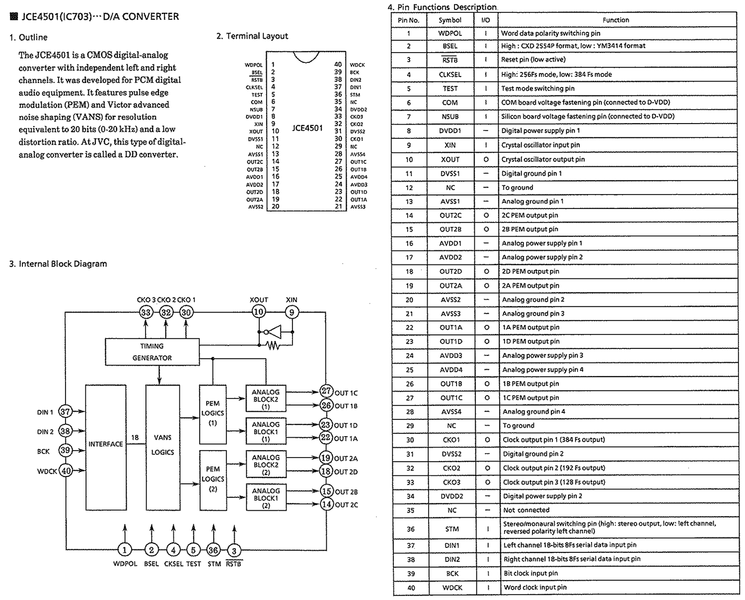

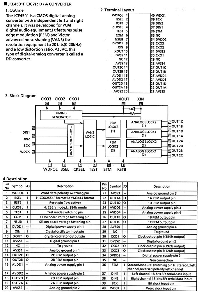

All shall become clear I hope! First, here's the attachments that wouldn't load last night, giving more in-depth details:

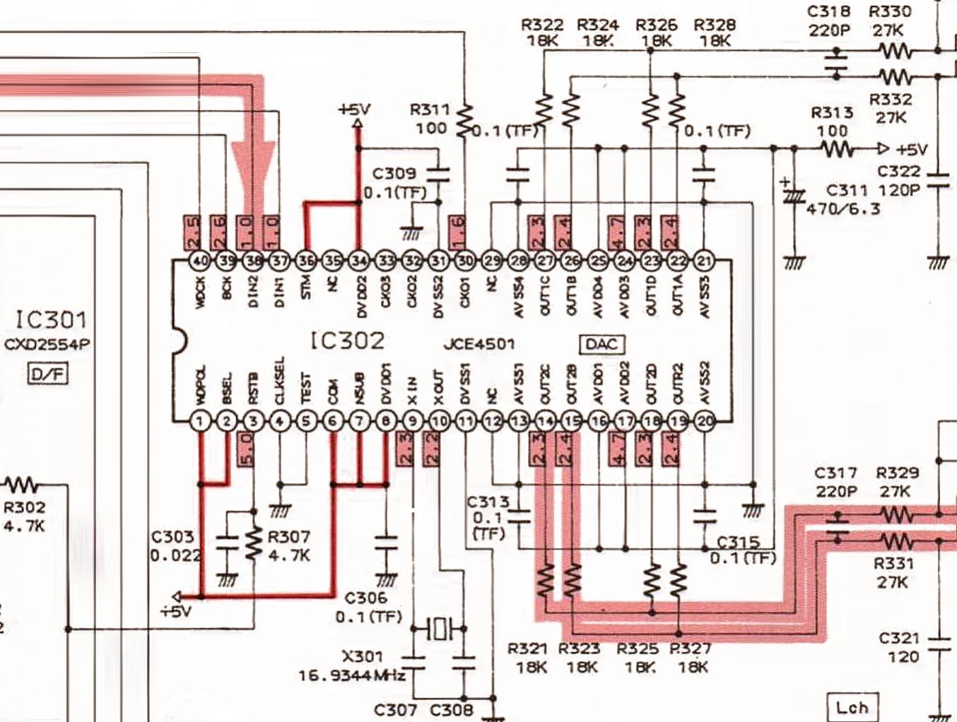

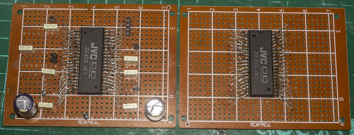

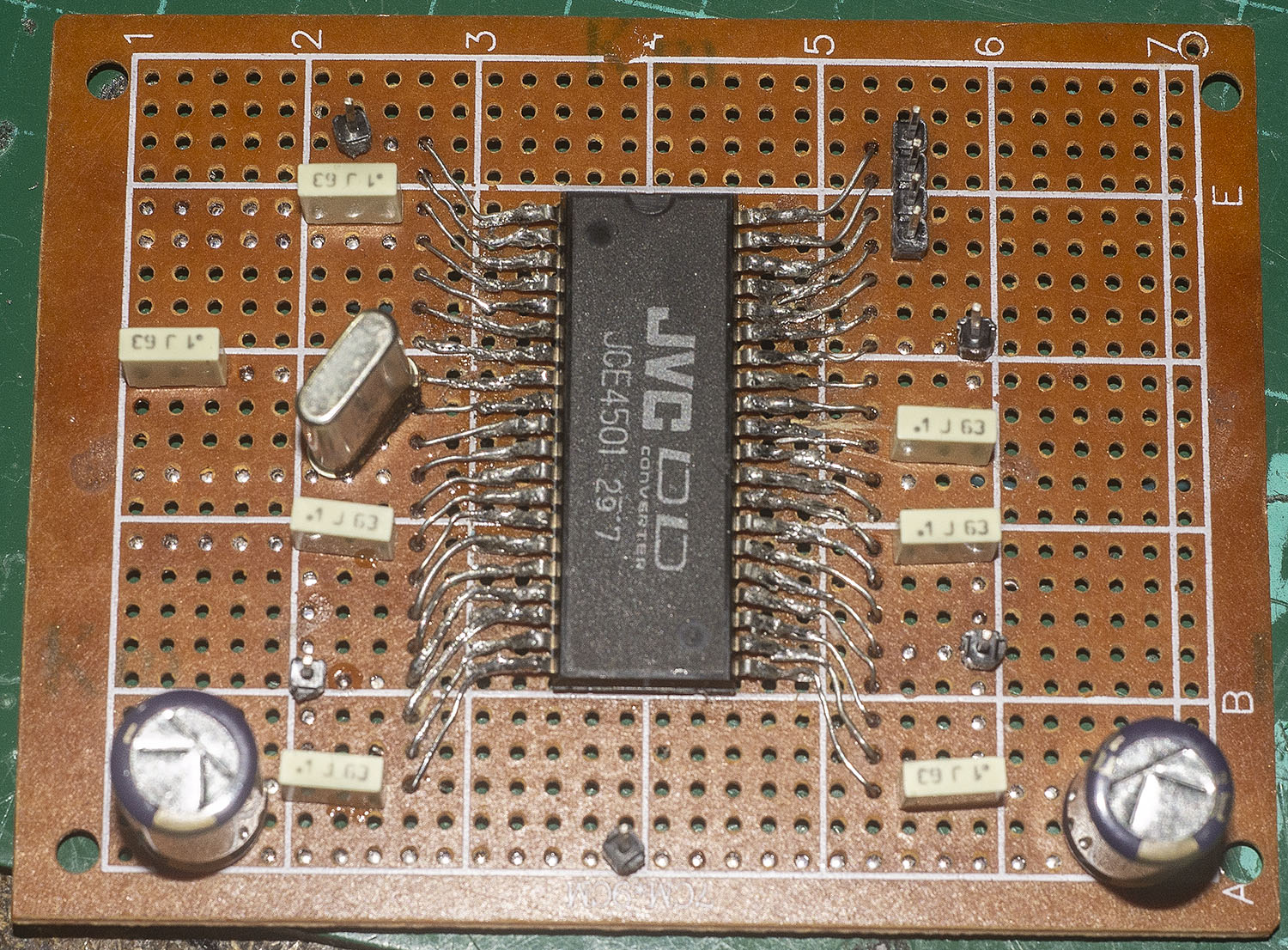

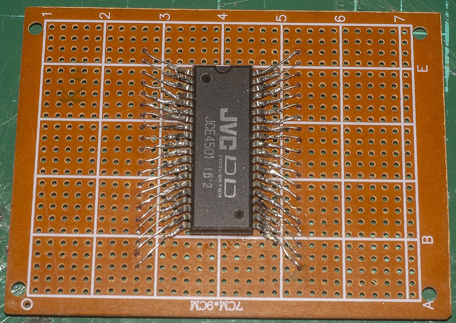

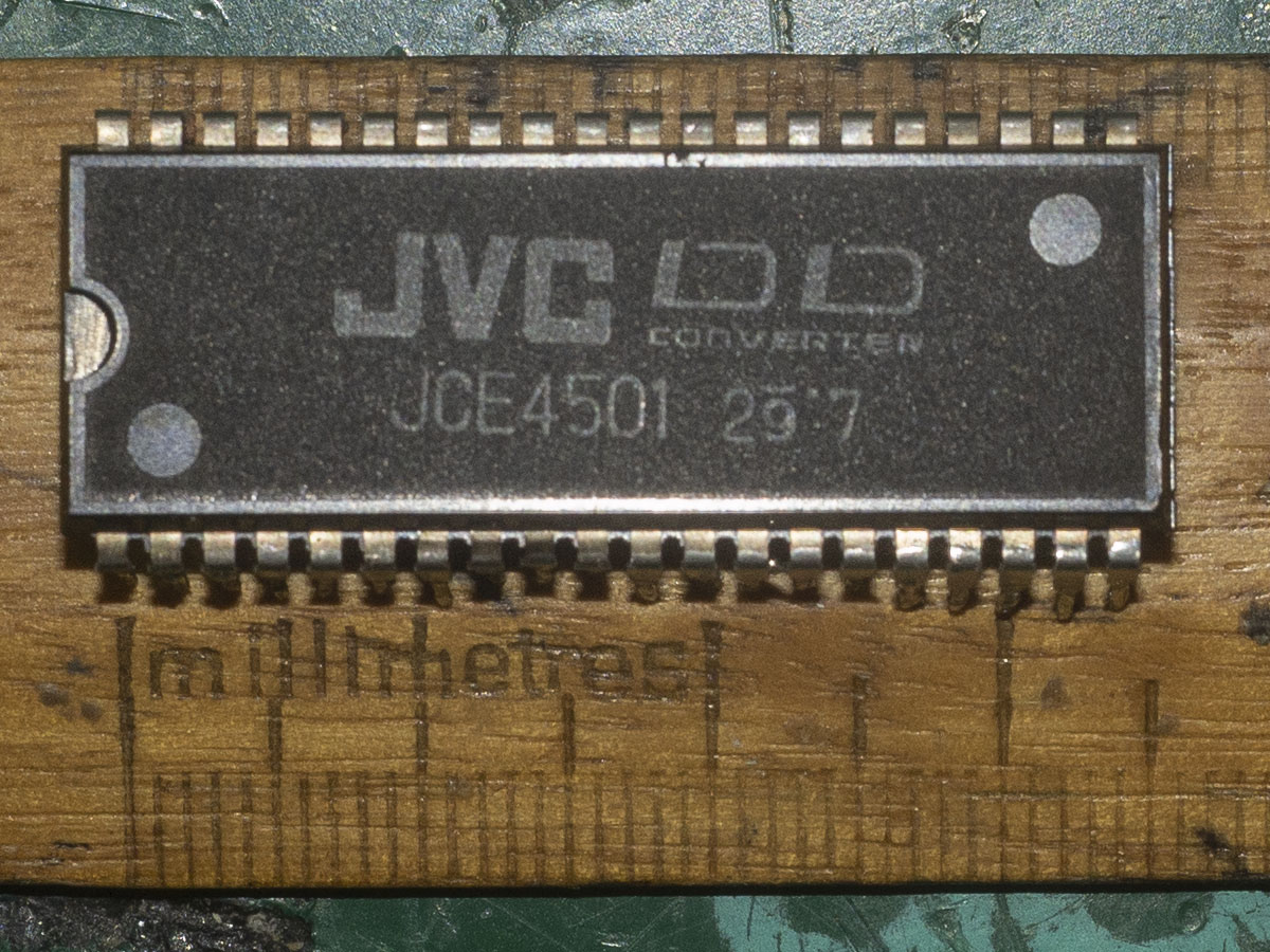

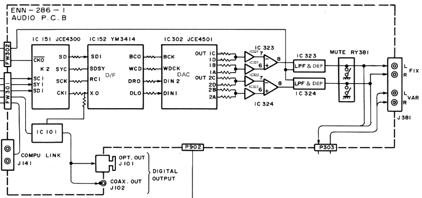

Now hopefully the interesting bit - I happen to have not one, but two JCE4501 chips. I searched in vain for adapter PCBs to fit them so ended up using a fairly novel method to mount them to a PCB by flattening the legs and soldering thin wires to each.

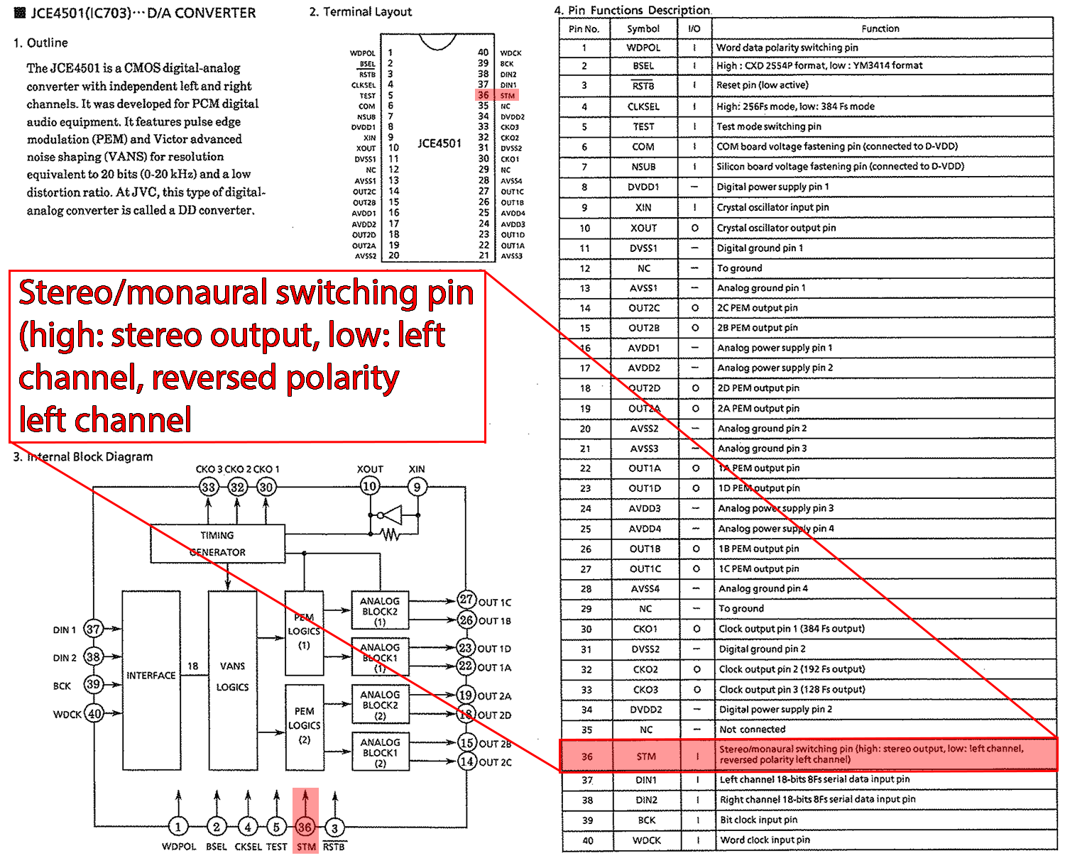

The datasheet shows that there is a pin that when left unconnected, puts the chip into mono mode, so I should be able to use both chips together to make a stereo DAC, something I don't think JVC ever did as even their top end players appear to only have had a single chip.

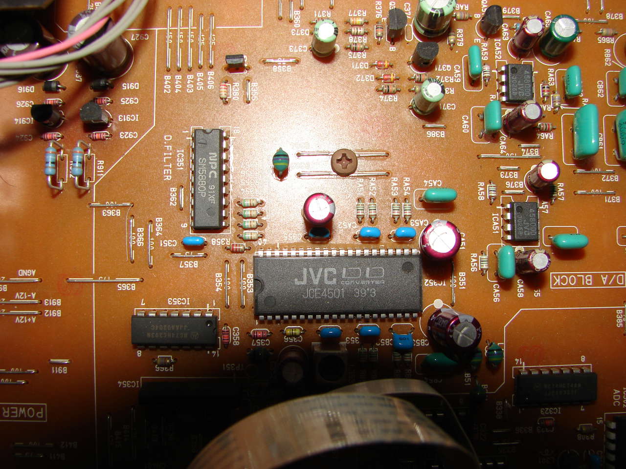

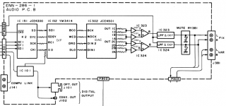

I've copied the wiring from the JVC service manuals - they made loads of players with almost identical PCBs, the digital and analogue sides of the chip are fed separately by +5V supplies. For the digital front end and analgoue output circuits, I will have to devise new circuits rather than copy what JVC did in order to get the best out of these chips. I'm thinking a nice discrete I/V converter would work well with these, not sure what chips will work as digital filters, the Yamaha YM3414 and Sony CXD2554P are both supported, and some of the better JVC players used the SM5840DP, but I'm thinking that I should be able to use a more modern chip.

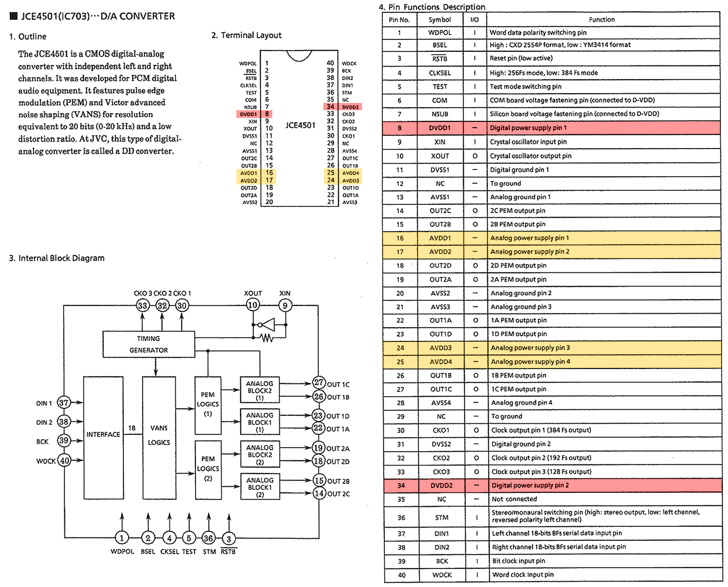

The datasheet states that the inputs (it has two) of the JCE4501 are 18-bit 8fs serial. I take this means that this chip has to be used with a digital filter that is capable of 18-bits and 8x oversampling - can output 384Fs clock rate?
I know the the Yamaha YM3414 and Sony CXD2554P are both supported, and the SM5840DP, but those are all old chips and I keep reading that their performance is much worse than the modern equivalents, the YM3414 for instance, is said to be jittery.
So what I need to know is what other options I have for digital filters that will work in this application? Should I be looking at sample rate converters like the AK4125, AD1896 and CS4322?
