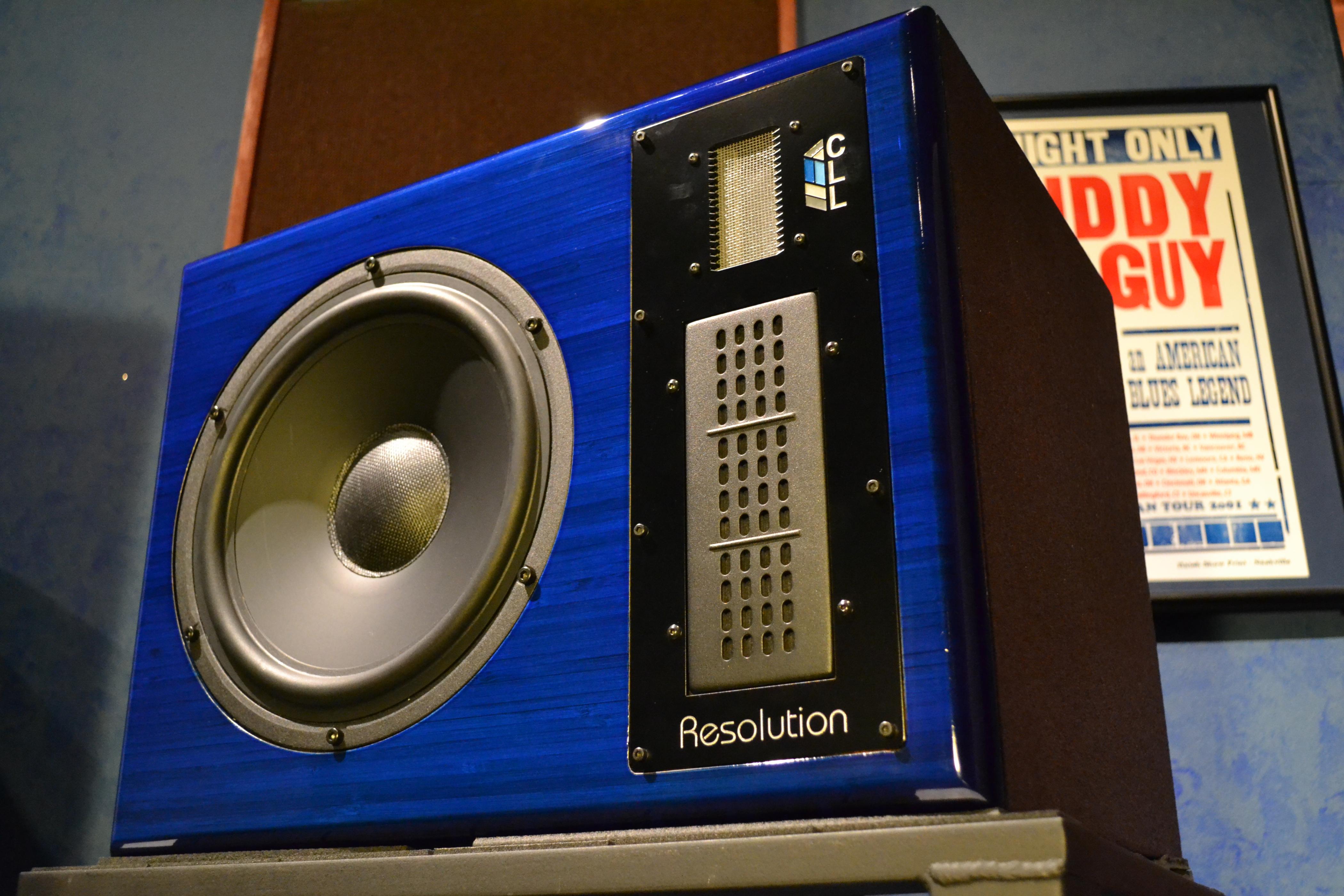

Note that dipole speakers have really different sound dispersion pattern compared to normal box speakers (like most studio monitors). You can't place them close to a back wall, and ideally you should dampen/diffuse the back wave. Also if you sit really close to the speakers you probably want a small speaker.
One option is box speakers with AMT drivers and dynamic mids/woofers (similar to ADAM's studio monitors). AMT's have really low distortion and linear phase. However you might need a DSP to flatten the frequency response.
