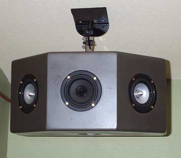

I used BDSC networks in my Tangband speakers and it does make a huge difference. I also noticed a difference wiring the resistor and inductor parallel rather than series. When it came to the surrounds however, I decided to skip it. I think with the configuration of drivers, the type of drivers and the bottom firing port I managed to minimize the effect.
The center driver is a W3-879 which doesn't have the top end the two W3-871s do.
