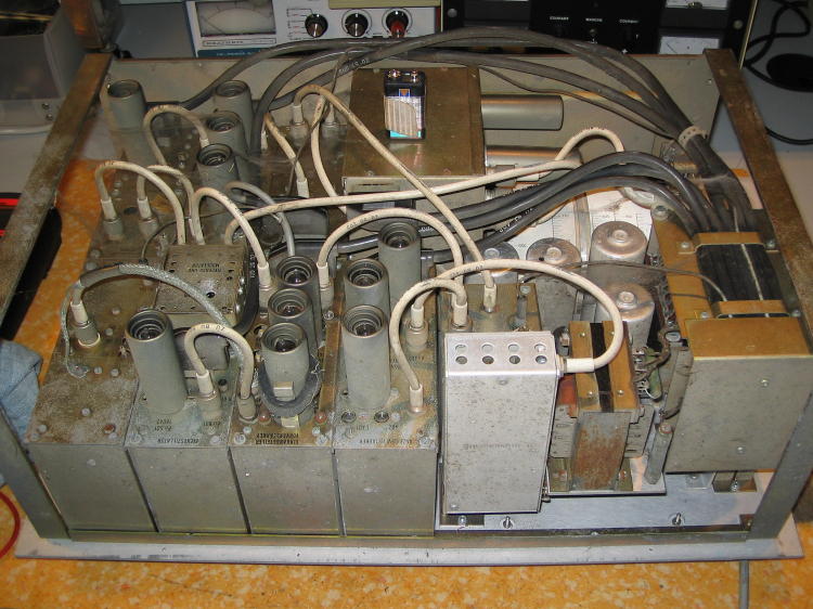

I had a look inside the beast, now I understand why it was so heavy !
Every stage has his own shieldied case, there plenty (13) of "18042" tubes that are unknown from me
and a 85A2.
Here are two links from Frank Philipse for the 18042 data :
http://www.mif.pg.gda.pl/homepages/frank/sheets/009/1/18042.pdf
http://www.mif.pg.gda.pl/homepages/frank/sheets/030/1/18042.pdf
Does someone know the 18042 ??? I have no spares nor data to test them (tester).
They are made from Valvo & look like an EF80-EF86 (noval too). Aside the tester look from the sixties, at the tip of the end of tube era, I shot a picture, so I late you estimate(there is a 9V battery for size comparison).
Please help.

I love old boat anchors like that. “Boat anchor” may not translate well into French, but it’s a endearing term for large, heavy, old tube equipment. I have no information on this unit, but I doubt that a carrier frequency level meter will be of much use for audio - especially since it will likely require a lot of refurbishment. I have tons (literally) of old test equipment of similar vintage in a spare workshop room. The value of most of this equipment is in the salvaging of the parts. In particular, I look for magnetics (transformers and chokes, often hermetically sealed) and tubes. I don’t see a much magnetic mass in your photo, but maybe it’s hidden from view. I don’t know about those Valvo pentodes, but the specs look hopeful for audio with decently high gm and moderate mu if triode connected. Worth a try!

18042 are somewhat similar to the EF80 except for a slightly higher gm and 18V filament. IIRC these were extensively used by many old german telephone exchanges.
Wandel & Golterman is a very respected manufacturer of various communications related measuring equipment - the company still exists and is doing well.

I firstly, just wonder if the electrolytic caps are all sitted near the PT (at right), then I'll just reform them and fire up, or if they are some of them hidden is the shield ?
It also got a selenium rectifier, I don't like them much, and have no procedure to test them or replace them (the metrix 746A VTVM got also two Sel. Rect. also, and I would like to restore it as I have no VTVM yet, and it seems to be the finest I saw for now, very nice piece from 66' (5tubes 2nuvistors)here's a picture, I forget a scale reference, but it's big, look at the front "antenna connector" & banana at low right)
