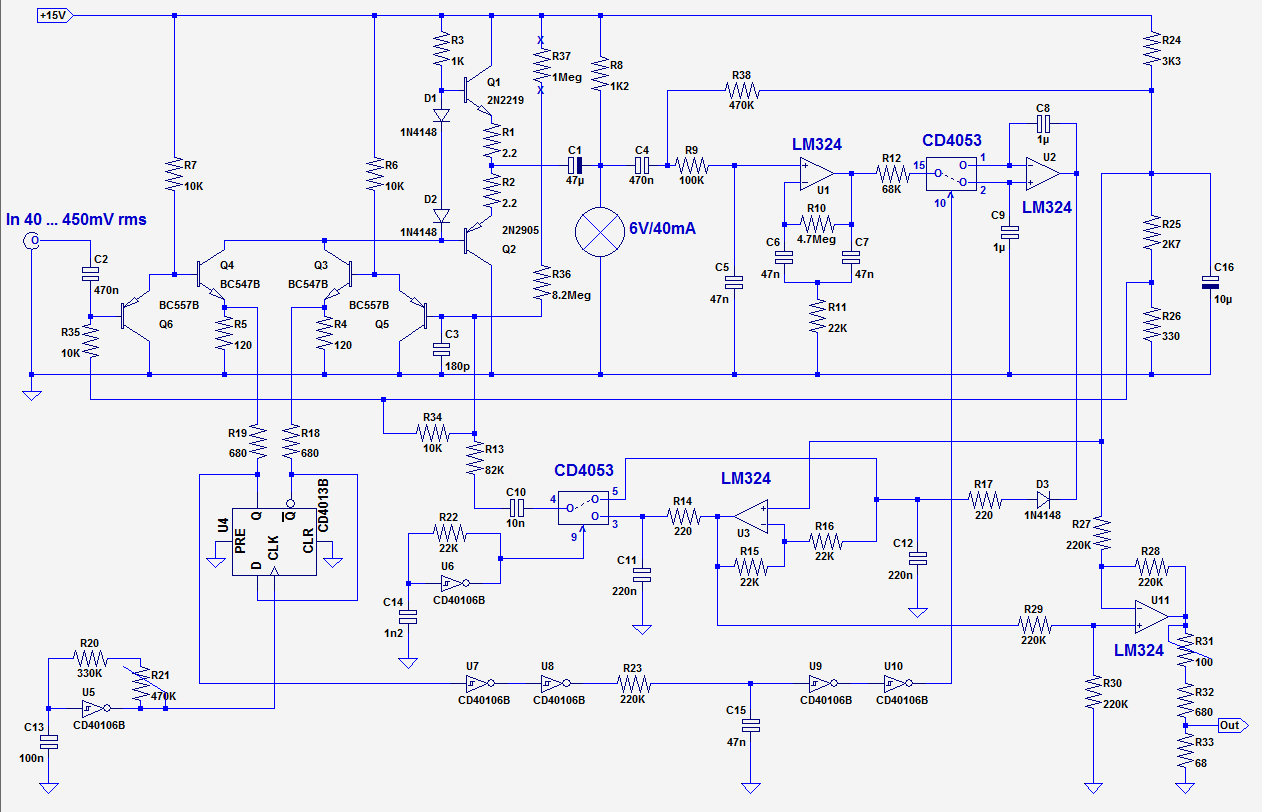

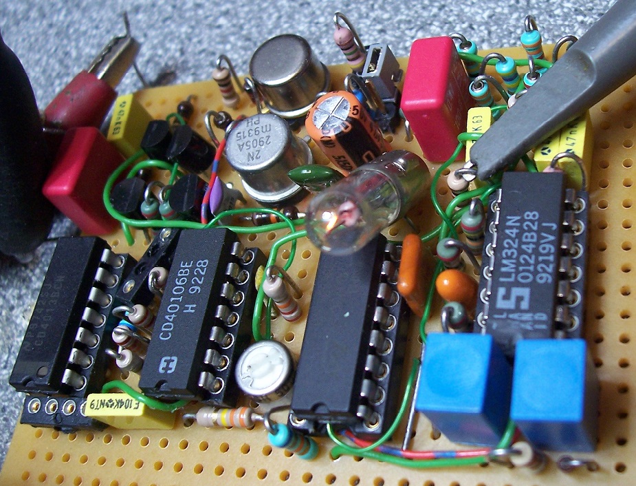

Here is another one: a (really working) RMS to DC converter.
It works by comparing the resistance of the lamp for two signals: the one to be measured, and an internally generated one.
A servo then attempts to minimize the difference.
When the equilibrium is reached, the amplitude of the synthetic signal accurately represents the rms value of the input.
It is a true thermal converter, meaning it can accept any peak factor or frequency without error. The only errors will be caused by the electronics around the lamp.
The technique of alternating measurements allows the use of single lamp, which is by definition matched with itself.
If one accepts the constraint of matched lamps, simpler electronics will result.
Here, the alternating signal is generated by U5 and U4 and has a frequency of 10Hz. This value is probably not optimal, it is an educated guess, but it works well enough for this proof of concept.
Q3 to Q6 form the alternating switch feeding the power amplifier Q1 Q2 driving the lightbulb, a 6V 40mA pilot.
Why these characteristics? It is low power and low voltage, yet robust enough, and I had it available.
It is DC-biased by R8 to measure its resistance, and the resulting 10Hz signal is extracted by U1 and synchronously demodulated by the 4053 and U2.
The resulting DC is then remodulated at ~50KHz by U3 and the other 4053.
This DC is also level-shifted by U11 to reference it to the ground and be used as the final output.
R23/C15 adapt the delay of the demodulator's reference, to compensate for the phase-shift introduced by the thermal inertia of the lamp.

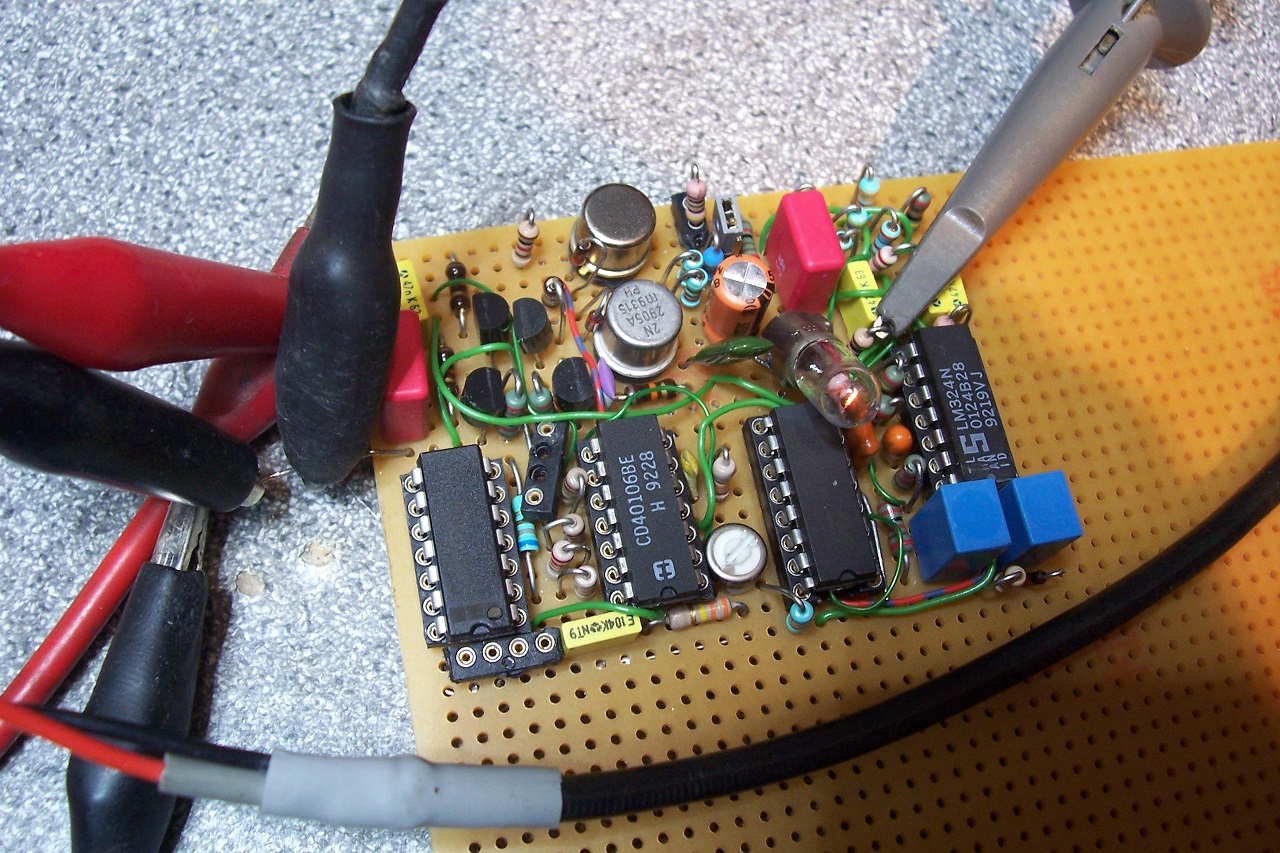

The whole circuit is pretty crude and simplified, with a single supply, unmatched and non thermally-coupled input transistors, commodity IC's, yet it actually works rather well: it is usable from 150~200Hz to 10MHz (below 150Hz, the beats between the 10Hz and the input make it unusable and the upper limit results from the rudimentary amplifier), and the dynamic range extends from 40 to 450mV, one decade.
With some care, better optimization and components, two decades are probably within reach.
Note that the switch could be different: reed relays, PIN diodes, etc.
Of course, to make it into a real instrument, it would also require a proper input amplifier and step attenuator.

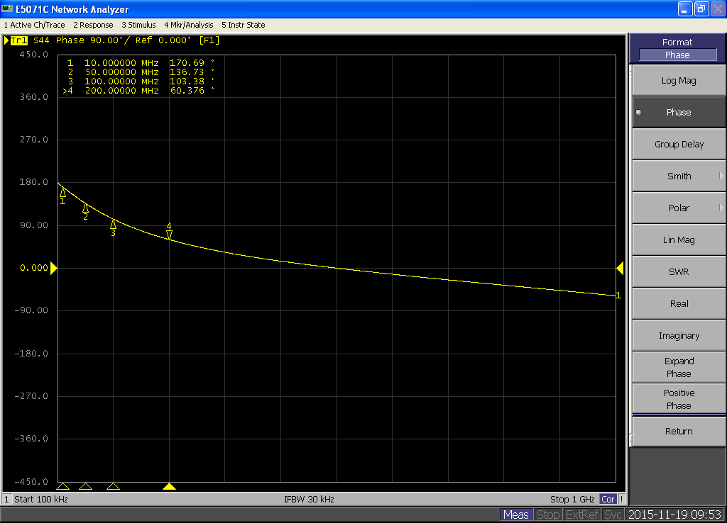

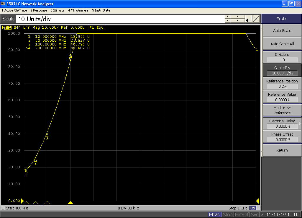

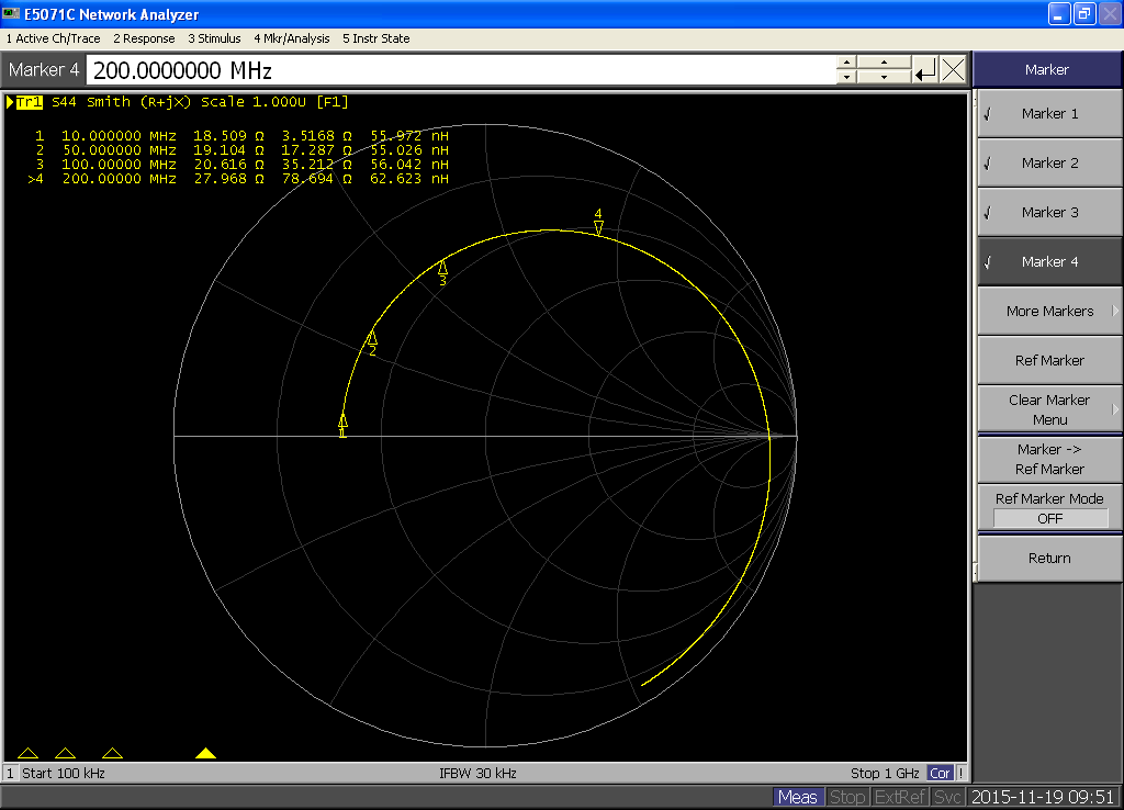

At a metrological level (where thermal converters are mostly used today), many more effects come into play; inductance, capacitance and skin effect of the lamp limit uncertainty at high frequencies. At low frequencies it's mostly the finite thermal time constant.
Yes, see the impedance curves below for this particular bulb:
First, the Smith chart: the equivalent inductance is ~55nH, of which 5nH is uncompensated test fixture.
Then the magnitude and phase: up to ~50MHz, the response could be corrected relatively easily. 100MHz would be reachable with some efforts.
For best HF performance, the voltage of the lamp should be as low as possible: if I had used a 1.5V/40mA bulb instead of the 6V, the inductance would have mechanically been reduced by a factor of ~4
