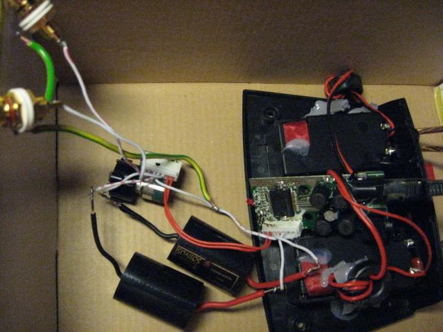

Congrats nukegoat! Not to hijack your thread, but I finished the same project few hours ago and thought this thread would be appropriate place to post my experiences also. I hope you're ok with that?
I used Soniqs SAX caps and just quickly put everything together in... a shoebox. Looks dangerous and quite out-of-place on top of my Rogue Audio tube pre-amp. 😀 But the bass is finally there, and my set-up sounds sweeter than ever!
I had similar experience with bridging C3/C4. The first one was pure luck, somehow managed to splash just the right amount of solder around there, but the next one was trickier. So I used the wrap wire method (which I will also be using with the next amp). Way easier.
My previous experience with using a soldering iron is from 7-8 years back when I was moving around the little resistors on an AMD Athlon CPU. So.. it was hard, but I'd imagine most people familiar with the basic concepts of using a soldering iron should be able to do it. If uncertain, practise with an old sound card for example.
Some people may find the attached picture shocking, so click at your own risk! My excuse it that this was just a quick hack to see if I can do this or not. I have another t-amp waiting, it will get all the connectors, new wiring and I will remove the volume pot (as I'm using it as a power amp) and add a power switch, new casing. After that the shoebox amp will get the same treatment.
Last, I'd also like thank everyone who has made modding of t-amp possible for novices like me, especially forum member Panomaniac.
