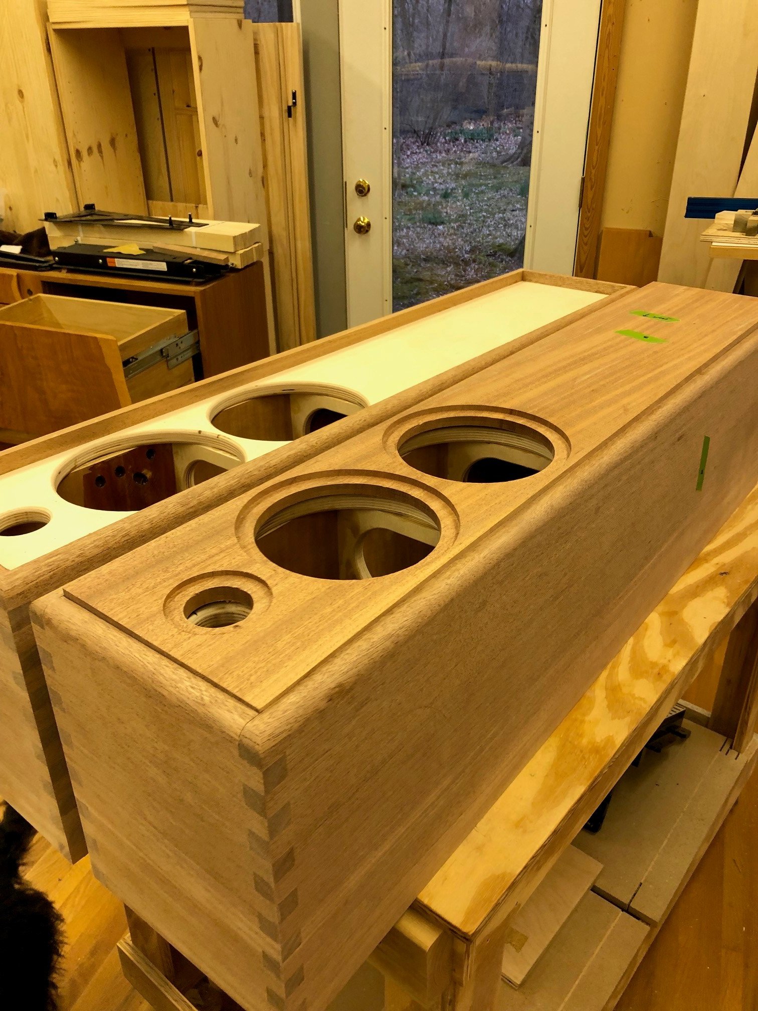

We used kiln-dried quartersawn African mahogany in sufficient board widths to avoid main panel glue-ups.
We planed and jointed all boards to ensure uniformity and good fits.
We cut box joints to join the tops and bottoms with the sides.
We mounted the back panel in a rabbet.

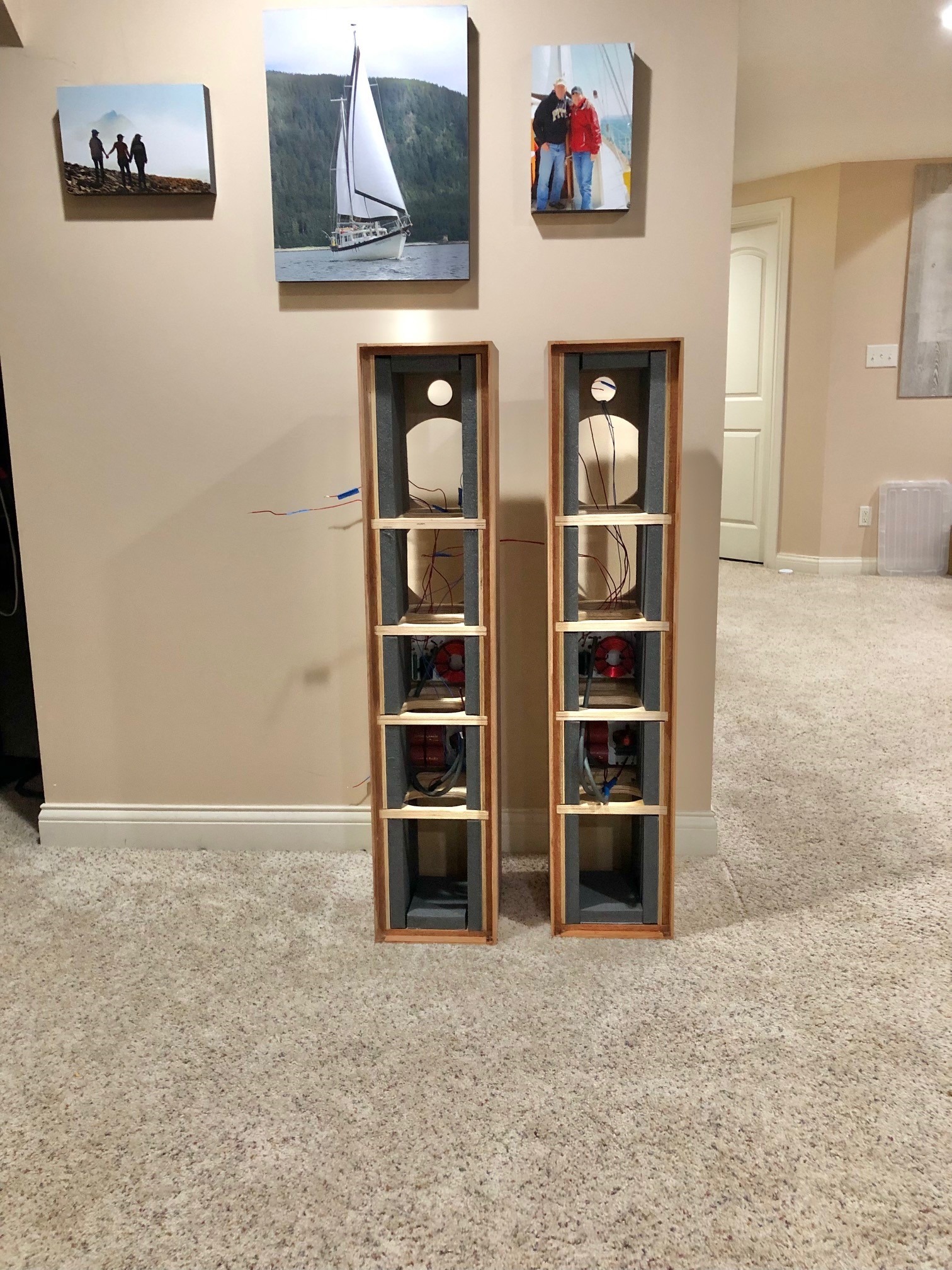

We installed a 18mm Baltic birch inner baffle in a dado behind the front mahogany baffle.
We glued and screwed the front mahogany baffle to the inner ply baffle, setting it in the recess between the side panels, tops, and bottoms.
We used 18mm Baltic birch for the interior braces
We routed a 2” radius roundover on the top, bottom, and side edges of the front baffle.
We lined the cabinet side walls with GR-Research’s No Rez foam.

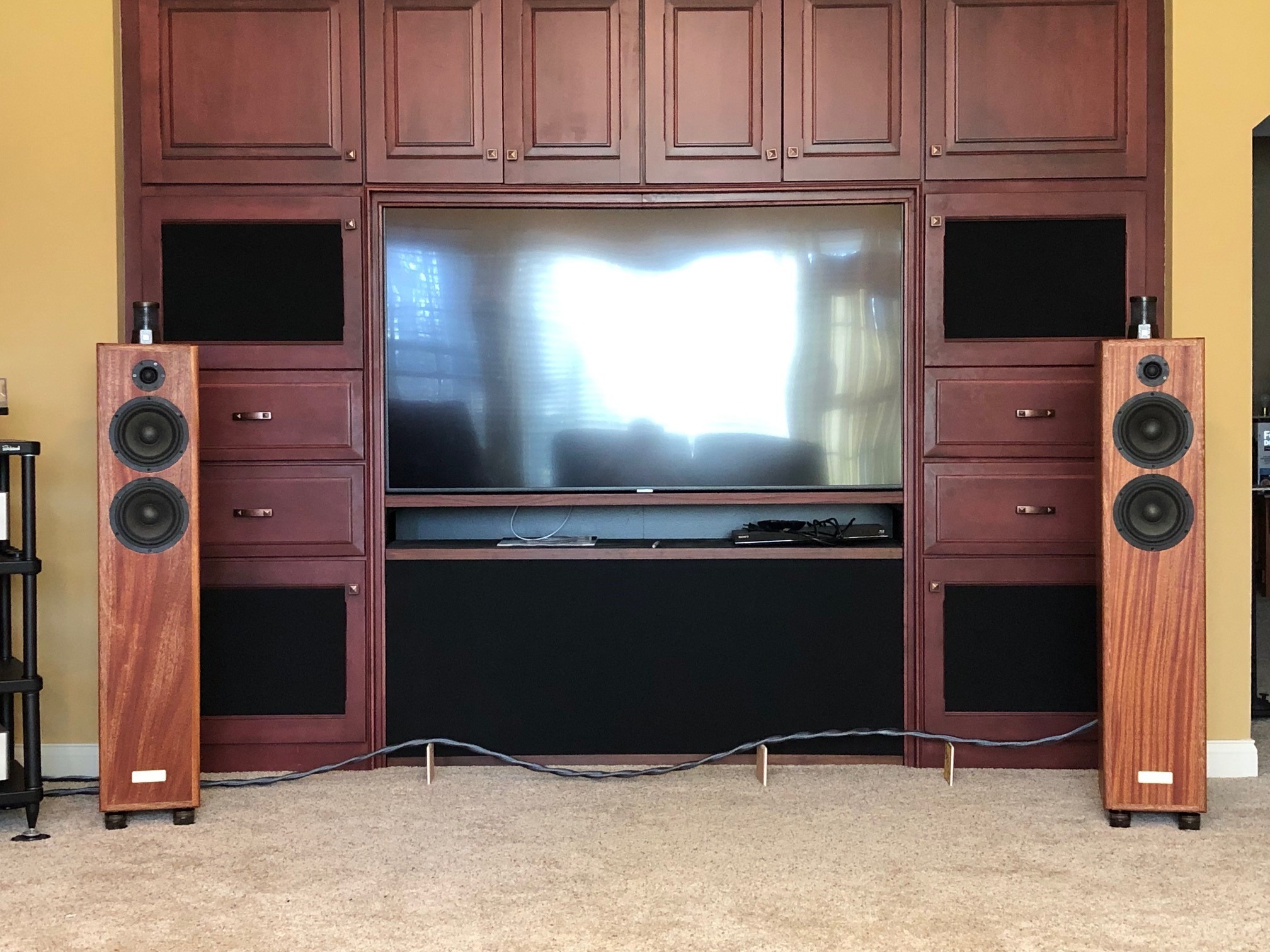

They've only been complete for about four days, but I'm very happy with the pristine, airy sound and precise imaging, together with an excellent low end. I’ve been enjoying high-end audio for nearly five decades, and these are the first speakers I’ve loved more than my original Martin Logan CLS electrostatics!

Nice job, they look fantastic. I like the box joints sides/top. Box joints are not easy with long panels, whether one uses a table saw or a router table.
