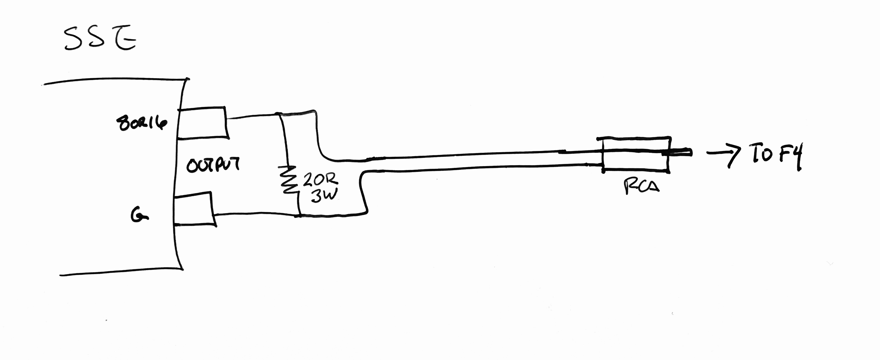

I am very curious about the Pass amps and would love to experience the F4 for myself. After reading up on the amp I see that flea watt tube amps can be used like a pre amp for the F4, a combination that is supposed to work well. I have Tubelab Simple SE. It is approx 6 - 8w depending on tubes. It has a volume pot but no rca line outputs, only speaker binding posts. The speakers that I use are Frugal horn MA 7.3.
Would my SSE be a suitable front end for F4.? If so how would i connect it to the F4? Would I need to connect an RCA line out to the output transformers output? I am using Hammond 1628sea as I am restricted to uk TX suppliers.

Yes, would work very well, those who have driven F4 with a small valve SE amp seem to be absolutely smitten and happy with the combination.
You’d need to make a cable with RCA on one end and wires on the other, and a 15 or 20 ohm 3W resistor. Connect the resistor across your SSE outputs and wire the RCA to it. Very simple.
Wow. Thanks for the quick reply. So have I understood correctly I could wire it to my speaker binding posts then (on the SSE). That is if I make up an arrangement for the resistors.
