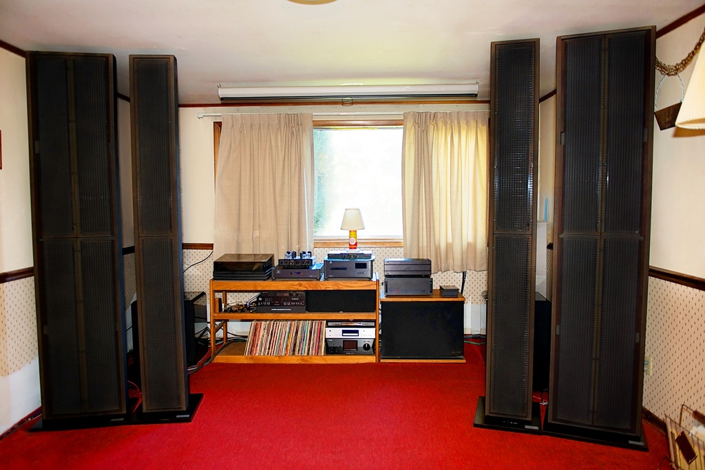

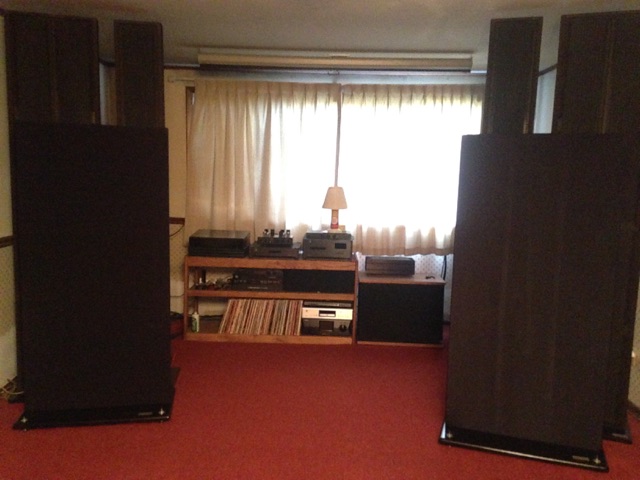

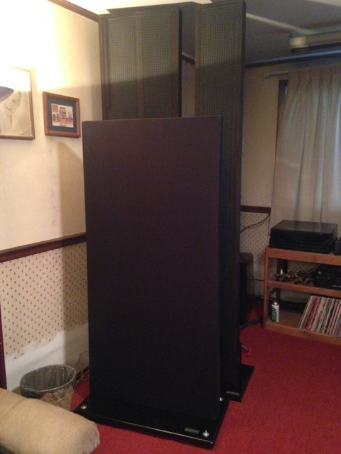

I have a similar set up
I am using model 3's with Red Medallion interfaces with a TNT 120 amplifier. Along with my model 3's I also have 1+1's and 2+2's in the same room. I use a pair of Jeff Rowland model 6's on the 2+2's. I use an Innersound 300 amp on the 1+1's. I usually have two pair of speakers playing simultaneously. The bass is staggering. Incredibly quick and deep. Once you take delivery of your model 3's could you please post some pictures of your Black Medallion interfaces. I'm not familiar with those. I'll share some pictures of my sound room. First I had the 1+1's and 2+2's then I found a pair of model 3's which originally had the non Medallion interfaces. I found a guy on line that allowed me to trade my non Medallions for his Red Medallion interfaces for $150 for the pair. I'm anxious to hear your comments once you get the speakers set up and dialed in. In my room the model 3's have even deeper bass then the 2+2's. I've tried all three amps with all three pair of speakers and like the arrangement that I have described above. You made a great purchase, at some point send the Interfaces to Roy. His upgrades and modifications are well worth the money, they will sound better then new.

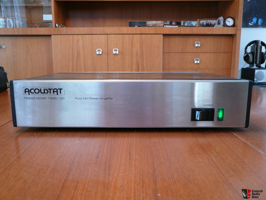

There is, imo, next to nothing to do to your Acoustat amp, unless there is something not working properly. Save ur money.

Regarding the amp, I thought the capacitors in the amps could gradually go out of spec, although I admit the whole system is sounding great to me. Do the amp's capacitors not go out of spec over a long period of time? It is a 30 year plus old amp.
Thanks for your thoughts. I set up the speakers at home and they sound beautiful, so in the short run I am more than happy.
In the long run, as I am not a DIY guy, do you feel that the services offered by Roy Esposito on the transformers will do what you recommend above?
In general, I am of the 'if it ain't broke, don't fix it' camp. If you are happy with the performance of your amplifier, leave it alone. Yes, capacitors do degrade over time, especially electrolytics, but you'll know if there's a problem.

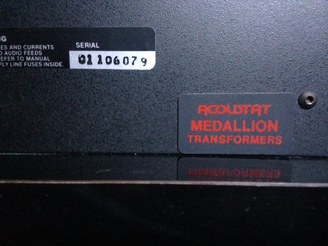

I am "the guy".
I already had a pair of Red Medallions, so I traded them. Glad you are enjoying them!
