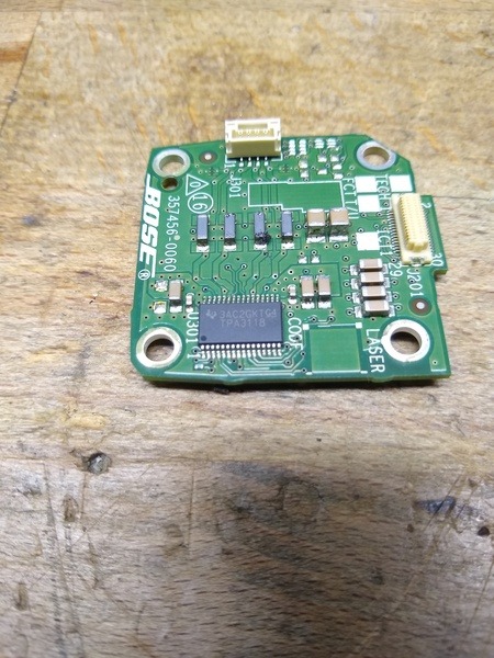

Designing my amps around TPA3118 since the beginning I am always curious to discover these in commercial applications. This one was inside the Bose Soundlink. It can be seen that the bean-counters replaced output inductors by ferrite beads here. Considering the short speaker cables and the metal housing this might comply with EMC regulations anyway.

I just found this thread when searching "TPA3118 Ferrite Bead". I stumbled across the Bose board a few weeks ago watching a repair video. Spotted the 3118 and was surprised to see that in there. I was however shocked to see no inductors and wondered how they did it. Then I now saw in the datasheet the allowance for ferrite beads.

In general ferrite beads are cheapest solution and only work fine with very short cabling like in boomboxes. They can not be compared to output filtering networks meant for EMI free HiFi. The loudspeaker cables may be perfect antennas and this both ways.
You can put a lot of time in ferrite beads but having good output filters is more worthwhile usually. That is why some projects used overdimensioned coils, film caps etc. Not cheap but good.
Some manufacturers have papers with detailed explanation and usually the "lowest cost" section is spent on beads.

Interesting and I guess that makes sense then for the Bose application (cable length is maybe 2" in that speaker). In my case, it may also make sense since I will likely use these boards to make powered speakers.
I've read (not in that TI thread but another) that if power gets too high, ferrite beads will not work. The TI commentator I linked to mentioned 8A rated beads. So unless my calculations are off, that means max output allowed (picking a 4 ohm load) would be , Pmax=I^2*R so:
Pmax=(8A max through inductor)^2*(4ohm load) = 256 watts
Which is way more than will be needed for this chip. Of course I may well be overlooking something.

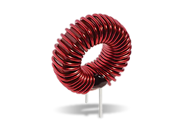

The only (non stock to the PCB) inductors I tested were 33uH and looked like this:
No idea if that's appropriate for Class D output filtering. It worked and didn't melt... ; ). The one I used was rated at 6A. Not sure how good or bad they sounded other than that I wasn't sold on them being an improvement.
