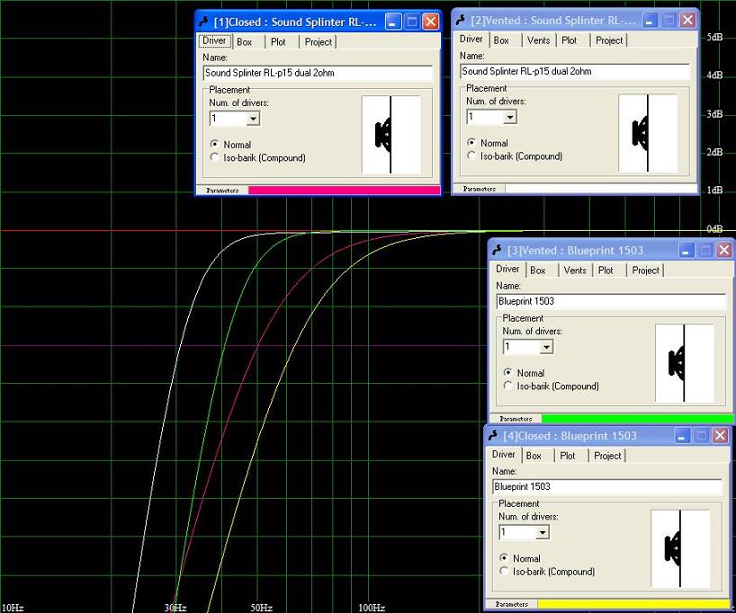

They say that what I am looking for is impossible because of physics... Which, I must agree to, really...
I want a small-to-mid sized box (less than 4 cubic feet) that has extremely low distortion, high SPL (at least 115dB sustained from 30Hz up) all the way to 20Hz (-10dB max at 20Hz anechoic, preferably no more than -5dB at 30Hz), has all the slam one wishes for HT (which my current sub does, but it is just too large), but plays ultra musically for classical music/soundtracks (my current sub is 'ok' here). Also, for occasional rock music, I need clean, distinct control so the quick kick drum beats are clean and clear (not exactly a strong suit of my current sub).
I think I can achieve most of this by using a PR sub. If I use two PR's with very high mass (thinking 1800 grams, which is nearly 5 pounds, IIRC) in a relatively small box (2.5-3.5 cu.ft.) with a suitably low-distortion, extremely high excursion sub driver, it should all work pretty well. The way I figure it, for classical music, the excursion will not be very long (except for low bassoon/string bass/tuba/etc. notes), so the cleanliness and detail should be there because the PR's won't lend much delay to the system because they will weigh too much to move unless the sub driver is really pushing some air. Maybe I am imagining this, though. Anyway, in theory, it also seems as though it will retain all of its depth and slam since I'll be able to dig deep while retaining good SPL down low.
I am just searching for that suitable, low-distortion, high-X-max driver. My current driver (Blueprint 1503, which has 26mm X-max) seems like it will work, but I don't have a lot of faith in it because of its supposed high inductance, which undoubtedly will affect the sound in the much smaller box that is tuned higher. Currently, in its 7 cu.ft enclosure tuned to 15-18 Hz (I forget which, really) it sounds quite clean, although still muddy on top with rock music, and a little too boomy/over exaggerated for classical music soundtracks. But, it has immense slam and goes really deep, making movie experiences amazing.
I bought a Behringer Feedback Destroyer, but I haven't had time to analyze my room yet (if I ever do get to it at all...). So, that is what I am looking for. In short, servo-performance for music, huge-sub performance for HT, all from one relatively small PR box. And, to top it off, I don't want to spend a lot (I could, but for some reason, I just have this feeling that subs should be cheaper and I feel cheated when I have to pay $600 for a driver, even a cool looking one).

Btw needtubes I modeled the 1503 in winisd, no wonder you dont like the musicality of it. The woofer rolls off really early, and the 16-18hz tuning with that box size produced a roller coaster FR and lots of group delay. Unless the new 1503's have different specs from yours, that would explain the muddiness.
I like how a sealed box seems to blend better with music, but sealed never works out for me for HT. I had my Blueprint sealed for a while, and while it sounded MUCH better for music, it was terrible for HT because there was no slam. Now, it is in a huge ported box, which is OK for music, and amazing for HT. I still haven't gotten exactly where I want to be...
I would really kind of like to go isobaric with two good, low-distortion, high-excursion drivers. If they were sensitive enough, I'd still get a good amount of SPL for movies and for showing off. But, most drivers cost so much that buying two would be a killer. And, I've been wanting a good plate amp that had auto-on and no fan noise (my power amp is great, but I hate the fan noise and having to open the closet door to turn it on). So, my cost would be enormous if I went isobaric with two high-end drivers and a high-power amp... For the price and amount of trouble, I could probably buy a Velodyne HGS. 😉
I definitely agree on the 1503... The model of it looks rather bad. Group delay is crazy down low, and it does roll off early. I have found several different versions of specs for the 1503. The ones from the Acoustic Visions website (at the time I bought mine about a year or two ago) were supposedly totally wrong and made the graphs look terrible. I have some DUMAX specs that are supposedly more correct, but who knows. The graphs using the DUMAX specs look slightly better, but not magnificent because the inductance is unknown. Some say the Le is 4, some 16... Either way, it messes with the frequency response and group delay.
