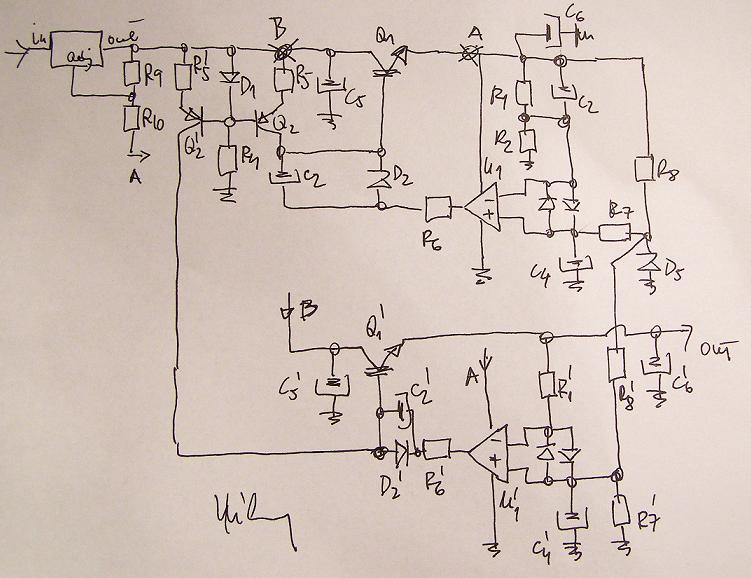

Hey guys, I was wondering if its possible to make the Jung super regulator work at 3.3 volts. I have been talking with someone about it who said he tried and was unable to make it load stable. He thought the problem might have been that he was using 12 volts, and thought it needed a minimum of 15 volts to work right. I didn't think that was so and was wondering if any of you might know why it didn't work, and what I might need to do in order to make it work, or if its even possible. If you haven't guessed, this is to power a DAC. Any help you can offer will be greatly appreciated.

mr.duck said:I don't think it will work because the LM329 voltage reference is 6.9v

Have a try by replacing the LM329 by TL431, TL431 is a high precision voltage reference. It can also trim to the desired voltage as U want.

I know that Walt has published 5V and 3.3V versions of his reg for digital circuits. IIRC he used a 2.5V precision ref. I guess you should check his website.

Perhaps this paper with a 5 V version is the one? Although he doesn't seem to say anything about other output voltages, he says the op amp works well down to 2.7 V.
http://waltjung.org/PDFs/Low_Noise_Power_for_Analog_Circuits.pdf

It should work if you would increase R3 to, lessee, I guess R3 = [2.5/(3.3-2.5)]*1k. And decrease R6 to keep the same bias current into the reference.

...and perhaps throw out one of the yellow diodes. The thing is way too bright anyways.😀
