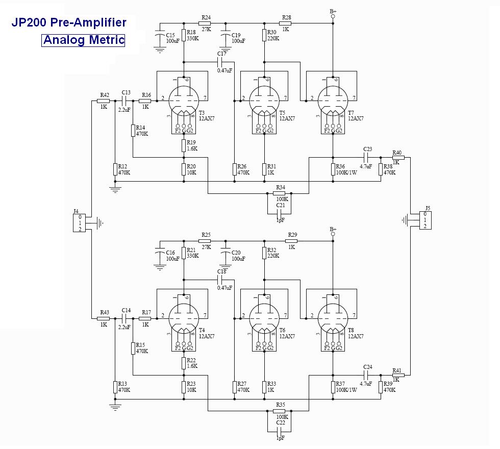

So one of his praises is the Jadis JP80 Preamp, and it appears the JP200 is very similar in design. As you can see (attached), it has six 12AX7 tubes. I could never find the schematic on the JP80, but the JP200 design has been published, and the PCB and kits seem ubiquitous on ebay.
Now I have always seen 12AX7 tubes in Phono preamps, where the gain is needed, but not so much in linestages. I don't know if I am "brainwashed" into believing the 12AX7 does not belong in a linestage?
Anyway, looking for some opinions on the circuit...I absolutely love my 6SN7 Aikido, but always look to someday building a JP200...
EDIT - It may be the case that the attached circuit is the Phono Stage of the preamp? This would actually make sense...

I think it's difficult to say without hearing one. Here, people who don't like the 12ax7 would say it's a bad idea and those who like that tube would say: go ahead and build it. Low current tube, not the ideal cathode follower but many line stages have been commercially built with that tube. Anyway, the JP200 cathode follower section uses 2 triodes in parallel. Looks OK to me.
It would but it isn't. On the bright side though, once you build it and get thoroughly disgusted with the sound it's very easy to turn it into a passable phono stage. 20 - 30 years ago there was some justification in building this but today there is simply no excuse. Apart from Mr Salvatore's and his associates warm endorsement.
It looks like a valve circuit designed by someone who would rather be using transistors, but had bought a lot of 12AX7 so had to use them up instead. I estimate open loop gain around 1500, which is then reduced to 11 by feedback (43dB of feedback). It has enough gain that it could be used as an active RIAA stage!
The 12AX7 is a good valve when used for its intended purpose: high gain voltage amp in high impedance circuit. It is wholly inappropriate to use it as a CF to drive an output, as it has very poor current driving capability. 12AT7 would be much better here, with R36 reduced in value.
It's pretty gawdawful all right. If I was going to design a glass op-amp, I'd use one 12AX7 as the input diff amp, then a VAS (cascode 6BQ7s, or a small signal pentode like the 6AU6, 6SJ7, 6CB6) then a Lo-Z output stage, such as a White CF.
I can't see using types like that as CFs either. The 12AT7 has better drive capability, and isn't all that far behind the 12AX7 for u-factor. It would still work quite well to make a SE glass op-amp.
As far as the JP200 kit. I have built one modified to use 12at7s as followers. I have to say I really like it. I know most people here are critical of circuit design in theory but I usually go by sound. Mine has a very wide sound stage, not as deep as some Mac stuff I've used, but when you here things 4 feet outside the speakers I consider that pretty good. I used Auricaps at first and liked them, tried the russian caps everyones talking about and like the way they sound but they add a little back ground noise. Little odd hisses and pops. I going to let them run a little longer to see if they wear in, in not then it's back to the auris. The overall presentation is definately dependent on the quality of the tubes. I ended up using 4 mullard AX7s and 2 tele AT7s. That was when everything really bloomed. She does take about a half hour to really hit her pace. If you build the kit don't skimp on quality components, they do make a difference. I modded mine to a circuit spec'd by a gentleman from germany. It's in the forum somewhere.

my experience with with tubes is that even the simplest topology given a very good power supply and a good operating point can really sound excellent.....
as i said before, i use 12ax7 exclusively for guitar amps.....the very high mu limits its usefulness in a line stage, unless lots of nfb are used to tame the gain....
for me 6DJ8, 6N1P, ECC88, 6H23 and 6H30 miniatures and 6sn7, 6H8C octals are the go to tubes for line amp duty....

Horrible circuit.
To much gain.
To little current.
Excessive feedback (with compensation for stability).
Three caps in the signal path.
Three gain stages - when one would do.
Bare cathode follower.
Horrible.
Forget this circuit and go to the proven Aikido.

The Chinese clone amplifier and preamplifier projects are far enough out of the originals. I have a friend who owns a jp200 and believe me there are no parallel tubes in it.Check the official site and discover the difference. Thre are 6 12AX& & 2 6922 as cathode followers.
