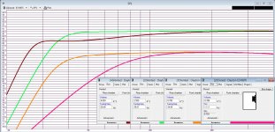

WinISD
Putting three Dayton ES180Ti woofers in one shared 2.5cuft ported volume creates QTc ~0.7 tuning with -F3 ~35Hz (Port Tuned to 35Hz == 4" diameter port, 8.1" long, flared at both ends) green
Putting three Dayton ES180Ti woofers in one shared 4cuft ported volume creates a modest -2db bass shelf with -F3 ~28Hz (Port Tuned to 28Hz == 4" diameter port, 7.8" long, flared at both ends) brown
single ported orange 0.78cuft -F3~35Hz port 2" diameter ~7.4" long
single sealed pink 0.36cuft Qt=0.7 -F3=67Hz
