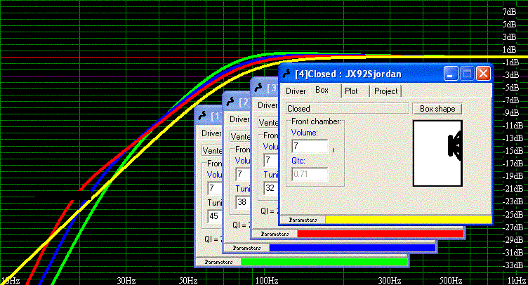

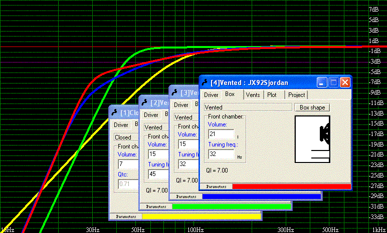

yeah... but im looking more for not specific enclosure designs, but recommended volume for sealed and BR and port dimensions for BR.
I can always throw together a baffle step filter... so thats not a problem.
Guess i am looking for a smaller enclosure that has reasonable bass response but has very good transient response.
So for sealed... qtc of 0.5

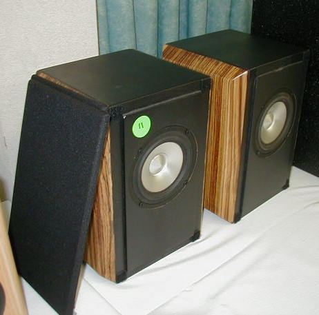

You've lost me. If you are willing to design/build a BSC circuit yourself, then if you look at the manufacturer's designs for box volume and port volume, you now have all the information to build it whatever shape you want. Or did I miss something?

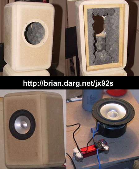

Looks like the port is in the back.
I didn't show the port on the back, but it uses the port shown below from parts express. The port length is equal to the exact length of the port without the sliding piece, and it doesn't need to be trimmed or anything.

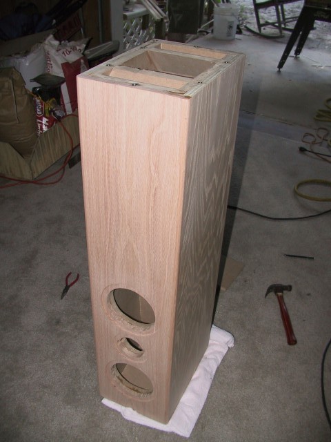

For my Seas Thor TL speakers, I did 3/4" mdf covered with 3/4" solid oak on the front, back and top, and 3/4" oak plywood on the sides.
