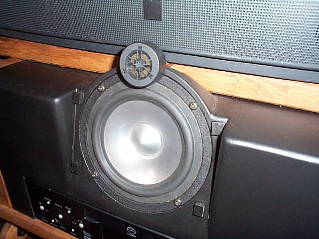

This week I listened to the Bower & Wilkins demo DVD “A Sound Experience”. Which you can get free if you listen to the new 800 series from B&W at your local dealer.
The DVD opens with a live concert from Peter Gabriel in Milano. On my Jordan JX92s center I can clearly hear the difference between the two microphones he use, one bad headset and one slightly better handheld microphone (they are probably from good quality but there is too much atmospheric interference). But his voice is coming right out of my center, it is like Peter’s throat is my Jordan. It’s like I am sitting in Milano myself!
Another piece on the same DVD is a song from Sarah K. Two Spanish guitars and female vocals. Strange mixed, the guitars are coming from the centerspeaker, the voice is coming from the front speakers.
On my Jordan you can exactly locate the guitars, in the middle of the center. The sound is crystal-clear with a nice deep bass. The vocals tough are coming from the middle but are not exact to locate, it’s an area from 30cm were Sarah K throat is somewhere. Sounds more diffuse comparing with the guitars.
My frontspeakers are much better than my center Jordan. As front I use the Italian Diapason which is a two way system, a wideband driver with a tweeter connected without any crossover and with the conemiddle only 10cm from each other. So from listening distance it is almost a point source. But the Jordan has something unique to offer as a center. It is a fullrange driver, it is a point source and can imitate the human voice and the reception of a microphone like no other system can.
The point source effect is what I like about using a full range driver like the JX92s as a center. But honestly the sound of the JX92s has also some bad sides.
-the high isn’t of the best quality
-the low isn’t of the best quality
-there is a lack of dynamics (it just isn’t fast enough).
So therefore here my comment on the suggested designs using the JX92s:
1 using a single Jordan, its ok. But then you have live with the limitations of the Jordan, which are the quality of the high and low region.
2 using the Jordan as a two way system with GS2i and a xo at 3K. I think this will make a fine monitor but even as a monitor it will not be my choice. Cutting of the high end from the Jordan seems a good idea but then I would use a wide band driver instead. This can deliver a much better quality of bass with more dynamics in the middle. As a center it is almost like a normal two-way system without using the advantages of a single full range driver as a point source.
3 using two Jordans and a GS2i in a ‘D Appolito configuration. Seems also a good idea. But a d’Appolito imitates a point source, a full range driver is a point source.
A d’Appolito always sounds a bit more diffuse. And I listened to many d’Appolito centers. My experience a d’Appolito vertical gives a better sound (less diffuse) than a d’Appolito horizontal but the source is further from your screen, and most of the times it does not fit in the interior design and in our image how a center must look like.
My recommendation
Use the full range of the JX92s. Place it as close as possible underneath your screen. Use a BSC to flavor the sound to your taste. And put a cherry on top with a tweeter, only to give something extra on the high end.
Please consider the design I described on this forum at http://www.diyaudio.com/forums/showthread/t-58565.html
I use a mini magnetostat, the Italian EB Cantare Super Slim supertweeter, which can deliver a fast high from 7k to 40k with a total flat curve. It is so small that it is possible to place it only 7cm from the conemiddle off the Jordan. The supertweeter is connected only with a 3,3µF cap. So no cutting off sound from the Jordan.
What you get is almost the full advantage of the full range driver, it gets a little more diffuse but it almost stays a point source. You can not compare it with a standard ‘d Appolito!
It is very important to place the tweeter as close as possible. I glued it on the edge of the Jordan. The tweeter is only 9mm thick and 33mm round. Only then no fase problems occur.
What I promise you is that you’ll be surprised about the realistic sound. Not only for voice but also for solo instruments like sax and guitar. It stays less suitable for piano because of the quality of the bass. Do not be afraid it will give you too much high or that it will be too sharp. Especially for S, F and T sounds it will not be more than without the supertweeter. Sharp S sounds are mostly because of bad recordings.
Adding a supertweeter will give you a much better quality of high, better understanding of vocals and even a more dynamic mid and bass.
The BSC I used is on the forum also but is now improved with help from my friend and forummember Soonqsc. You have to design one yourself for your own taste also depending on the type of housing. I also experimented with different caps for the tweeter but the 3,3 did it for me. It kicks in at about 14K so it will join the Jordan with the last half octave. It goes to 40K but that is total overshoot because there is no signal above 22K on DTS audio.
Do not understand me wrong I do not think a ‘d Appolito is a bad design. It is excellent if you need more volume because of your room size or if you like a better quality of sound because you like instruments like piano or alt sax.
I am just very enthusiast about this new possibility, so far I know this has never been done before with a JX92s. So consider it also because of the simplicity to build and cost.
But please do not cut off the Jordan it is a wonderful full range, what a waste!
I think I have got the most of the Jordan, it won’t go better. For me this is it! This is perfection.

I think a supertweeter is a wonderful asset to a fullrange driver. It gives sparkle and dynamics. So later on you can upgrade with a supertweeter. You will have fun for many years.
Ordering in outside Europe can be a problem try: http://www.lautsprechershop.de/hifi/index.htm I hope they deliver world wide.
I promise you will have the same experience I am having this week. Finally I have a DVD with an excellent quality (Peter Gabriel is highly recommended by others but I think there is too much disturbance from his microphone). I listened to a jazzy DVD from a female vocal singer “Trijntje Oosterhuis, a thousand days” it has a DTS 5.1 track and is recorded in a smaller setting.
What I am now experiencing is the feeling that the microphone is straight plugged in to my Jordan. The membrane of the Jordan is almost her vocal chord. I have never experienced this before and I have listened to many centerspeakers.
This effect is totally because it is a point source, and second because of the quality of the speaker.
Unfortunate it is impossible to listen to my configuration trough the internet. But others have. And I let them listen with or without supertweeter and BSC because I have made two switches in the circuit. Everyone agrees the tweeter adds sparkle and dynamics in it. The credit is not mine, the design is from a German magazine. I only did it with a JX92s.
About the high frequencies are out of range for the (damage) human ear. The strange thing is that even people who can not hear above 5k can clearly notice when you shut off a tweeter in loudspeaker even with a XO from 10K. A supertweeter adds, fore everyone! Its adds quality of sound.
So the choice is yours. I only can share my experience and I have never done this on the internet and I probably never will, I dislike a bit PC use. But this is one worth it to share.
