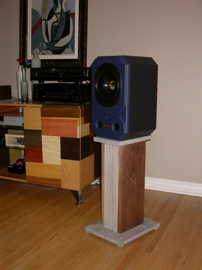

Hi All,
I'm thinking of building a Jordan JX92 bookshelf Transmission line speakers. I want them to go down to about 40Hz flat. Something similar to PMC TB2 (but single driver).
Can you help?
Either point me to already proven design, or let me know what tools can I use to help me design my own enclosure?
I am looking towards a bookshelf design due to rigidity of the cabinet, amount of material required and the fact that I already have made some nice stands that I would like to use.
Thanks in advance for your hepl.
P.S.
Here is a pic of my stands:

Bookshelf, TL, & 40 Hz just won't equate.... BrianGT posted a ML-TQWT design for the JX92... getting 40 Hz out of a JX92 at any level is something that just isn't doable.
