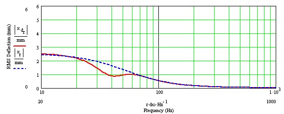

Whichever driver I end up with, my intention is to use them in a slim column MLTL design. Putting the Eikona parameters into the MJK ported worksheet shows very promising results with a cabinet 160 x 230 x 900mm (W x D x H). I have deliberately gone for a fairly modest LF extension (~ 42Hz -3dB) so as not to increase cone excursion too much.
I also plan to make them 'powered' (built-in power amps) so that the baffle step correction can be implemented actively at line level, and they can then be driven from a small unobtrusive preamp.

Ok but not sure about your rationale about higher tuning reducing excursion. Excursion is lowest at the tuning frequency and since it is more of an issue the lower the input frequency, the lower the tuning frequency the better with the constraints of useable response, (unless the room can't handle it of course). There is a handy calculator to show room response capability on web somewhere.
Hi Kevin,

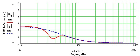

I have attached two slightly different port tuning responses in terms of cone excursion, by varying the port diameter. For the lowest tuning, the excursion 'bounces back' more as you go above the tuning frequency.
In effect, as the tuning frequency is lowered, the frequency range over which there is useful excursion reduction gets less. The region just above the tuning point where there is little excursion reduction broadens out.
The main benefit of a higher tuning is to reduce cone excursion in the octave above Fb. Since in most rock music etc., the LF energy is typically concentrated in the ~ 60Hz - 120Hz region, a 40Hz Fb for e.g. can place the greatest power demands slap bang in the middle of the region where the driver is already working hardest. Of course, the tradeoff is that you're unloading at a higher frequency. In some of my MLTL alignments, e.g. the pensils I did for the MA drivers and the box I did for the Eikona, I go for a modest Fb (high 50Hz regions) with a quasi pro-audio alignment, but use fairly extensive damping similar to that in a 'regular' TL, giving a fairly unreactive impedance load & linear driver excursion, which goes some way to compensating for this.

I can see from your graphs that in tuning lower you are actually providing a greater limit to excursion but over a less broad frequency range. Its swings and roundabouts. I would rather have the lower tuning frequency as long as you get a more extended flat frequency plot. Tuning should be for frequency extension, not excursion limitation. Yes most bass is in the higher region but then again problems with excusion become much more prominent with lower frequency so you need to cater for the lower end of the bass spectrum disproportionately and that is what your lower tuning does. If you want to be serious about limiting excursion then the best approach would be a high pass filter. If you are playing at such a volume that excursion is an issue at 40Hz then I can guarantee as soon as you hit some subsonic frequencies you will get some very nasty behaviour.

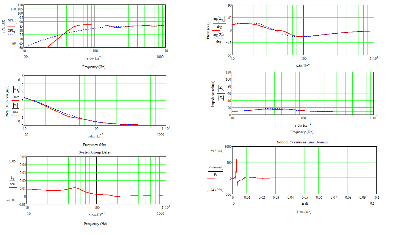

Not so. It depends on the specific design. Here's one I did when the Eikona specs. were first released. It's an alignment I like and regularly use; it's not tuned for maximum LF extension, but to provide a more broadband gain through the midbass, while the extensive damping provides a near-flat impedance load (and very linear driver deflection). Despite the higher than usual Fb, RMS driver excursion is still only 1.6mm at 30Hz.
Under the majority of practical conditions that a 5in wideband driver is likely to be used in, combined with the slight lift evidently built into the Eikona's anechoic FR, it should go a good way to compensating for step-loss.

I can see from your graphs that in tuning lower you are actually providing a greater limit to excursion but over a less broad frequency range. Its swings and roundabouts. I would rather have the lower tuning frequency as long as you get a more extended flat frequency plot. Tuning should be for frequency extension, not excursion limitation. Yes most bass is in the higher region but then again problems with excusion become much more prominent with lower frequency so you need to cater for the lower end of the bass spectrum disproportionately and that is what your lower tuning does....

The reason that the higher tuning frequency shows a less deep notch is that I applied a small amount of damping to the port to maintain an overall flat frequency response. 20% or the port length is damped at the same density as the rest of the cabinet, whereas the lower port tuning doesn't need any port damping.
I guess the tuning strategy depends on your taste in music. For me, it's mainly rock/blues, so most of the bass is in the 70-100Hz region. Therefore, reducing the excursion at a higher than normal frequency will be beneficial in reducing intermodulation, but I take your point that subsonic energy could cause a problem.
I have also tried putting the Eikona parameters into Martin's TL worksheet, but wasn't able to significantly broaden the excursion reduction bandwidth compared to an MLTL.
