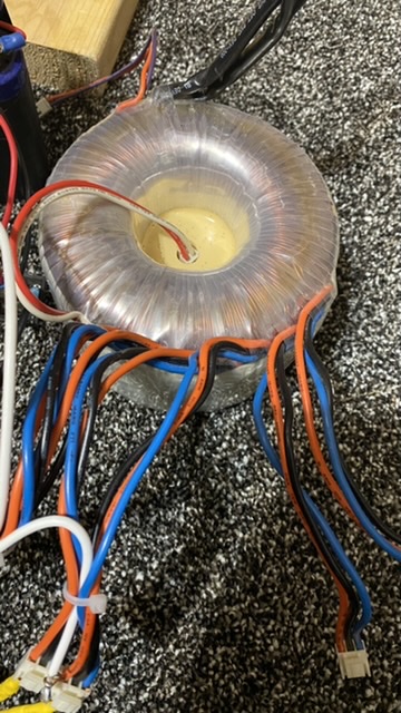

Hi guys apologies for the cruddy drawing. Can this work?
OK I know it works, I have tested it, but don't know about long term impacts. Its basically joining two secondary's in parallel isolated by a bridge rectifier.
Why? Because I have the parts for is and it can be used in a project.

How did you arrive at double output voltage ?
The secs in this drawing should have shown 64-0-64 not 32-0-32. My bad. The question was about connecting secs in parallel via a bridge to avoid exact matching the secondaries since any variations will cook the toroid. The joining "after" bridge gives me a 1.2v buffer for voltage variations on the secs (forward drop of the bridge is 1.2v)
In reality I have a Toroid with 12x 32v windings. (or 6 sets of 64vct)
After connecting each adjacent windings in series, I get 3 winding of 64-0-64. Which are not really usable. I will be wasting 1/3rd of the windings if I tried a dual mono config.
So I figure parallel 3 of those 64-0-64 to get a high current single supply of 64-0-64.
If there are other ways to get 90vdc from twelve 32vac secs, pls share.
The Twelve 32vac secs are in sets of 2 with center tap. So 6 sets of 64 VCT (32-0-32)

What you did is OK, the rectifier isolates the windings,
if one is 1V less all rising current will flow from the higher voltage until the DC resistance has lowered it by 1V and the second winding starts contributing as well. It is the same for the Xformer, the sum currents, losses, flux ...

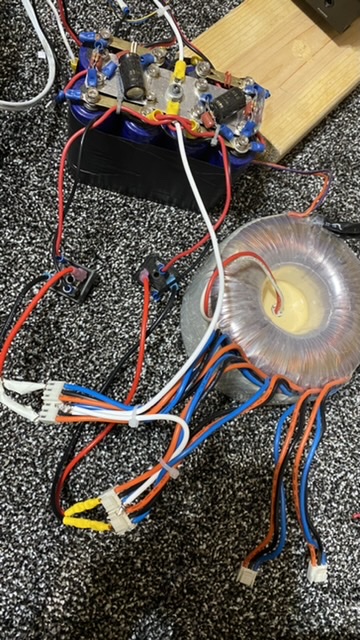

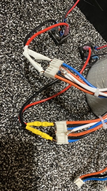

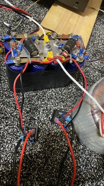

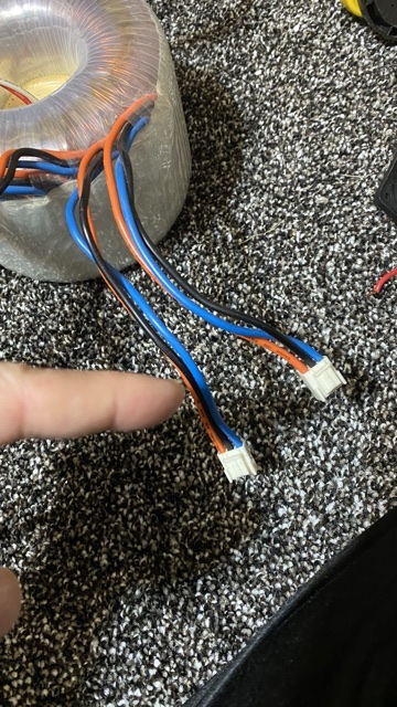

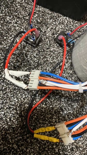

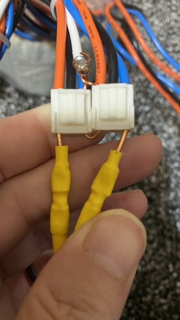

post a picture of the trafo
Here you go: each orange and blue wire is 64vct or 32-0-32 with black being ground.
To get 64-0-64 , I connected two sets in series. I ignored the black ground wire (not connected) and joined in series. The blue from one to the orange of other winding. This gave me my ground. The leftover orange and blue became 64-0-64. But this is not my question.
Its, can I parallel two ( or three) of these 64-0-64 groups together (via bridge recifier to single capacitor bank)
I know it works in concept. Already mocked it....
